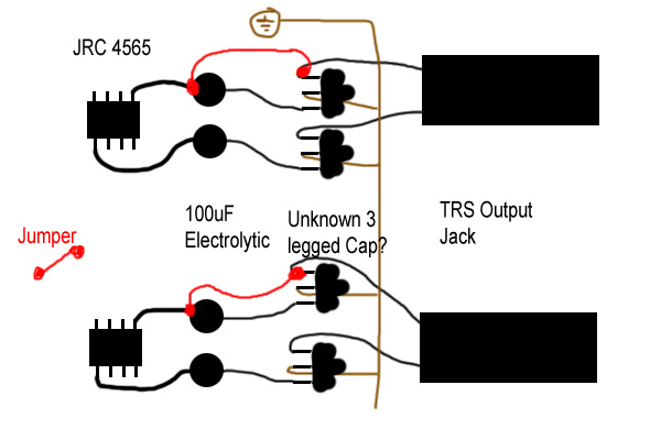

no ideas? If I provided a small schematic of the output stage could someone give me some tips on what I could do with it? Thanks.
Maybe someone can help me with this:
The coupling cap for the opamp is 100uF electrolytic , followed by what appears to be a small 3 legged cap of unknown size. I can't make out what it says on the side, but it is small and orange/pinkish and is sort of shaped like an upside down version of this:
v\/v
I am presently using a jumper to bypass the coupling cap and whatever else that other thing is on one of the differential pairs on each channel. One side of each signal (of the differential output) has a good bit of DC, but the other doesn't seem to have any so I have the jumper on the the side of the signal with no dc and simply connect them. The output no longer measures and DC. I've done a quick signal check and there doesn't seem to be any detriment.
Any suggestions for the optimal output? Thanks to anyone who helps 😀

Since its a voltage output DAC, you have choices.
My first Idea is a 10K 1:1 transformer, with or without a load resistor.
Second thought, a Broskie Cathode Follower, if Tubes float your boat. http://tubecad.com/Product_PDFs/BCF 9-Pin.pdf
While I couldn't tell you how, a discrete FET version should be straightforward.
Just Random thoughts.

Billy,
This is a differential voltage output DAC with offset voltage of 2.7V. You do need the opamp, it does balanced/unbalanced with some gain. You can try a better opamp on a socket or a transformer. The 3-leg component is probably a muting transistor (Motorola?). You can also improve the stuff by replacing the output capacitor. A 10uF/63V polystyrene might be sufficient, like WIMA MKS-4 or better. In theory there should not be any DC voltage at the output of the opamp, but there is due to component tolerances. The capacitor is there just in case. Don't expect too much improvement, though, as long as you leave the power supply as is. I think there is a synergy in such devices. I mean if they use JRC4565, the regulators are very likely 78xx.

I vote for the transformer coupled output. It's simple and sounds very good. You can spend anywhere from $22 to $1200 for a pair of transformers.
(hint: the $22 pair will get you 90% of the way there)
If you are interested in experimenting in transformer coupling, look at Edcor to try it out. I would look at EDCOR - WSM10K/10K

Thanks for the replies,
oshifis- I figured out what the 3 legged component was, its a t-network capacitor. http://www.rapidonline.com/netalogue/specs/26-6122e.pdf and it looks like the one on the left in this picture: http://www.binbin.net/photos/murata/270/270pf-100v-t-network-capacitor-rc.jpg

Yes, you can attach the transformer primaries directly to the transformer, as long as the voltage on both is roughly the same. In your application, I would not ground the center tap.Would I be able to directly connect the transformers to the dac outputs

How about adding servos to null out the DC offset? Take a look at Walt Jung's audio opamp articles.

As long as you do not DC ground the center tap on the input side, the 2.7 volts will not cause a current and everything will work.Before I commit to this experiment, I want to be sure that there won't be a problem with the output levels going on. Attached is a diagram from the datasheet of the dac that shows the output levels. There is a 2.7v offset. With that issue, can I still use the transformers directly connected to it because the offset is identical and thus the transformer would effectively block the DC? Or does this mean that I need to correct the 2.7v offset first before I can use a transformer?
Transformers do not have an impedance. On a 1:1 transformer, it reflects the output Z of the Dac, and reflects the load resistor.So from that I know that I need a relatively high impedance input for the transformer, which is why the 10k input was suggested. Now the part I'm concerned about is that in the suggested 10k:10k. The second 10k listed is the load impedance correct? Does that mean that the output impedance is 10k and thus I would need a 100k input impedance on the receiving device, or does it simply mean that it expects a 10k or greater input impedance for that other device?
I like to think of it this way, the output Z of the drivers should be less than 10K and the next stage should be 10K or higher.
