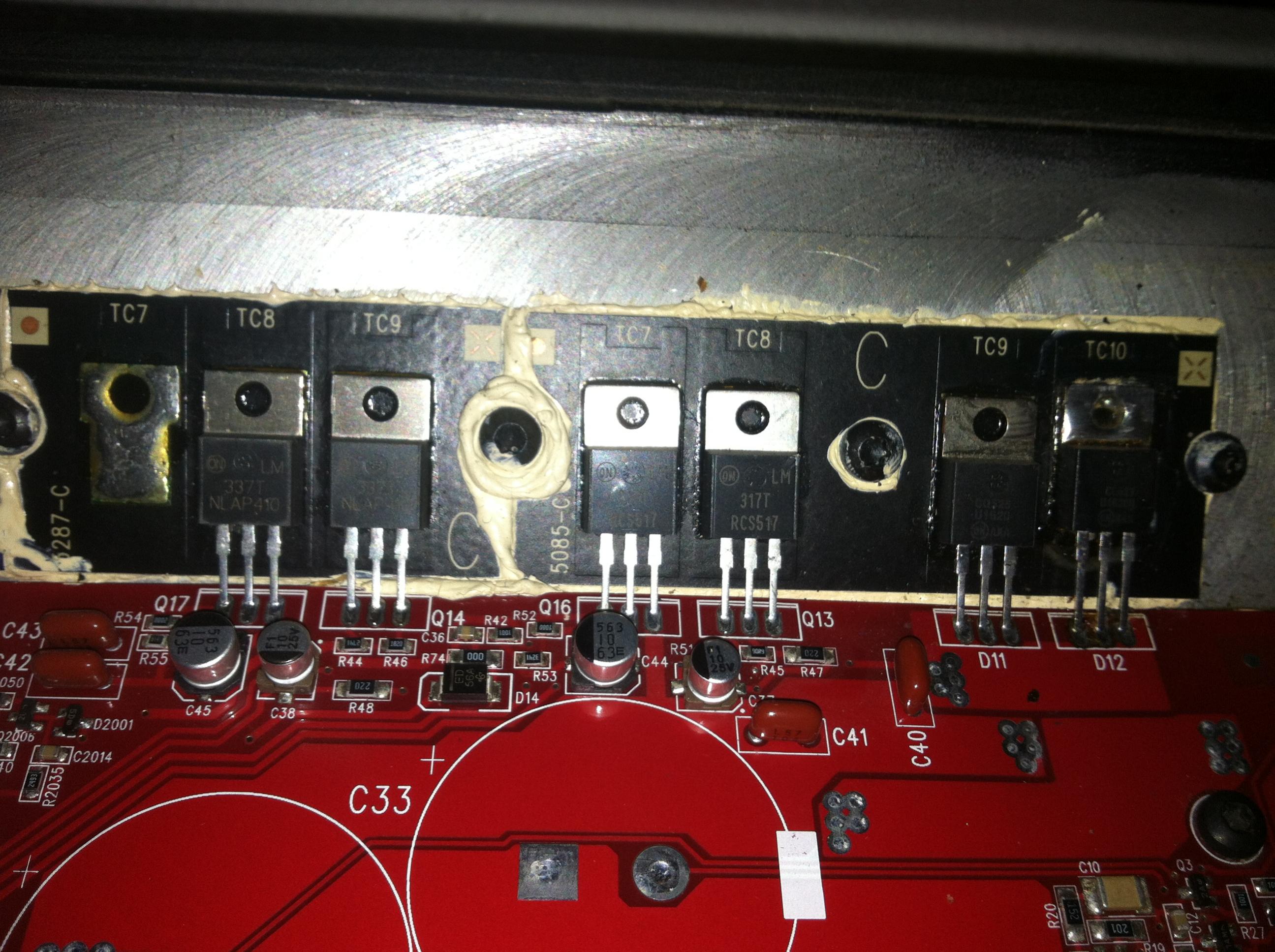

Ok just took the amplifier apart and power it up it goes right into protection mode, Little history I strongly believe the speaker wires touched and caused this but I not 100% sure . Also the amplifier to me looks good (internals that is) but Im no expert as you could see 😕
Please let me know if you guide me in fixing this 😀
IMG_20161.jpg Photo by jrplz | Photobucket
This one looks funny to me ^

check the finals and power fets.some of them might be failed..
Ok i will do that first thing in the morning it newborn time 🙂

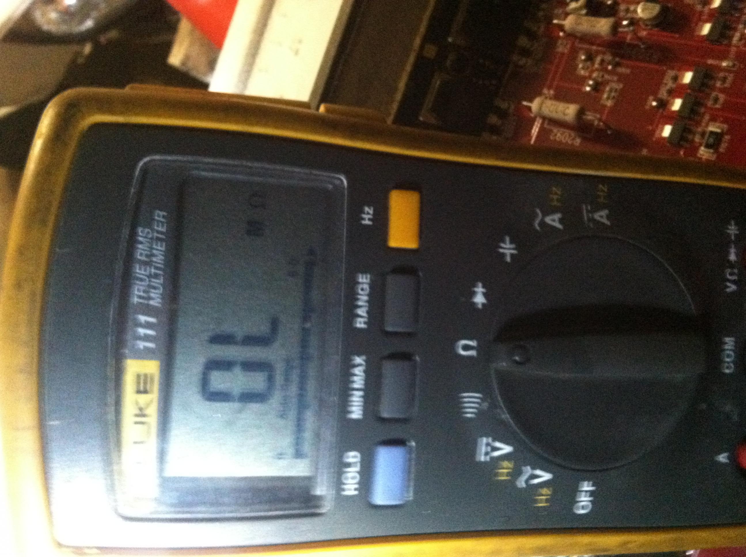

Ok guy first please excuse my ignorance Im just going from what I seen on you tube
on the board starting of as fallows
tc8 / Q17 = 199.8
tc9 / Q14 = 181.9
tc7 / Q16 = keep on reading high no stoping
tc8 / Q13 = 5.236
tc9 / D11 = 0.4
tc10 / D12 = 0.4
I read them on the outer legs with OHM with a fluke digital meter , Again please excuse my not knowing !

LM317 and LM337 are a regulators..i'm not sure but Q16 might be failed..i have LM317.i'll check the resistance and let you know tomorrow
