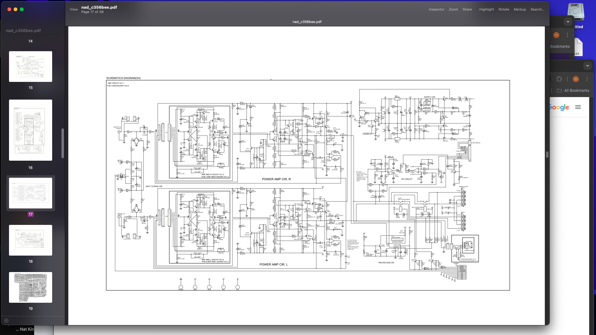

We'd need a schematic first to advise on whether replacing the component is possible or advised.
Also, "NPN" is the gender of the device. NPN is a N-Channel transistor. The J112 to asked about a is N-Channel transistor. I suspect you are asking about replacing a BJT N-Channel device with a JFET N-Channel device. We'd need to see a schematic to confirm.

This is a rather complex circuit and would not be amenable to substituting a different type of device,
or even just a different BJT, without careful consideration and redesign. I would recommend against it.

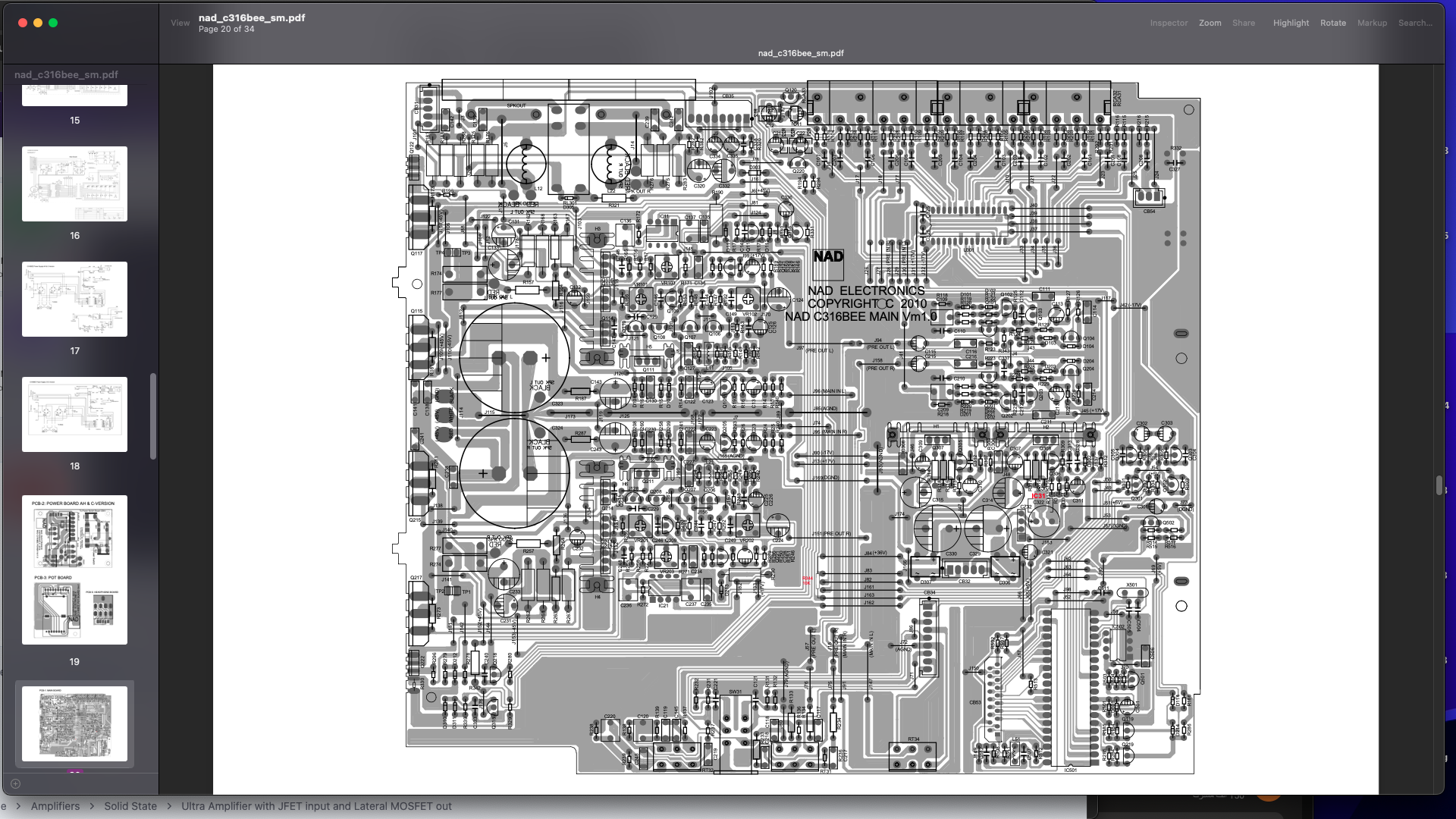

The schematic is still needed. This will identify the reference number of the device to be replaced. This can then be identified on the PCB.

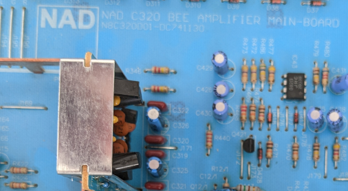

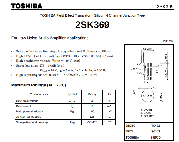

FYI, I have the 320BEE. It has 2SK369 which is JFET in the part list. It is not on the main board, it is on a mini board which "stands up" on the mainboard.. image added here.Hello, I am new to the forum. I would like to upgrade my amplifier nad c316bee . An engineer advised me to changing the input buffer input transistors from NPN to a J-Fet (J112 or 2SK246). Is there a noticeable difference? Where is it located on the board?

Only input transistors for buffer NPN TO JFET J112FYI, I have the 320BEE. It has 2SK369 which is JFET in the part list. It is not on the main board, it is on a mini board which "stands up" on the mainboard.. image added here.
