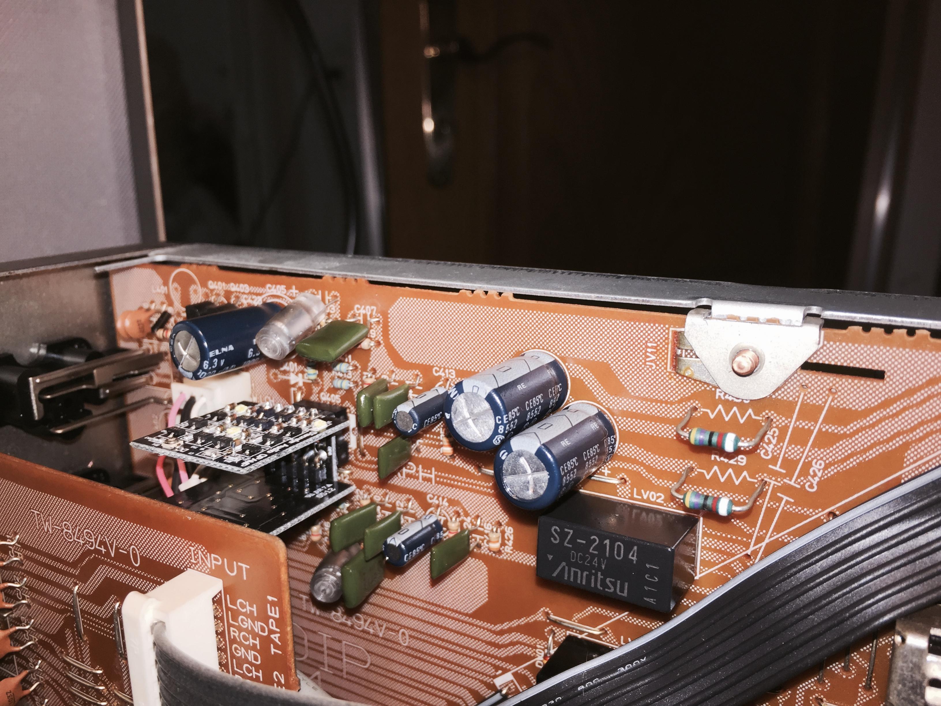

OK, I jumped and did it.
Luckily the unsoldering of the existing IC was not a big issue as I could nearly reach all pins from behind with the un-soldering pump.
Once the dip socket was installed I almost blew it 😀 by installing the IC the wrong way around but turned the amp off as soon as I saw some smoke on R429 (on the right of the picture).
Anyway, hoping I have not created an issue further on, I first put back correctly the original opamp and it worked (I think left channel took 10 seconds to go back on).
Then started rolling opamps. Tried the OPA627 (two singles mounted on adapter) and it was definitely less tiny than the original one. Then tried the Burson opamp and indeed as Dennis from Burson Audio support had indeed indicated it did not run because of power requirement.
Finally I had one ClassD Danish discrete opamp in my draw and it was a revelation. Sound was warm and full. We will be able to make more tests this weekend with the speakers (Mission M35i) as my daughter will finish her exams and get her combined birthday/exams gift 😉
Probably the opamp selection will also depend on the catridge used (Grado in this case), I think it is good to have the choice to easily try different combinations of cartridge/opamp.
Thank you all for your support. This forum is absolutely fantastic and I look forward to sharing more project and learning from the experts.
Best wishes.
Here is a picture of the board after the upgrade:
