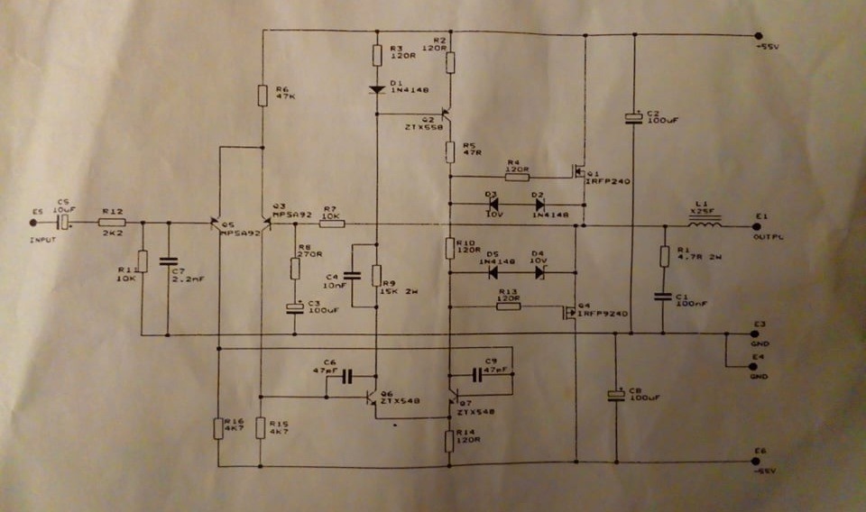

Hi guys,
I built this simple power amp, 125w, first upgrades were changing the cheapy caps for Elna Silmic II, better power caps, hardwired input and output, hardwired dac everything is direct.
Now the only things I can think of trying next is an oversized transformer and increasing the rating of the power caps and using Mundorf M Lytic.
Can anyone suggest some other upgrades to these two modules, I cut out and bypassed the output coil but this is an older photo. The amp sounds stunning, just needs a bit more bass and low mid-range.
Thank you!

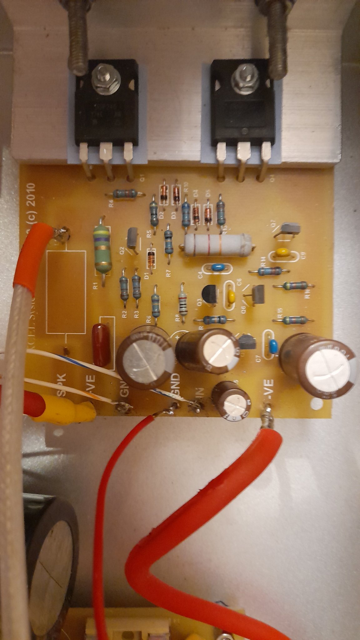

So going ahead and building a new power supply board with Mundorf mlytic and putting in a bigger power transformer as someone recommended on another thread.
Here's a better pic of the power amp. Anyone have any suggestions for upgrades to the amp modules?

So those are known as vertical mosfets.
I know that circuit was made with the older lateral mosfets at one time. I have no experience with the type you have, so can’t add anything.
Something you can do to help the power supply is to use what’s called a snubber circuit on the rectifier bridge. It reduces the shot noise from the power supply diodes switching action from then interacting with the inductance of the transformer.
And this is just assuming you have a linear power supply with those components…
Can search for “snubber” for more info.
There are some great discussions on optimization using testing, however, I have found that the values of .01uf, and .1uf + 18ohms works quite well.
