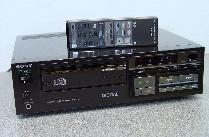

CDP101 Mods
I would like to share my simple but effective mods in my SONY CDP101.
Like any "old"piece of gear it needed cleaning in the inside and outside to bring it back to life. Inside it is good to replace the old silicone paste used between the power transistors that are used as voltage regulators and the heat sink. In this particular model Sony added a huge heat sink to lower the temperature. It does get warm. The next thing i did was to change the output buffer opamps original NE5532 to hi-end quality LME49720. Believe me the sound gets so clean detailed and these new opamps need at least 100 hours of break in to sound best.The (schematics) circuit have a good thing that when you change the opamps you have a trim pot to set the DC offset voltage to zero. Find this solution in today's CD's player. Just like the dc offset voltage in amplifiers has to be close to zero if possible to get the best performance. I could have tried the BURSON opamp but unfortunetly this sony is packed and not enough room to fit it in. It could be done but i did not what to get into that hassle. Next was the clock i used ELSO KWAK clock because you can use the original xo from the PCB. This unit uses a rare freq exactly 8.600 so Kwakclock was used for that with the original xo.
With the clock in place it further enhanced the sound and overall performance. I have an oscilloscope so i performed the laser check and gain / focus according to the service manual and guess what after 25 years it was minimal adjusted. Practically i have just redone the focus part but very little had to be corrected. It reads all cd's that i put in. I play only genuine disc's so i do not know if it would play CDR /CDRW.
The mechanical draw and and other moving parts were lubricated for smooth operation. Some drwas get stuck because of dirt nad old grease.
The one i got of eBay was of that nature and sold as a defective CD.
To my surprise all it needed is a good cleaning and simple mods.
the historic machine is reborn and mapping floors with CD player that cost ten times more.
If you want the service manual i can supply it for free just email me
enjoy the music.
