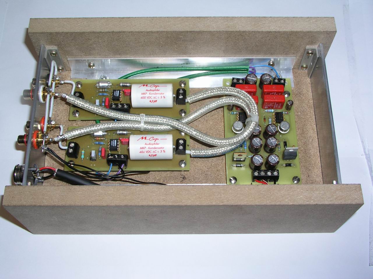

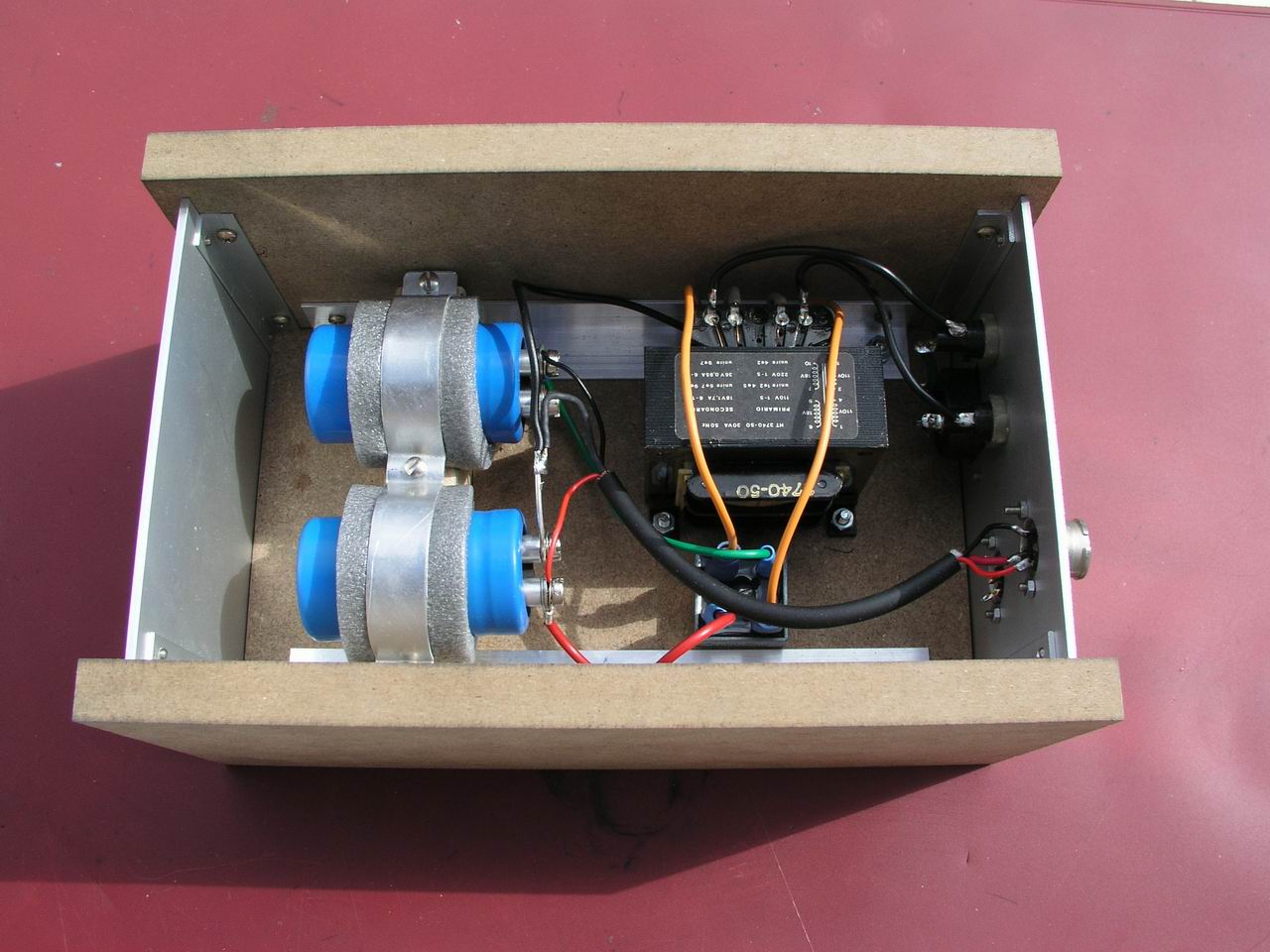

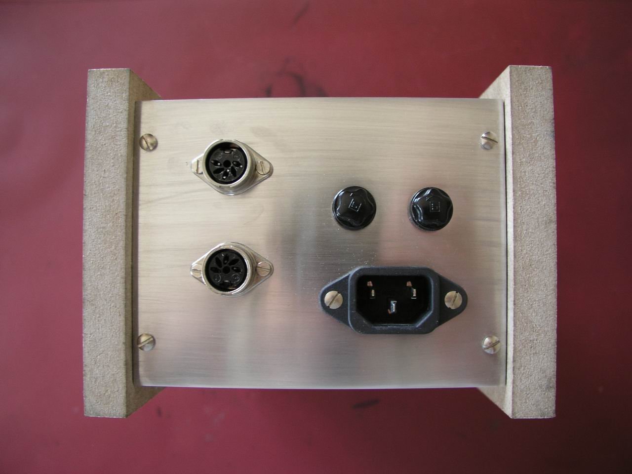

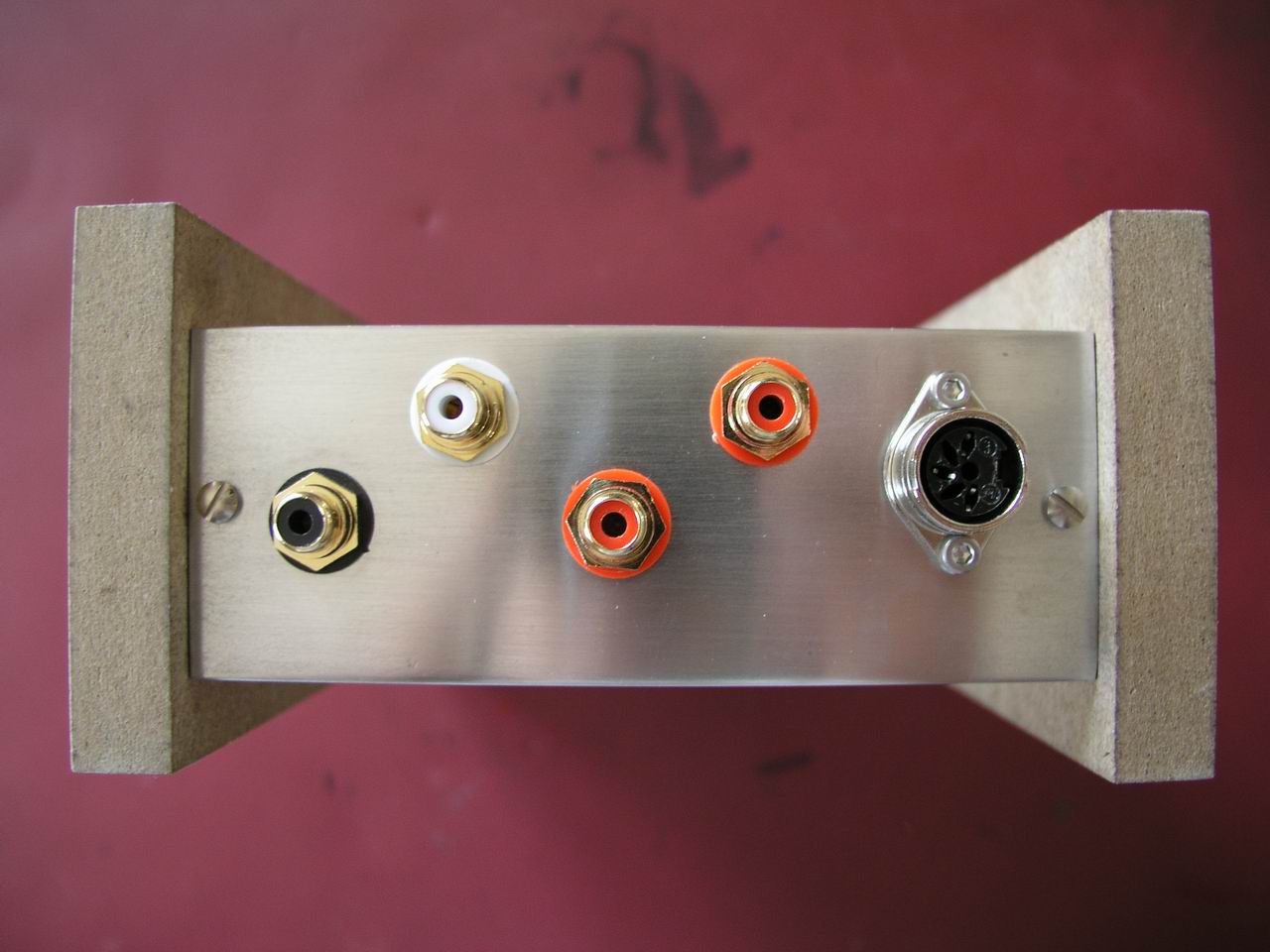

I have an old Dual 1214 TT and I have made some improvement to it.
The first step was to remove the original cartridge and replacing it with a brand new AT95E (I buy it via ebay.de for 26€ with all fee).
The Audio Technica AT95E is working very nice. This is a very good cartridge for less money.
The second step is to build a new enclosure and after that I will maybe replace the old monoplane motor (it makes some noise) with new one.
Recently I build a RIAA amp for my Dual TT. This preamp is easy to build and it's nice copy from a Grado PH1:
http://alexkachler.free.fr/riaa/
The only change between my version and the original Grado version is the AOP. I can't find some NJM4556, so I replace it with a nice APO2604.
Some pics:
The total cost of the PH1 like is less than 90€ for the RIAA preamp and the PSU.
So good luck for your improvement!
Alex
