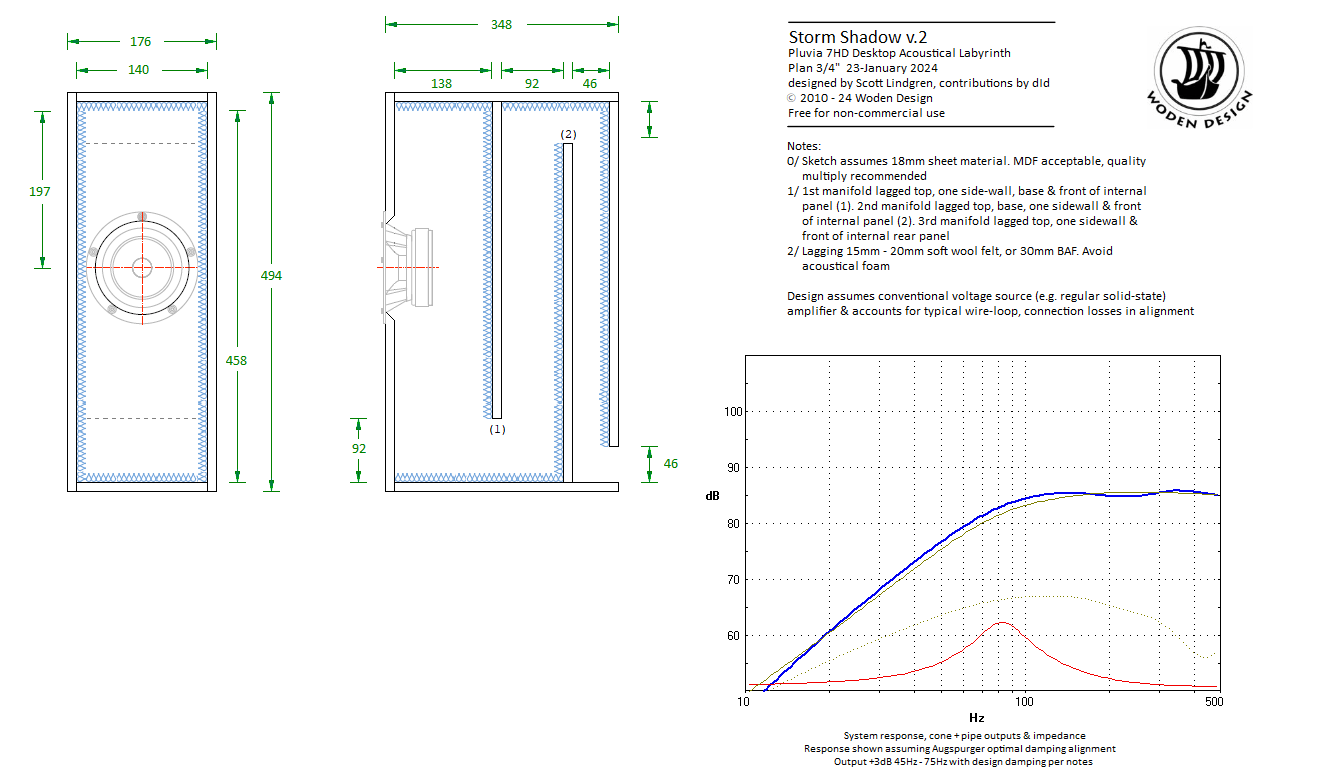

Updated Storm Shadow for Pluvia 7.2
Before Christmas, there was talk of a possible updated Storm Shadow for the Pluvia 7.2
I don't like to ask for updates for free work, but I need to decide to move on to something else.
I've really enjoyed my Lance speakers but want to get into a little bigger driver/enclosure and after 5 years, just ready for something different.
I don't think the FF105wk will be enough of an upgrade, more a side grade for going only a little lower, and my budget reaches above the CHN-70 but I'm open to hearing the opinion on the Skyflash as a bigger brother to the Lance.
Side note: I tried some fairly expensive powered 2-way speakers. For my use case, close and low volume, I'm sold on the advantages of full range.
For answers to questions, see attached. 😉
