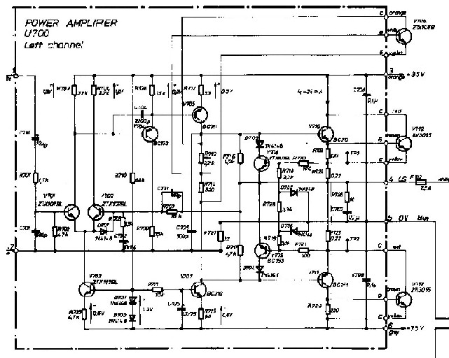

Hi Guys,
Here's the improvements I'm thinking of:
Replace Output transistors, electro & tantalum caps,
Remove protection circuitry,
ac bypass bias chain with a cap, 47uF?
Some Q's: Is the diode on the - input of the LTP necessary?
Are all the HF roll-off caps necessary? or is this symptomatic of dodgy layout? (C704 at 2200pf seems high?)
Any other suggestions, or should I forget it and use the case/ps/heatsinks for something more modern?
Thanks,
Pete McK

Pete,
I have an R4000-3. I was never reallly happy with the sound of it.
The preamp sounded a bit dull and the poweramp sounded, I don't know....brittle. And no, the combination did not complement
one another.
All I did to it was to upgrade the caps in the PS and put some local
decoupling on each poweramp. And changed the wiring from the
PS to the power sections.
I don't think youd benefit much from modifications.
Just keep it for the really cool design, that's what I did.
/ Mattias
Hi Mattias,
The preamp in mine is stuffed, but I'm not going to use it anyway;
I wired inputs straight into the main amps, and they work fine, and have more than enough power for me (enough to fill the back yard & annoy the neighbours 🙂. They do have a bit of an edgy sound though.
I'm only going to use them for driving woofers (< 250Hz), so I think they'll be OK as is.
Pete McK
