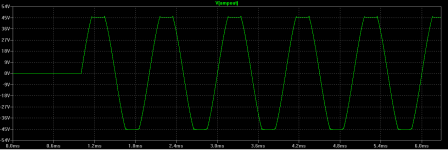

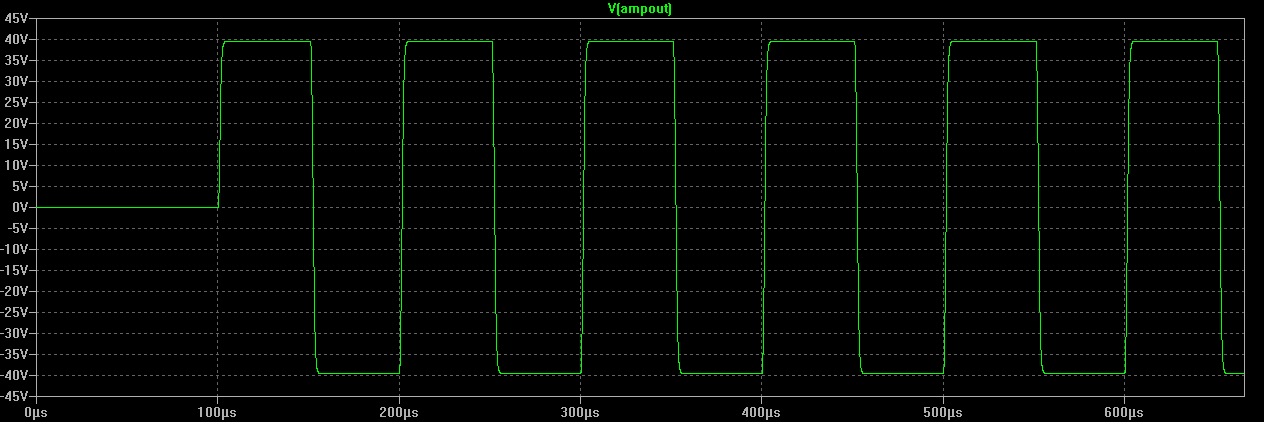

Speaking of distortion - simulated THD1K is below 0.0001%, and THD20K is about 0.001%. THD isn't the only thing that matters, so why go to such extremes? Well, because I can. I know that in real life the transistors and parts won't be perfectly matched the way they are in simulation, but if the design is inherently low distortion, even if i give up an order of magnitude to the realities of the real world I'll still have an outstandingly low distortion amplifier.

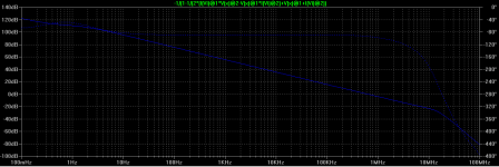

The compensation is really simple - just a 39pF cap on both sides of the VAS. I tried many different schemes in an attempt to keep the open loop gain up at 20K, but couldn't make any of them stable. I am leaving some stuff options in the pcb design to experiment with.

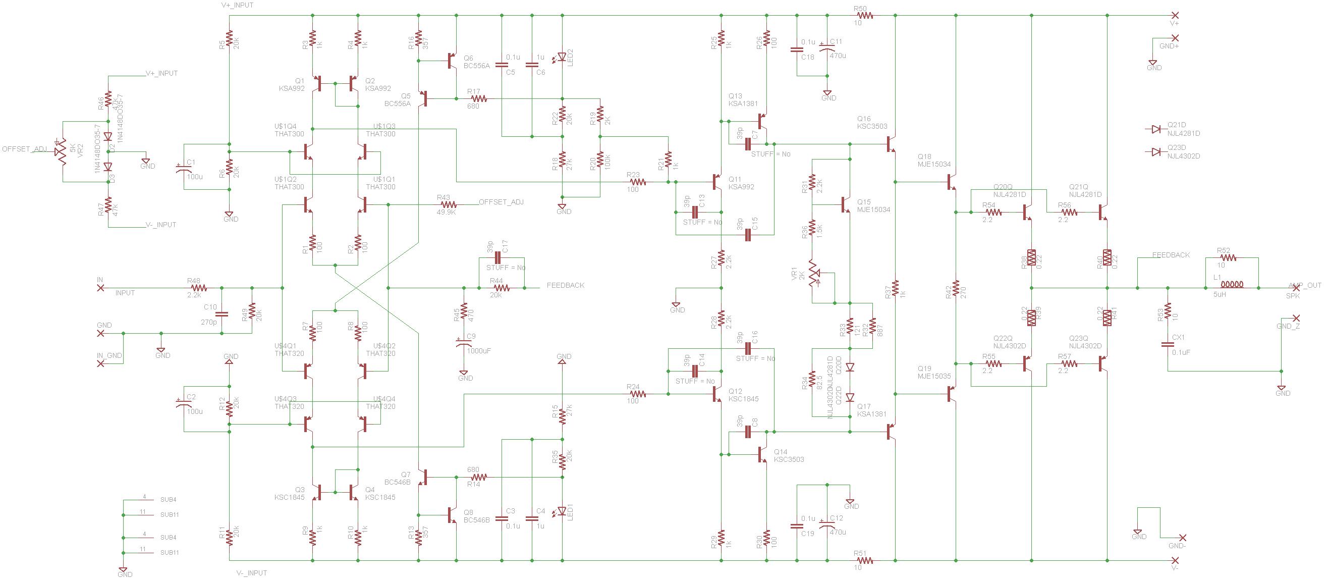

Enough for now - here's the schematic. Thoughts and comments? I'll post some simulation results tomorrow.

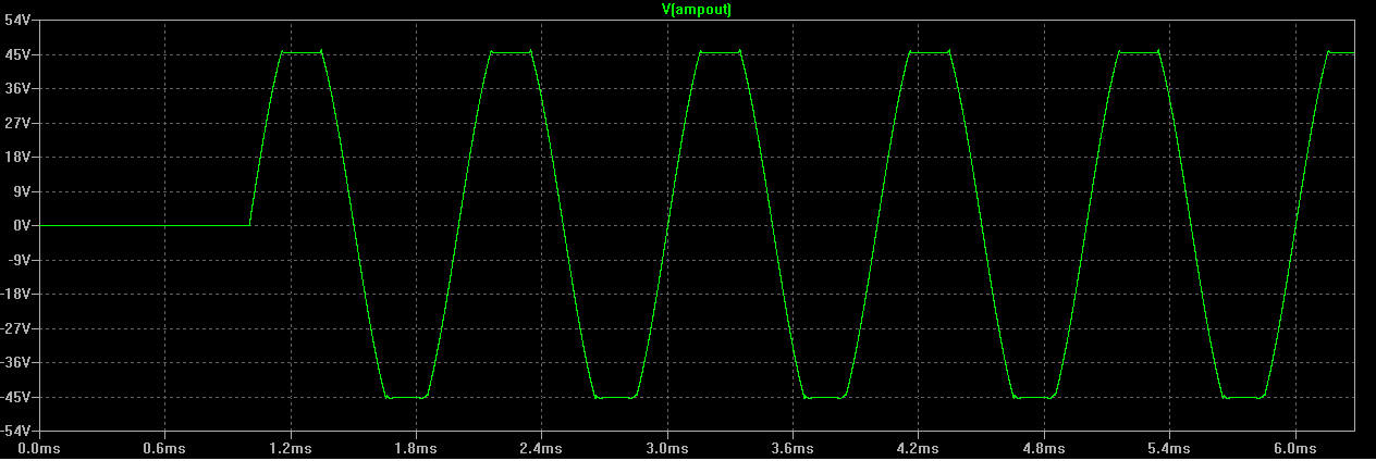

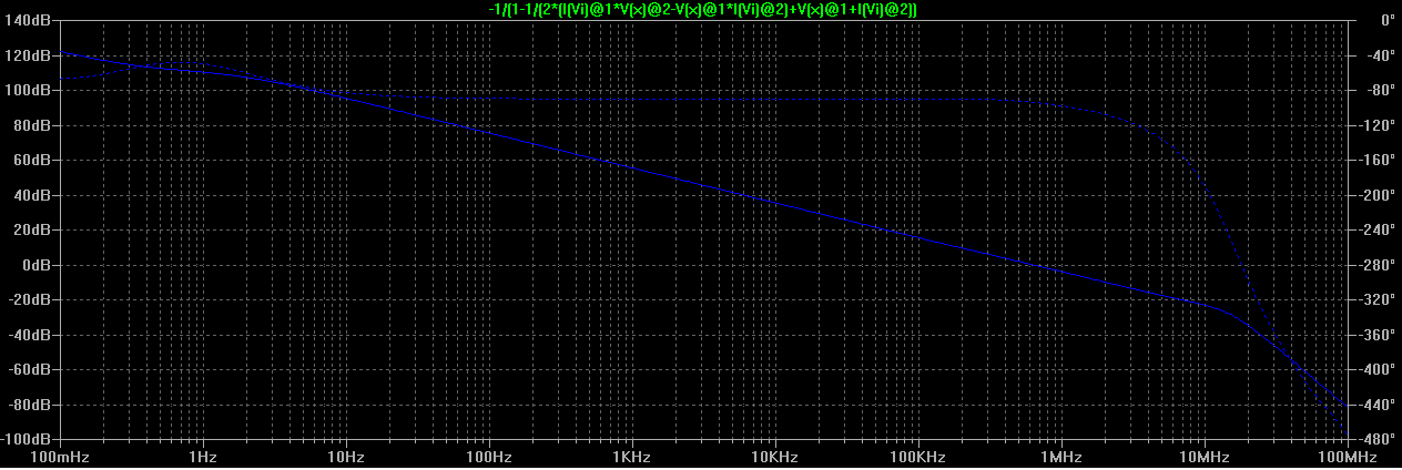

Here is a plot of the open loop gain. Plenty of gain/phase margin, 0dB gain at about 630Khz.
I experimented with various ways to make the gain roll off start at a higher frequency, but couldn't make any of them stable.

mightydub:
looks interesting ... thanks for sharing. a few questions now, maybe more later:
1. why use the expensive matched devices for input device cascodes? i would think they'd be better used as current mirrors (if they have the ratings). i think(?) that that makes quads with pairs of opposite polarity.
2. looks like your closed loop gain is roughly twice what i normally see for power amps. is that on purpose? just curious why ...
3. i would be surprised if you don't end up needing some small resistors in the bases of the outputs and/or drivers.
4. what color are your leds? 🙂 looks like 10mA in the VASs. i like those fairchild parts. i might go for 15 or maybe 20mA, but, hmmm ... you are using an output triple.
5. how hot are you idling the outputs?
keep posting your progress. i'm curious to know how close the end product matches the sims. and if you like the end result better than the original. have fun!
mlloyd1
mlloyd1,
thanks for the questions!
I experimented with a few different configurations, this one (LTP and cascodes all identical, and in the same package) had lowest THD. I agree with you, it would seem to make sense using the THAT devices for the current mirrors, but that gives roughly 8x the distortion. I'm not sure why the KSA992 and KsC1845 do so much better there, the THAT parts seem to do best with a higher Vce.
Also I found that best performance was with about 1.9mA through each of the LTPs - much lower than with other transistors.
I'm aiming for close to full power at 1V pp input. Am I mistaken here? What is generally considered the maximum input swing? Easy to change.
I have thought about that. Doesn't seem to be necessary so far as I can tell from simulation.
Any color you like so long as they drop about 1.7V. The VAS runs at about 13.5mA.
outputs are biased to about 118mA. The biasing scheme is designed to have two temp coefficients - the Vbe multiplier, predrivers, and drivers are intended to be isothermal and compensated by the Vbe, the outputs are compensated by the TTrak diodes with a parallel resistor to adjust the slope.
Will do - any and all advice is appreciated.

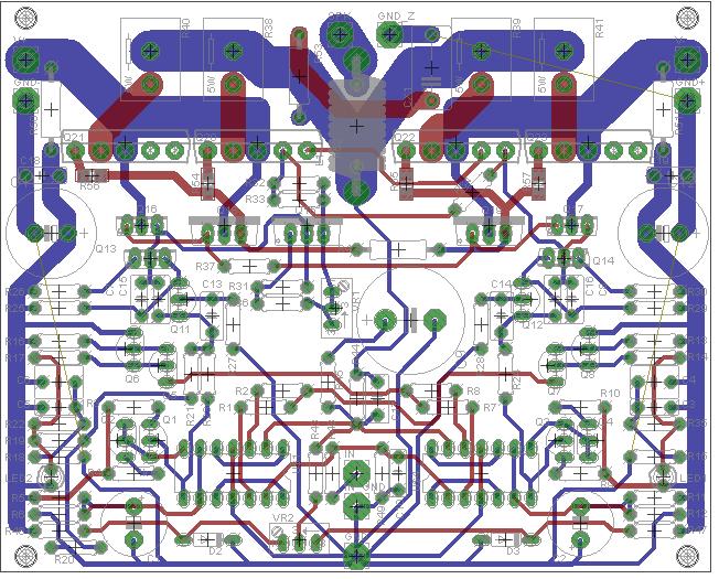

Final version of the board and schematic. Some component values and package sizes tweaked to match reality, also decided to move the fuses off to a power supply board. I've got the BOM entered at Mouser and am about to pull the trigger on ordering parts.
mightydub, you should put some base stopper resistors in the driver and output devices bases. I designed and built a similar (i.e. fully balanced) amp and you will probably need these. If, in the final testing you see that you do not require them, you can always use 0 Ohm links. You can get some very nice SMD types - ideally th e base stoppers should be as close as possible to the devices.
I like the simple balance circuit around R19 to R21 - this type of topology will not work without some help on the balancing.
Good luck.

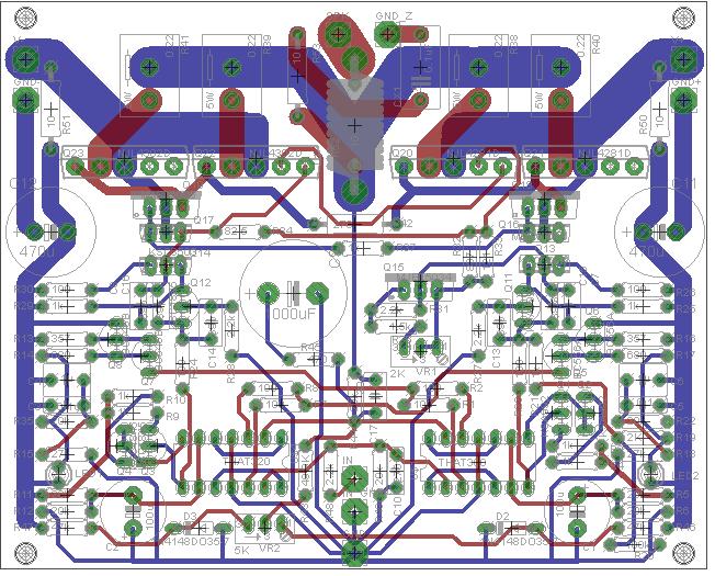

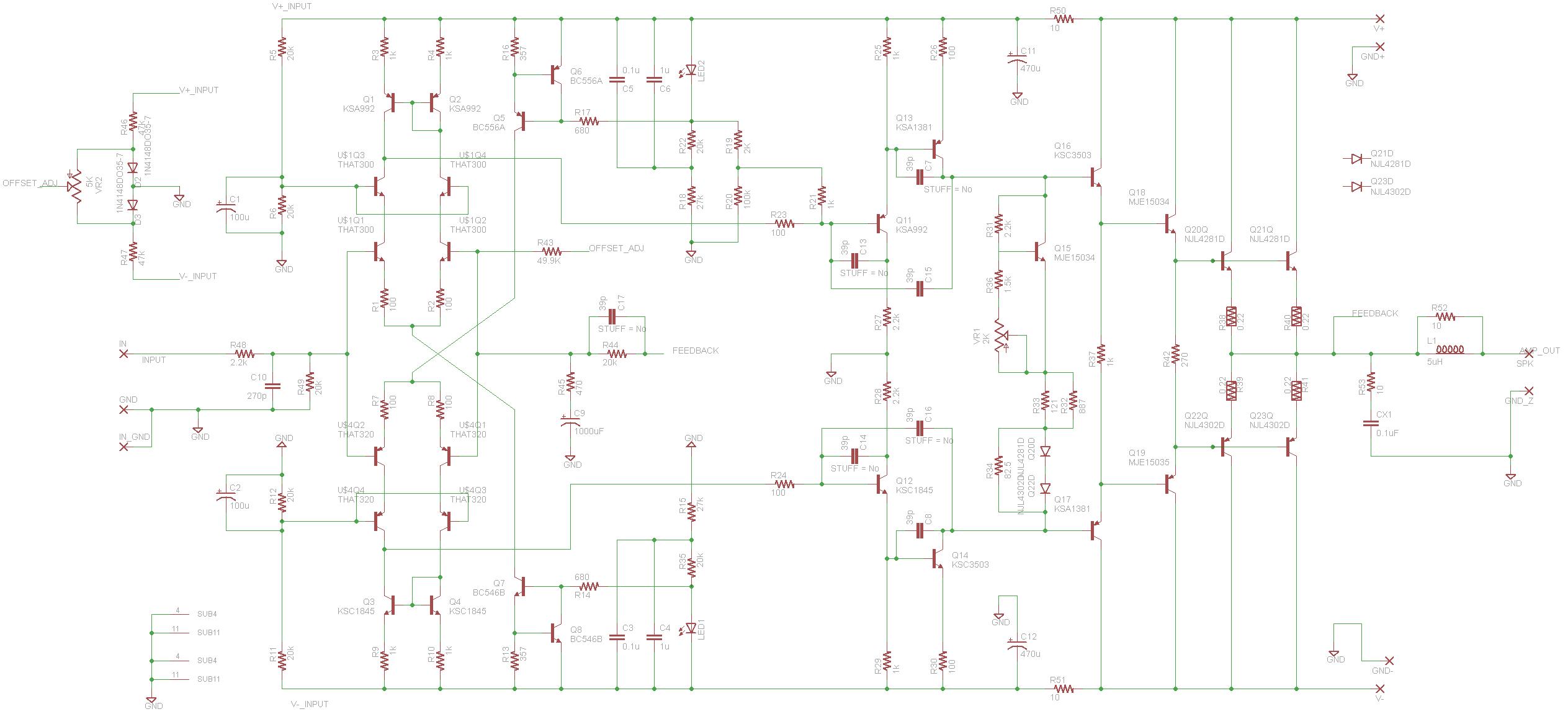

bonsai, mlloyd1,
after much head scratching, reading, and study I have concluded that you are right about the base stoppers. I like bonsai's suggestion to use SMT, I had considered that for the entire circuit and will try it for the stoppers. Back to pcb layout.
Here's rev. 3 of the schematic and pcb, now including base stoppers on the outputs. I have convinced myself that they are only needed on the outputs, and not necessary on the pre-drivers and drivers since those transistors never turn off.
I also flipped the entire layout so that V+ is now on the left side, in an effort to make the output stage layout flow a little better, and lined up the pre-drivers, drivers, and Vbe multiplier transistors so they can all be fastened to a common heatsink. The biasing / thermal compensation scheme is based on these transistors all tracking together in temperature so this makes it easy.
