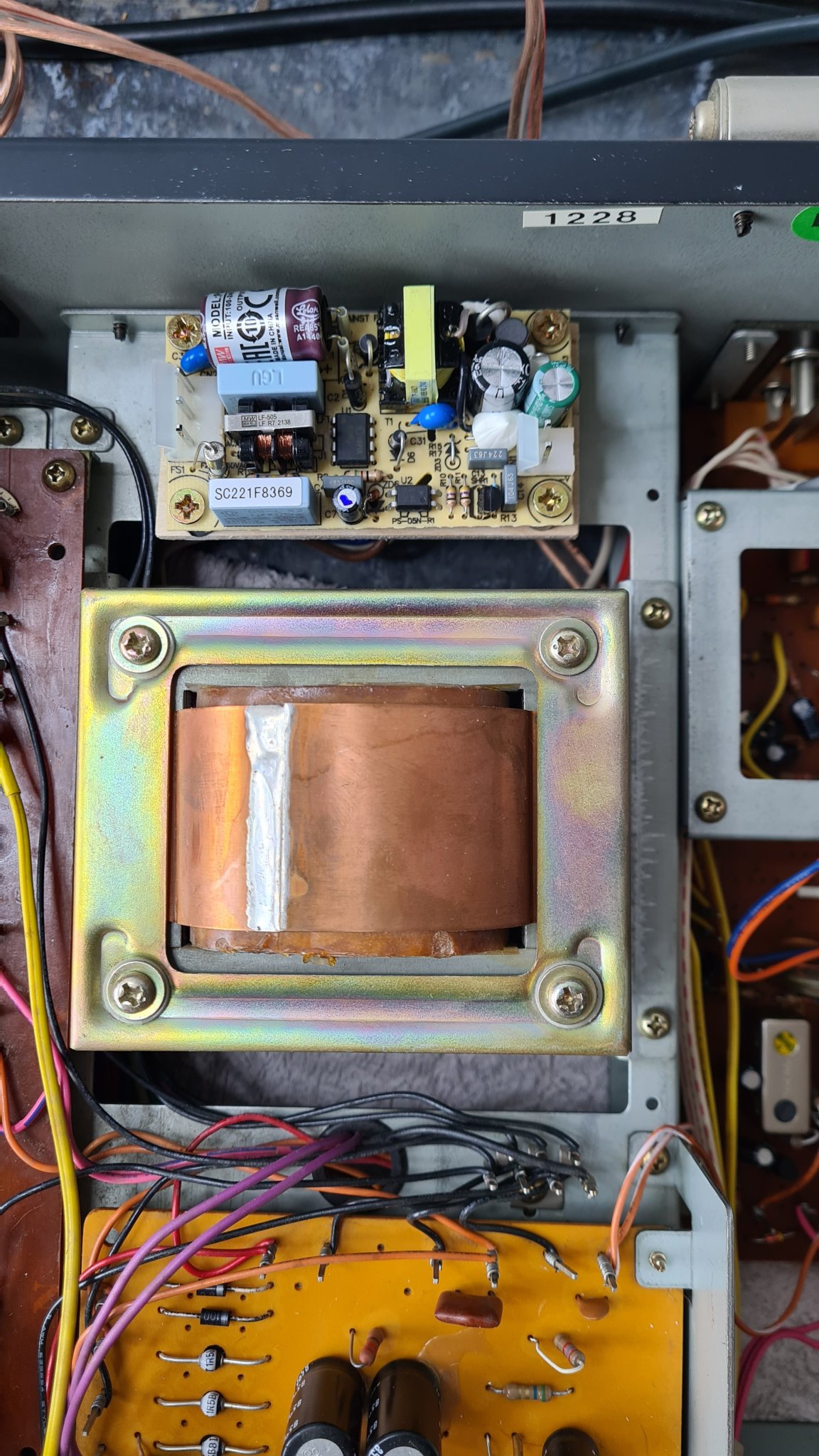

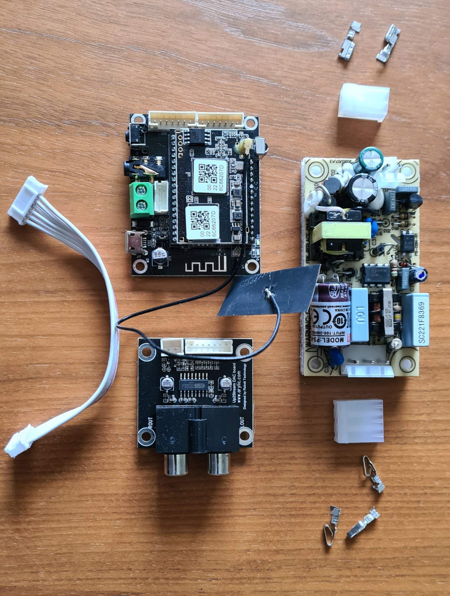

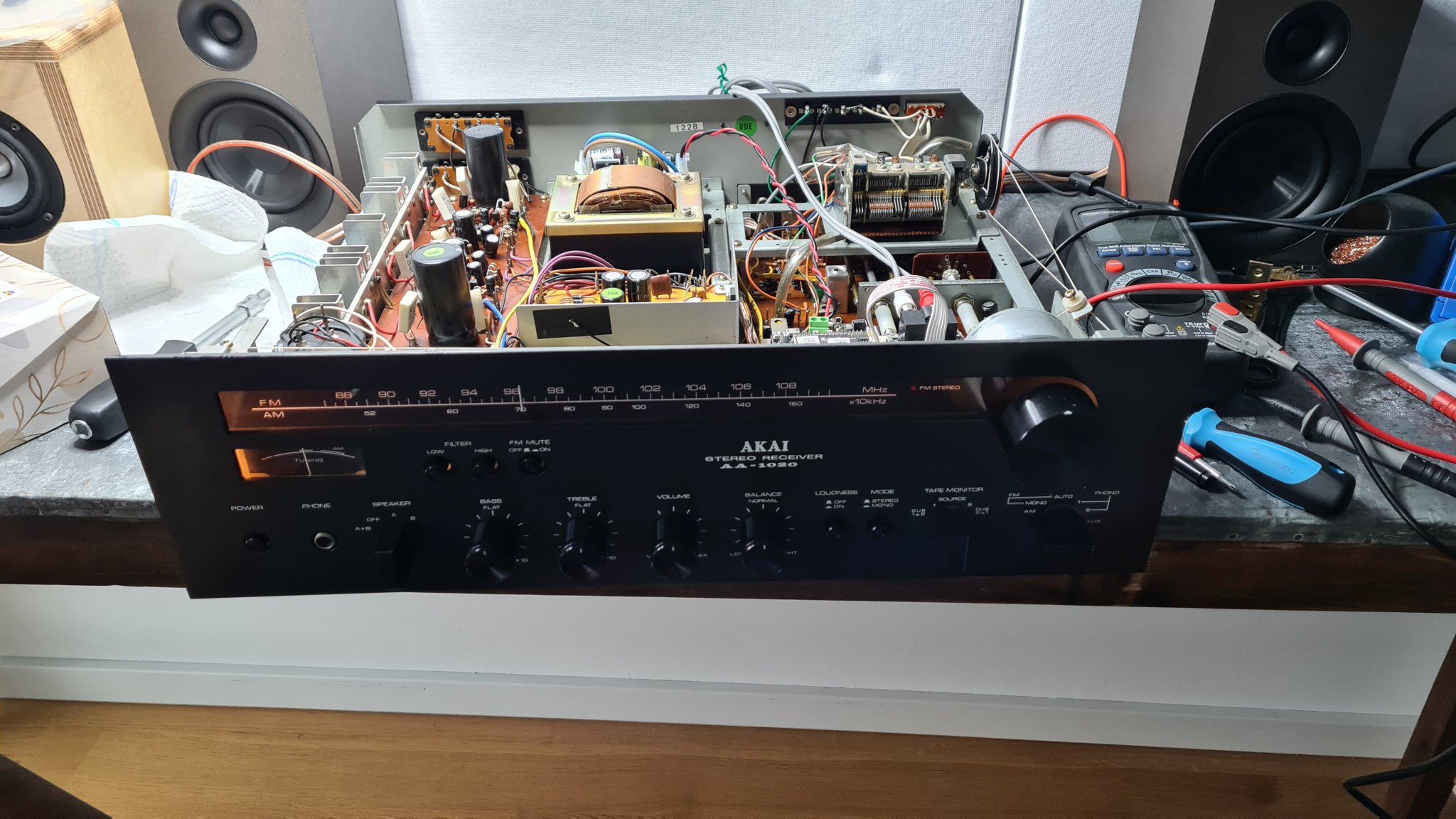

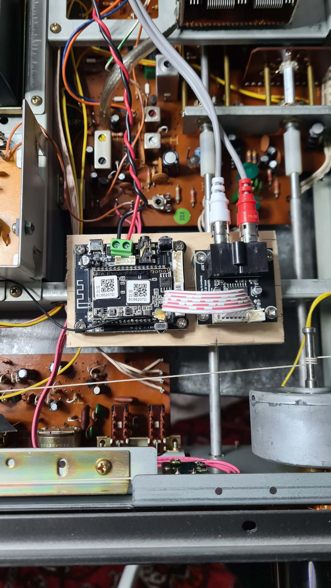

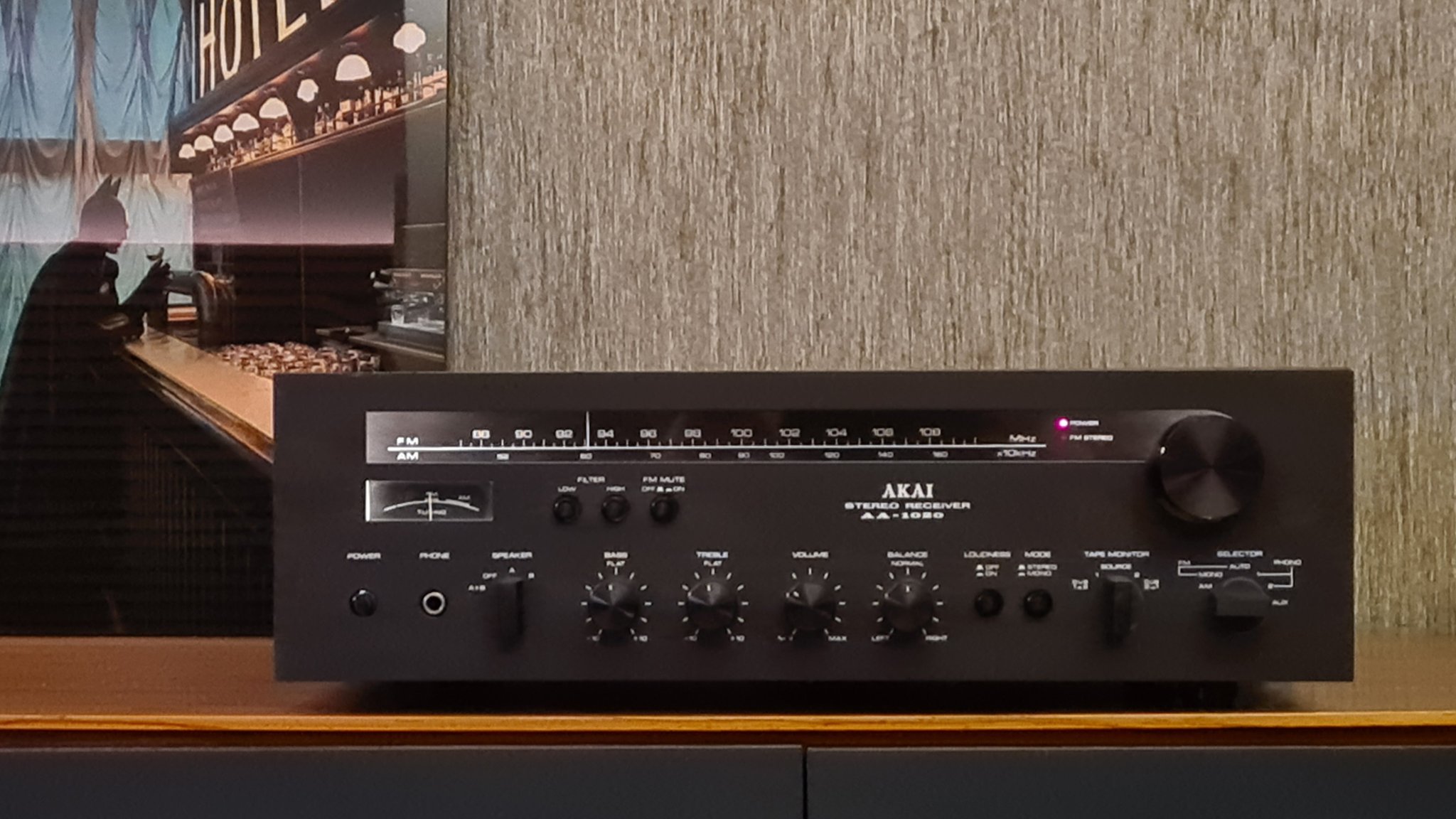

I internally upgraded an AKAI-AA-1020 receiver with an Arylic Up2stream Mini Streamer (which includes WLAN, Bluetooth and DSP). An additional Arylic DAC board improves the sound quality of the streamer. A Mean Well PS-05-5 power supply powers the streamer and is internally wired to turn on and off with the AKAI. The streamer is internally connected to the AUX connector on the AKAI. The AKAI is now a streaming, WLAN, DSP, and bluetooth capable receiver, making it a complete, stylish hifi system. For example it can be used with Spotify and many other streaming services out of the box.
I am thrilled with the sound I get out of the AKAI with the Arylic Streamer using two old Phonar Laser 200 speakers 🙂. The improvement of the sound by the additional DAC board is small but fine. The highlight and crucial for me is the integrated DSP. I took measurements with Room EQ Wizard and a UMIK-1 microphone and then made a few corrections via EQ in the ACPWorkbench softare from Arylic. This brings a significant improvement in sound quality. In the current situation I could tame too much highs from the speaker and some exaggerated bass frequency areas which are rather room and positioning than speaker problems.

Components used in this project:
Streamer: Arylic Up2stream Mini
Arylic DAC Board
