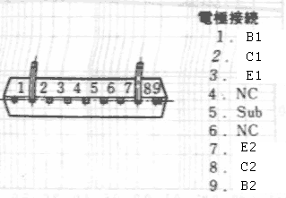

redrabbit said:So, is there a current replacement for this device?
=RR=
matched and temp connected (face to face ) :
pair of BC546C - for UPA74V
pair of BC556C - for UPA75V
good enough - at least for audio use
that's for Europe ; for other parts of world - find adequate substitutes

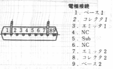

- µPA75V and µPA74V data
