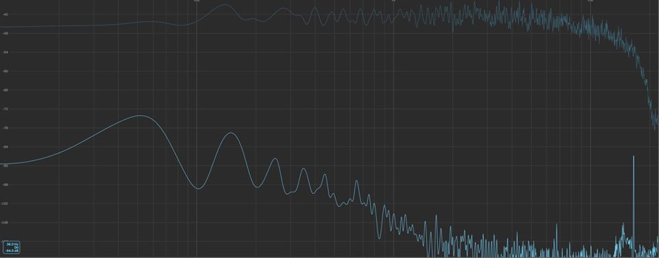

good evening everyone. i'm on a project on breadboard ad the device is basically working. ( is a crossover project 153 from elliot sound product )
however, i'm getting those tones on the spectrum . first frequency is constant at 50hz plus harmonics and the one at 16khz is present only when the device is on. what could it be caused by? screenshot attached
i have some patch cables outside the breadboard as well (not enough space)

You didn't mention whether you paid any attention at all to grounding and shielding, or how you are disposing of power supply line filter leakage currents (the other prominent source of 50 Hz aside from ground loops). No photo to go by either.

all the grounding are connected as shown in the schematic but the circuit is not yet shielded. i'm taking the +-12v straight from the uzeus and actually i haven't done the line filtering, will do straight away, that could be the cause.

You'll only be able to eliminate mains harmonics on a breadboard by going outside and using battery power... 16kHz is odd though - its a subharmonic of many ADC sampling rates, might be an artifact of that, or of the power supply, or from nearby lighting.

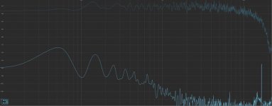

today i changed power supply. now i'm using a Meanwell rt-65b and the frequency at 16khz disappeared, the 50hz has been reduced a lot as well, it was coming from the uzeus power supply!
