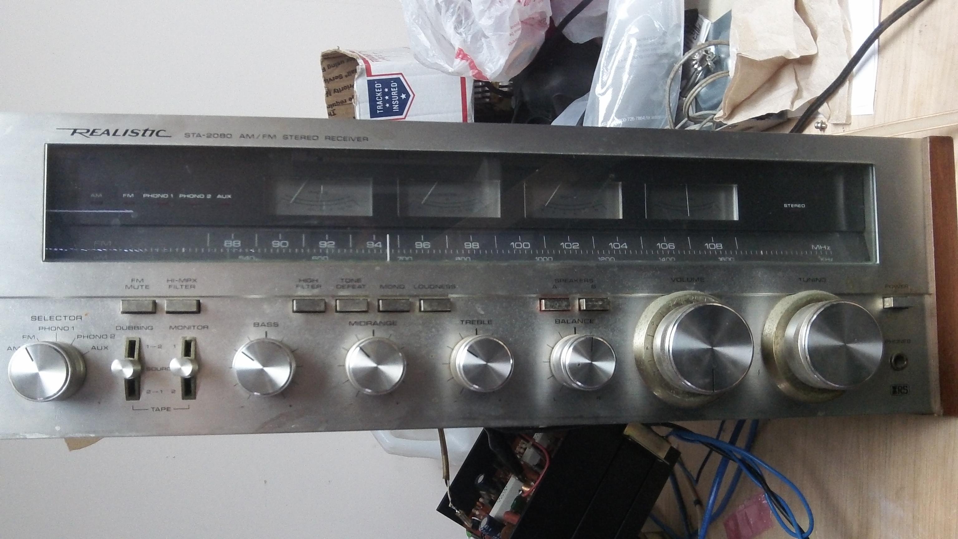

I am repairing a Vintage Realistic STA-2080 amplifier that has a severely overheating LEFT channel.

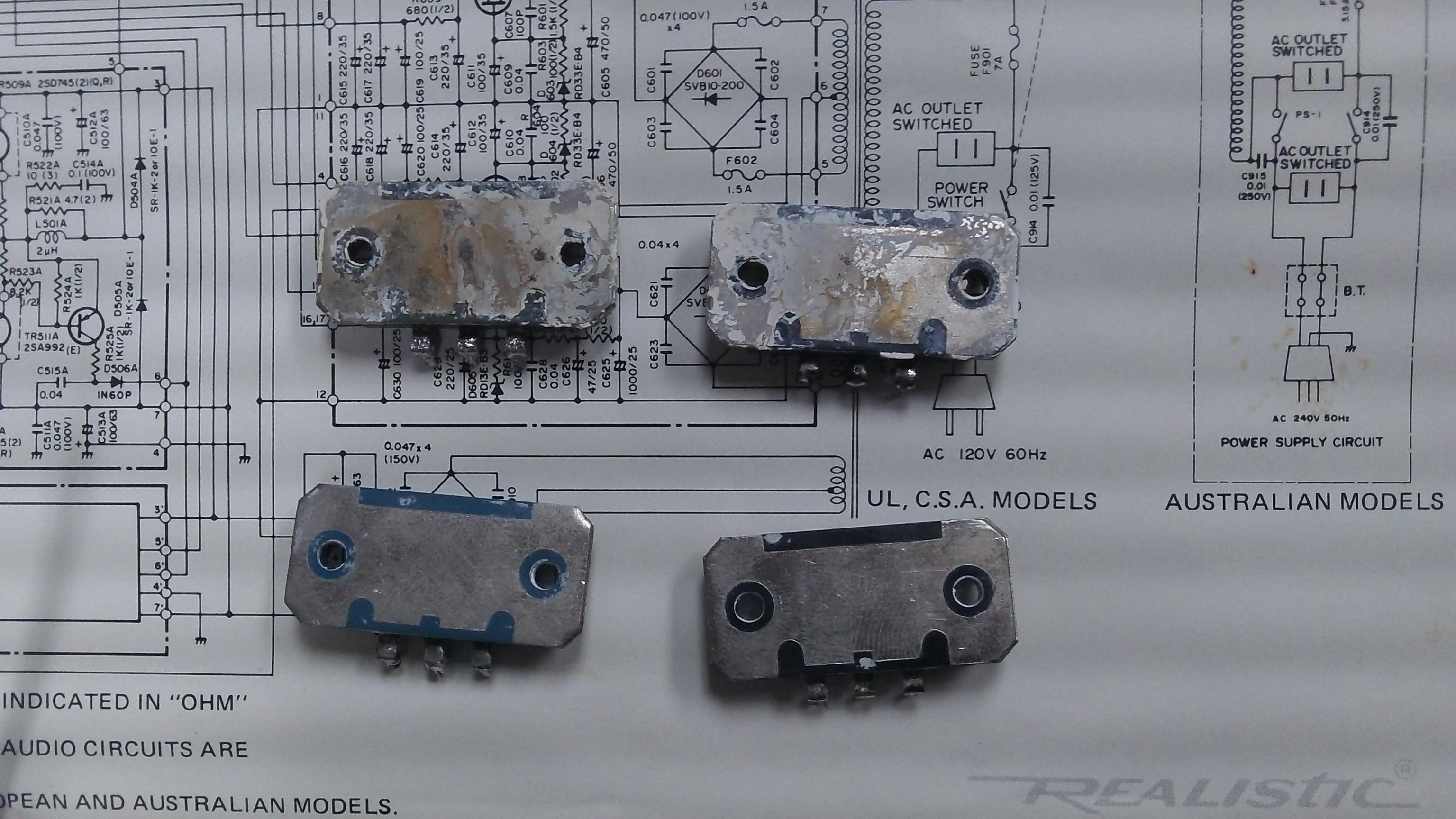

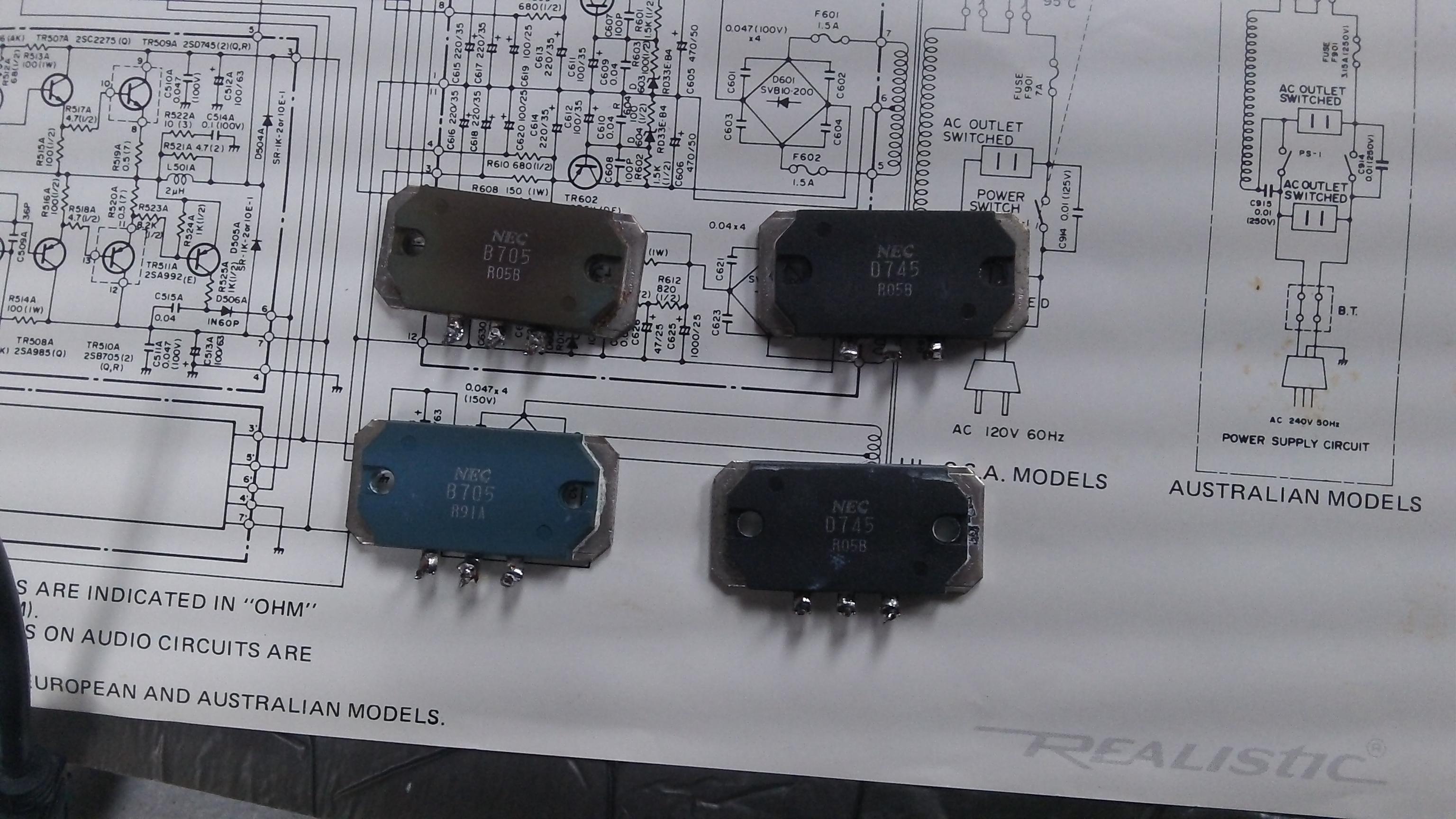

The Original NEC 2SD745/2SB705 output transistors are BADLY burned, (green PNP colored brown) and still measured good, but I replaced them anyway with MJL3281/1302 Onsemi and at first it seemed stable, but it started thermally running away again. I also replaced BOTH 220 ohm BIAS pots with a 100 ohm+39ohm in series to make bias adjustment less sensitive, and easier to set the quiescent current.
When I measure the 0.5 ohm output resistors, I can set the bias to ~30mV on both channels and it will stay, but after a while it will go to over 200mV and run really hot just on the left channel again. I will push and bend on all the components, and sometimes it will go back to normal, and sometimes not. When it acts up, the bias adjustment will still adjust, but the quiescent current adjusts at a higher rate.
I am suspecting oscillation, or possibly an intermittent component, but the repair shop has no oscilloscope, but the amp still has a paper schematic that came with it, so at least that gives me some peace of mind.
I have resoldered ALL solder joints, but I am getting tempted just to change out ALL the resistors and capacitors with fresh ones, since they are so old, but I would rather just find what is triggering this first, before doing that.
Any ideas or input is welcome!

Thanks for your input guys. I need to clarify that it already had heating issues previously with the original NEC transistors, that is why I changed the transistors. The new transistors actually are slightly easier to set the bias, so I can not say that the new transistors are causing it.
I have to give credit to the original 120W NEC transistors for lasting for years under those conditions, but it is time to retire them.
I used my multimeter to measure the bias VBE POT while on, and now the amp is setting correctly, WTF? I am considering taking Nigel Wright's recommendation and replacing the VAS capacitors with some fresh ones.

PICTURES

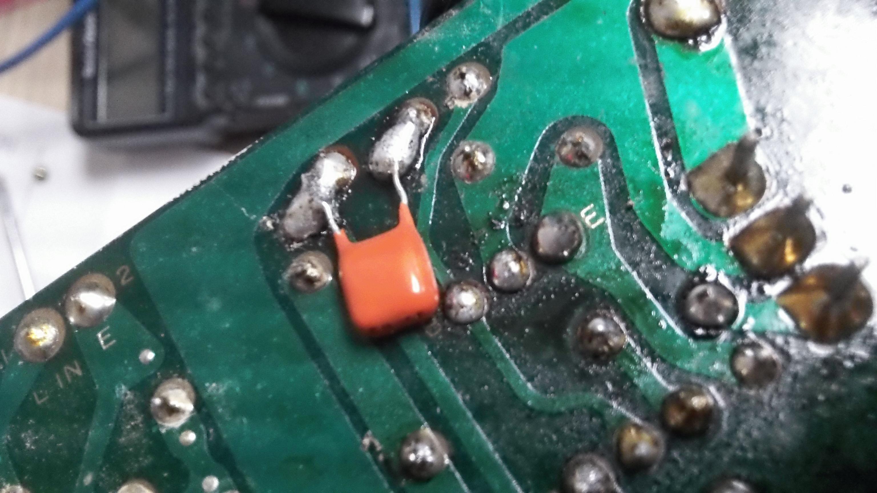

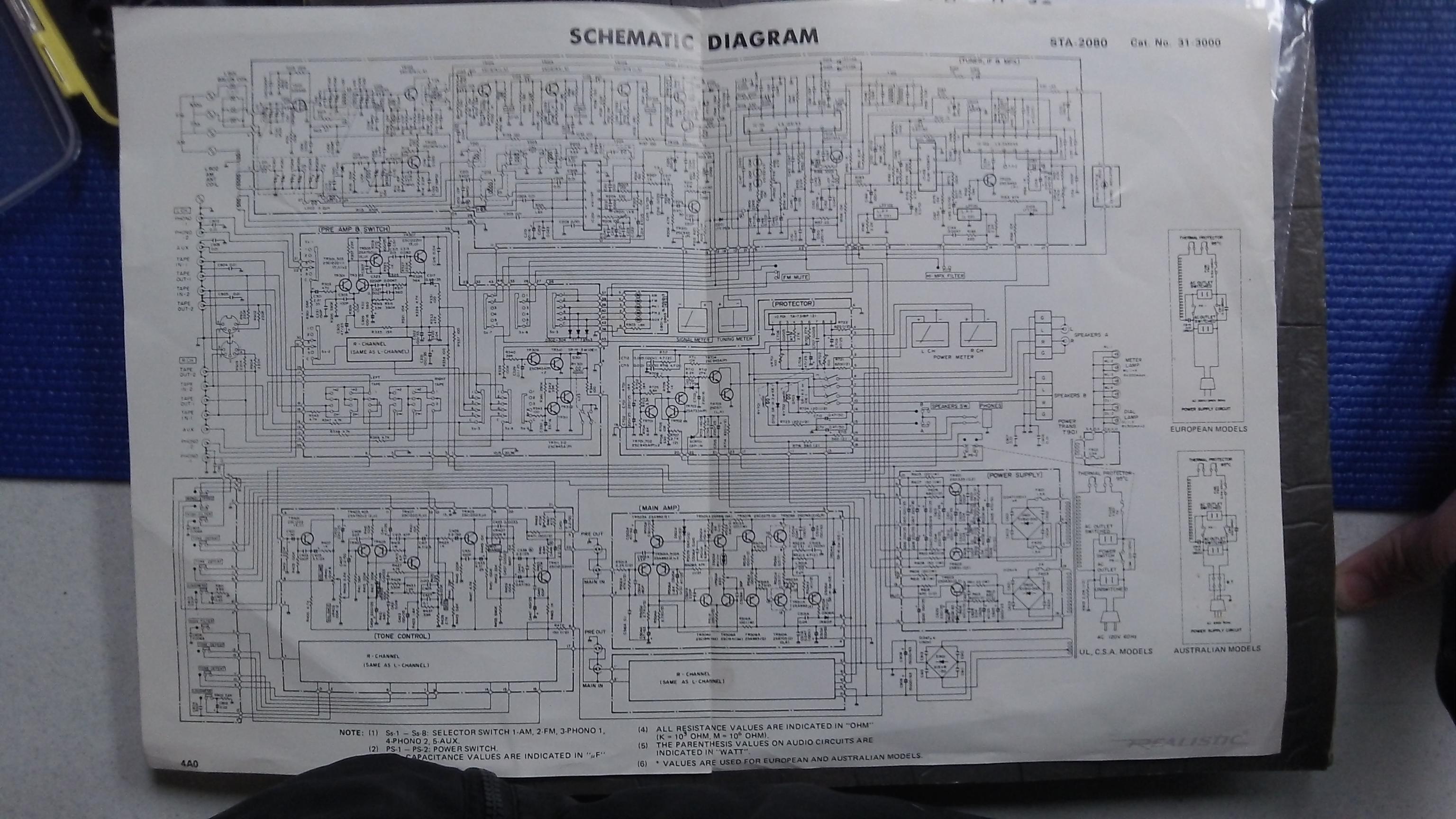

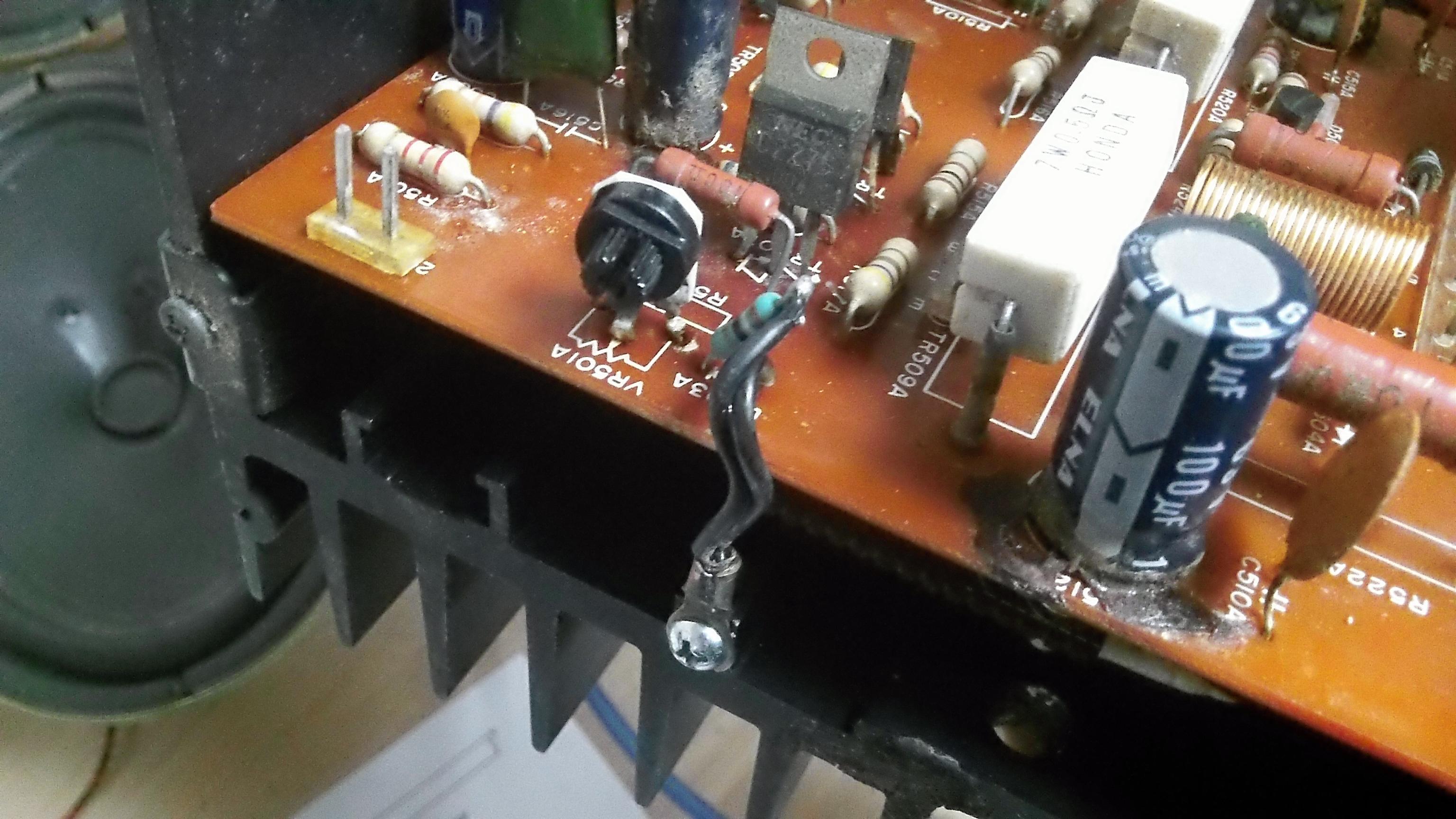

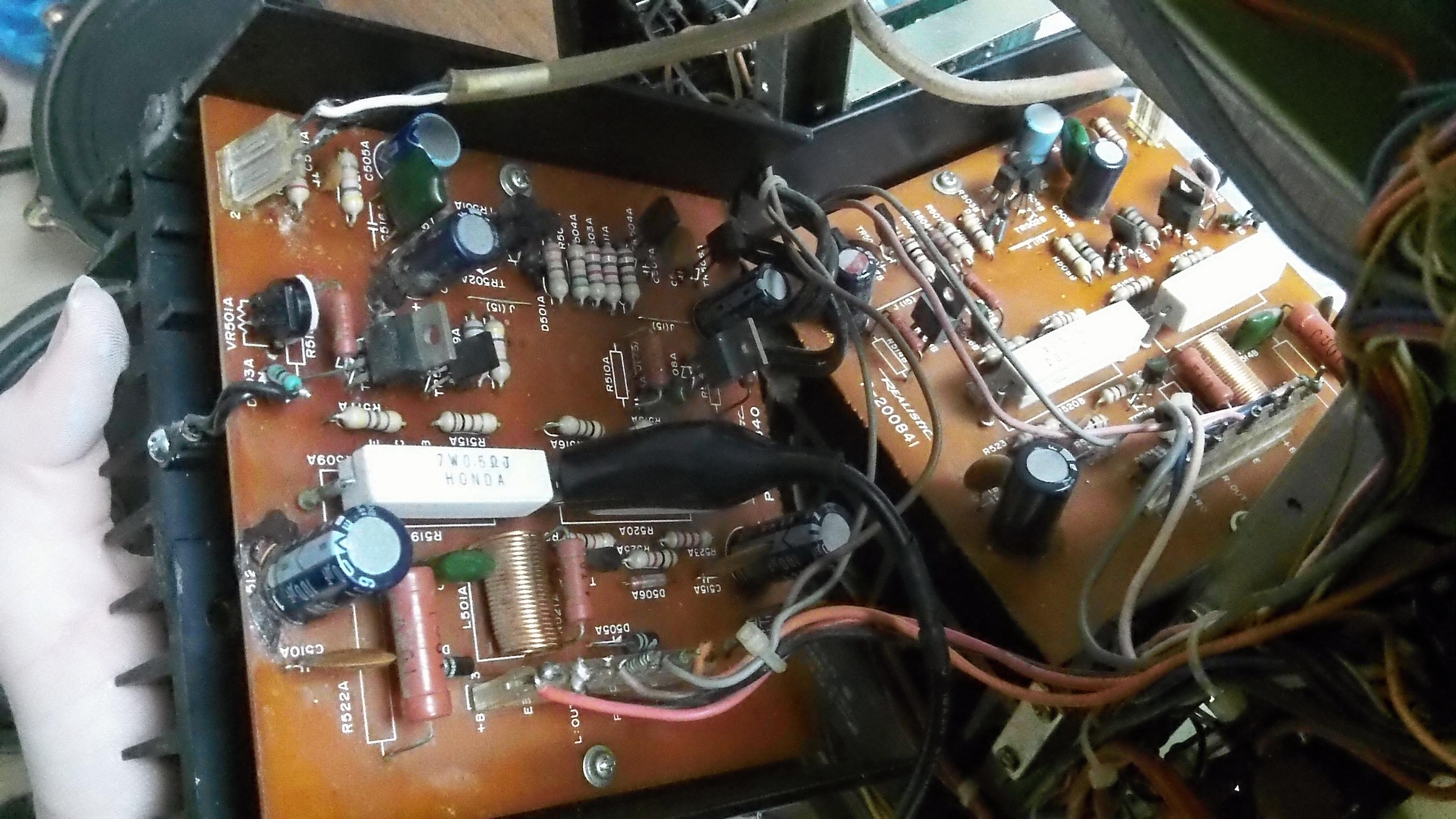

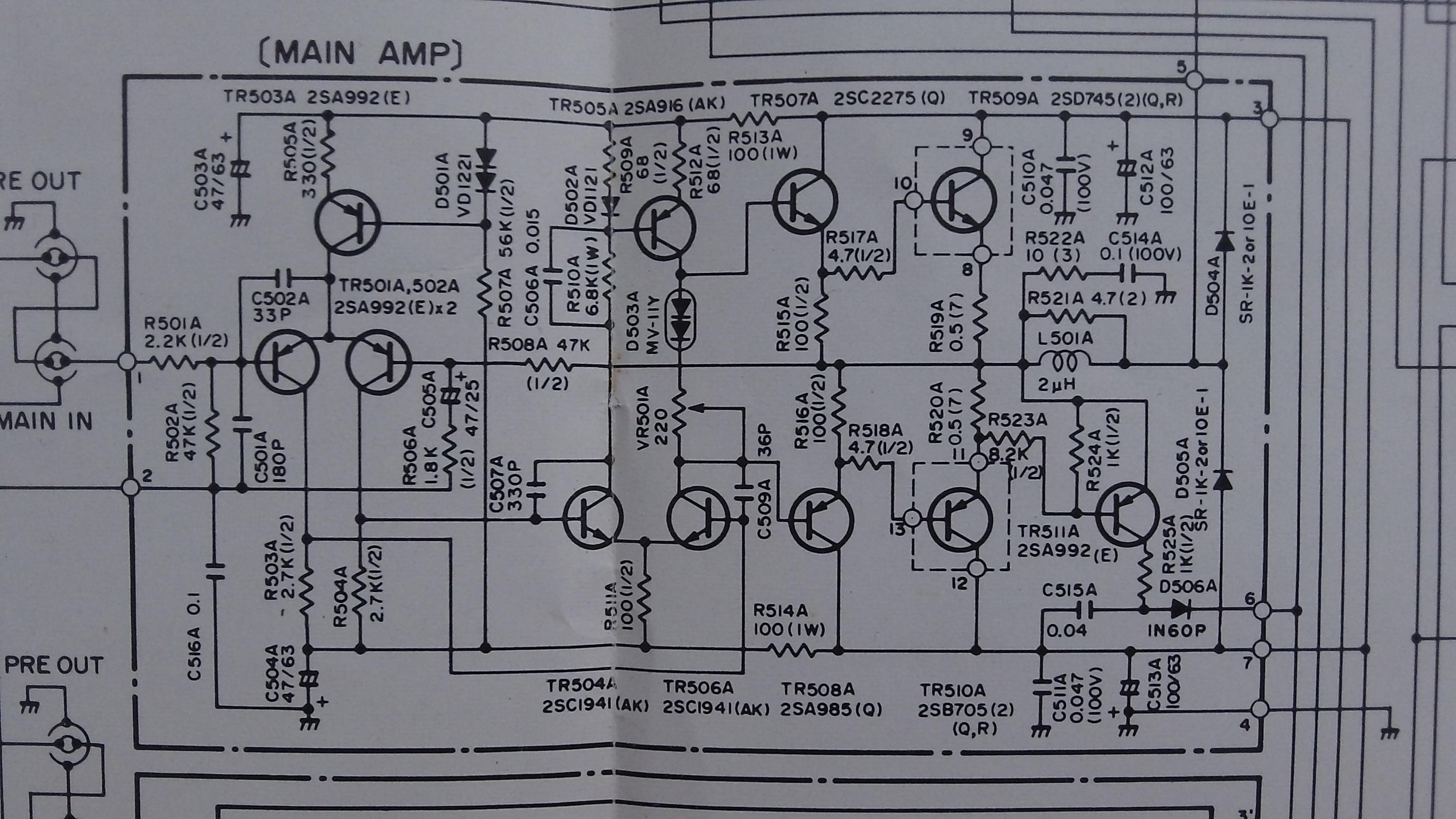

I am posting pics of the AMP, Schematics, and also capacitor across BIAS POT (smooths adjustment)
Thermal Diode(s) are a single component screwed on to the heatsink, near bias POT, see picture

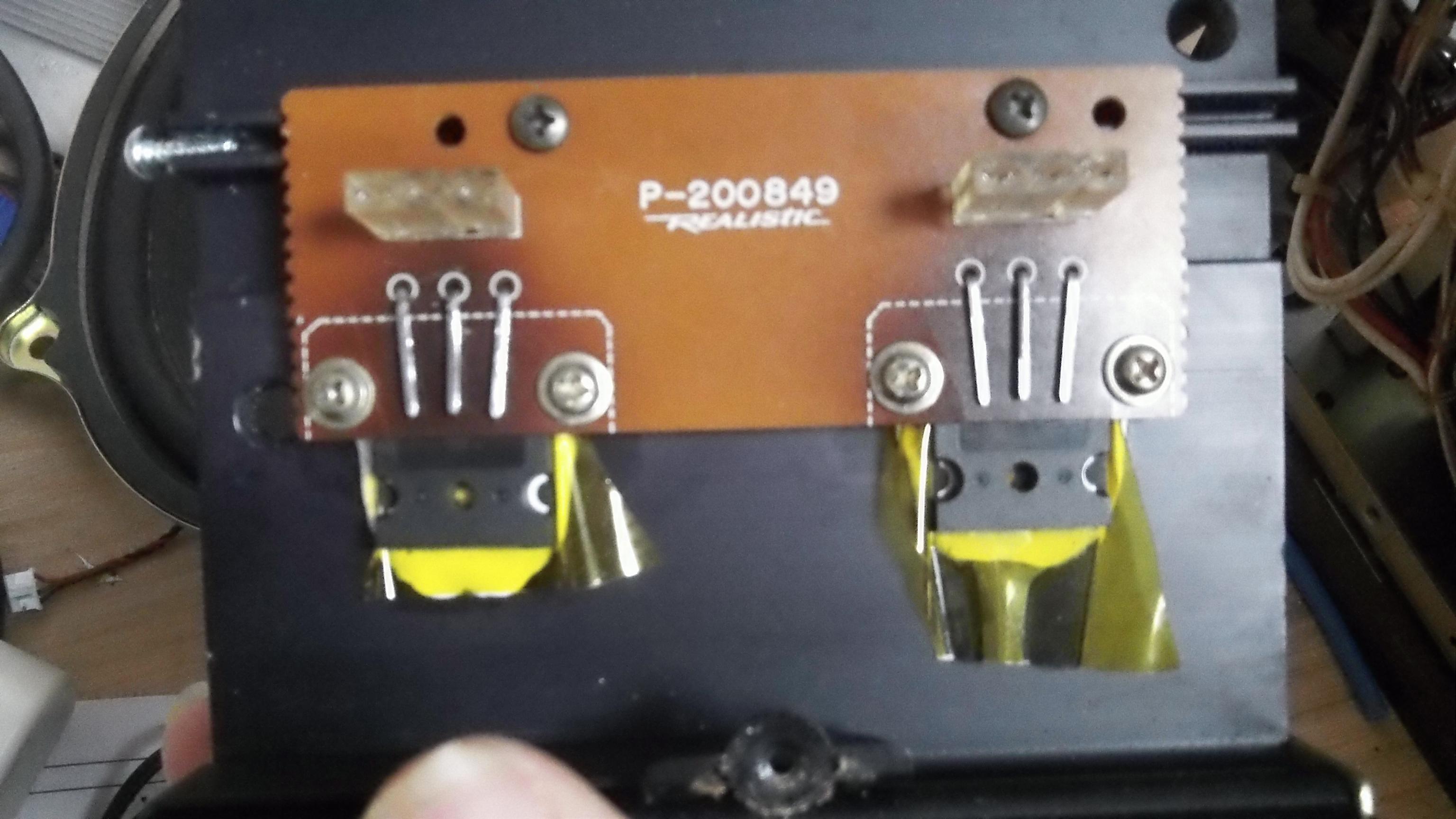

I used KAPTON Tape on transistors themselves, because heatsink surface was rougher than the transistors, and used thermal grease too.
BEWARE, pics are huge, I don't have photo editing software, and was in a hurry to post them, sorry.

This circuits front end looks very much like an old Hitachi lateral mosfet application note.
C509A looks to be very small in size, my circuit shows about 100pf.
Might be worth tacking 100pf across it and seeing if the bias settles down.
D503A is the culprit. You will find this located on the heatsink. It is open or nearly so.
I've successfully replaced these devices by putting a couple of 1N4002s in series and mounting them on the heatsink. The thermal characteristics are not exactly the same, but it worked so well that it was not worth writing home about.

I was suspecting this part (sort of) but if this part is going open, I wouldn't expect the bias to still be adjustable, being the Bias POT is in series with it......that's where I'm a bit unsure about it.
Would using a darlington transistor substitute the two diodes as a thermal sensor? It would be super easy to mount an isolated TO-220 device.....
However, if not, I could take two silicone diodes in series, mount them in a crimp connector and screw it to the heatsink, similar to the original part.
I will also add 100pf VAS compensation as well.

One thing I am uncomfortable with.....I just looked up the datasheet on the drivers. 2SA985/2275
They are only rated to 120V, and the amp has over ~55V rails unloaded. This may be unrelated to the issue, but I had to mention it. Again, only issue I have is with LEFT channel, but boy the drivers run hot for both channels.
I am considering replacing with MJF15030/31 Original Motorola transistors that I have.
Also noticed on the LEFT channel TR505 has blackened the PCB, but NOT on the right channel. There is also a temp compensation diode that leans against that transistor.
It also has a compensation diode resting against the current source transistor TR503 for the differential LTP.
I'm going to take your suggestion and change it out for both channels.
I just discovered with a multimeter that there is some current flowing from the leads of the D503A to the "fork" which is grounded to the heatsink that changes resistance when touched or wiggled.
I hope this is it.
Indeed, it would be a decidedly good idea if the bias diode maintained good insulation from the heatsink. Other than that this kind of bias diode can also simply go intermittent, VDxxxx types are notorious for that. D503A/B is an MV-11Y though. Have you checked the bias pot? Sometimes they literally fall apart in old age, or at least are hard to revive.
There are two of those pesky VDxxxx bias diodes still lurking in the circuit actually, D501A/B (VD1221) and D502A/B (VD1121). If in doubt, the appropriate number of 1N4148s soldered in parallel should help narrow things down. Those can also be used to make a makeshift bias diode replacement if need be, just a bit more work due to providing insulation while still maintaing good thermal contact.

Looking at your pictures of the hot board and the glue holding the capacitors looks a bit suspect, to say the least.
