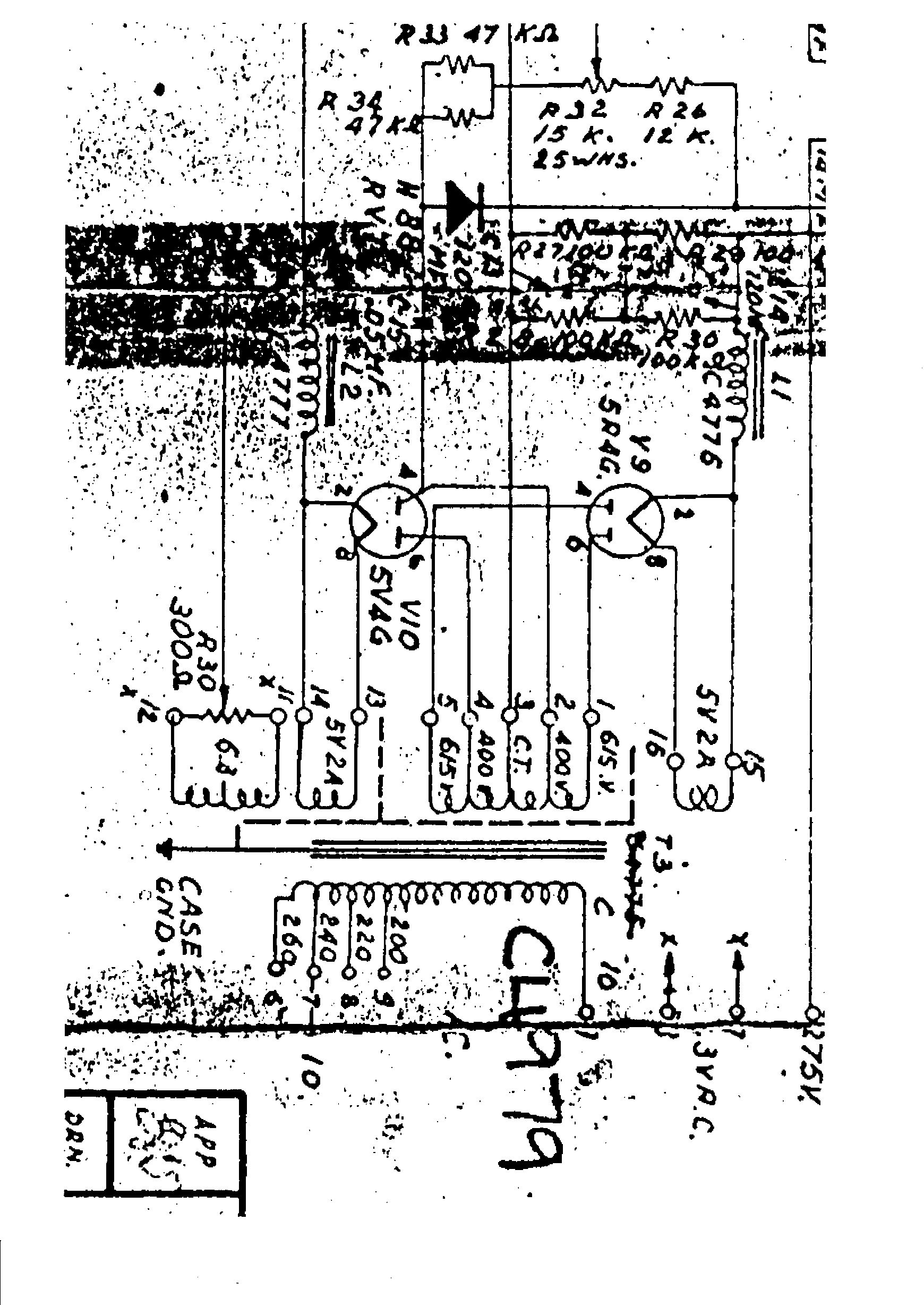

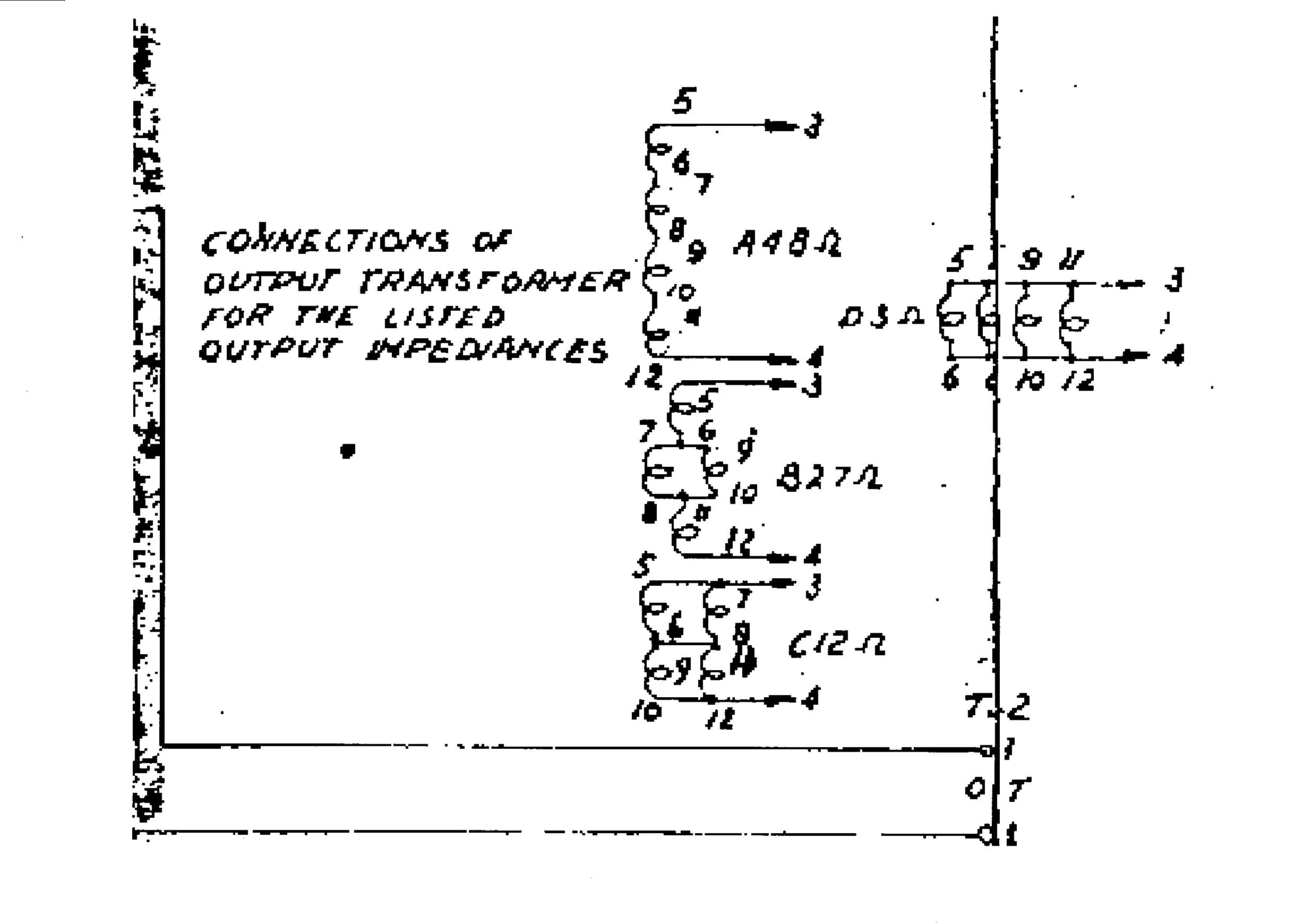

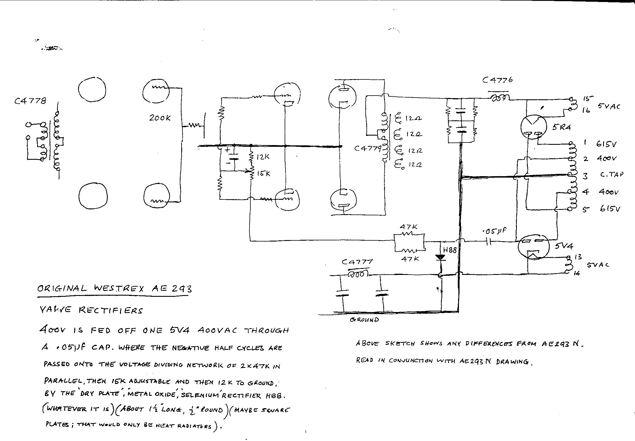

i have some circuits for these amps and how to wire the output transformers for different speaker's Ohms.
I made the mistake of rebuilding them; the out put transformers can not handle Much feedback from the out put best to stick to the circuit and use feedback from the plates to the drivers. Have very good Bass.
I can scan the circuits if you wish.
Phil

If you could, I would really appreciate it. Thanks heaps.

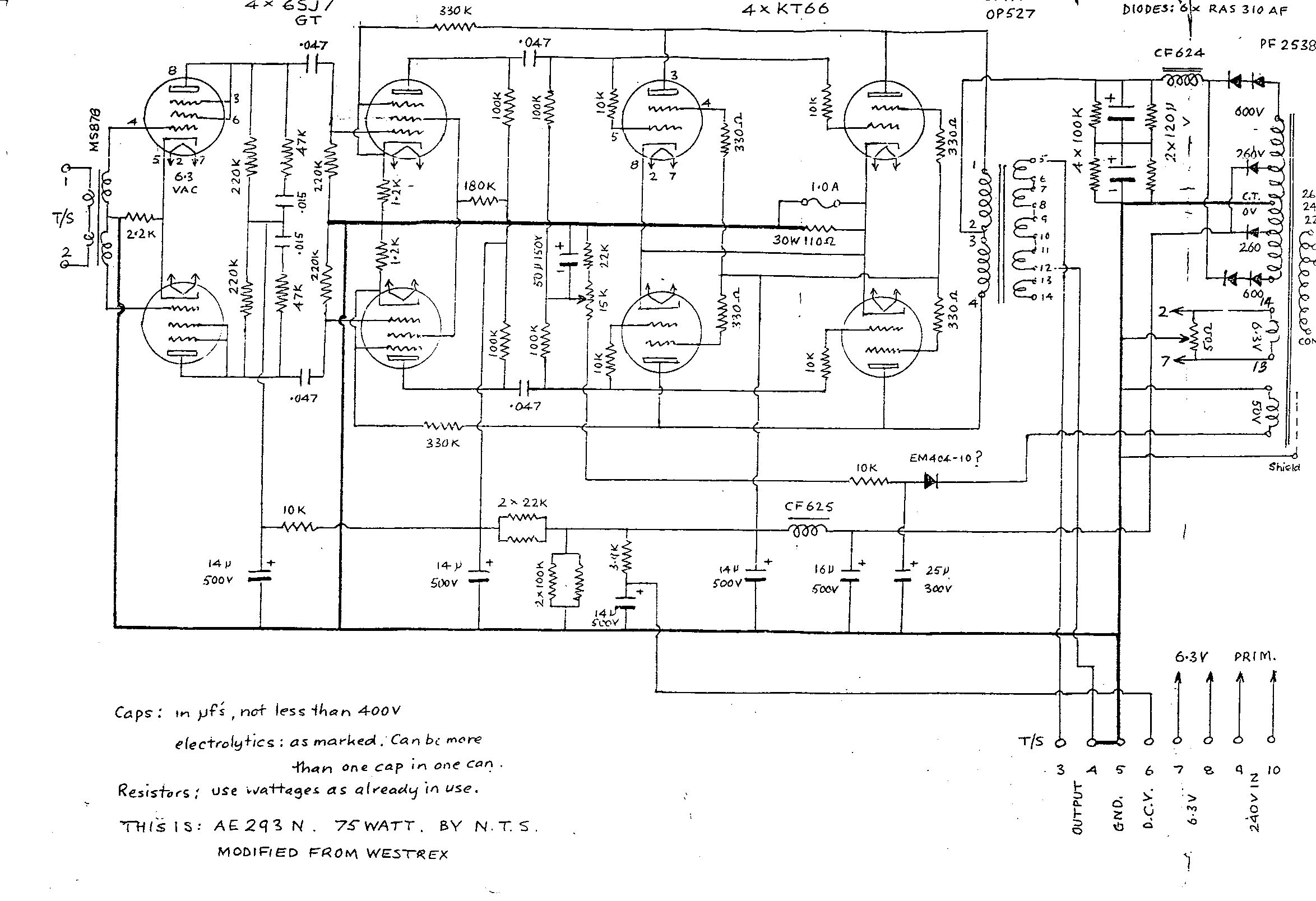

For my own reference, and if anyone's curious about the topology of this thing, I reverse engineered the circuit. It uses a transformer phase splitter right at the beginning.
Nice.
But there's no decoupling cap for the driver tubes' screen grids after 330KΩ?
That may be deliberate..
Can you explain the benefit of not having the screen grids decoupled in the schematic, extra feedback? Just curious.
Thanks Phil! I can see there are some differences between the AE293 and the AE285, but the important information is there.
