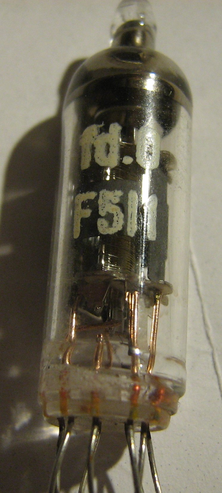

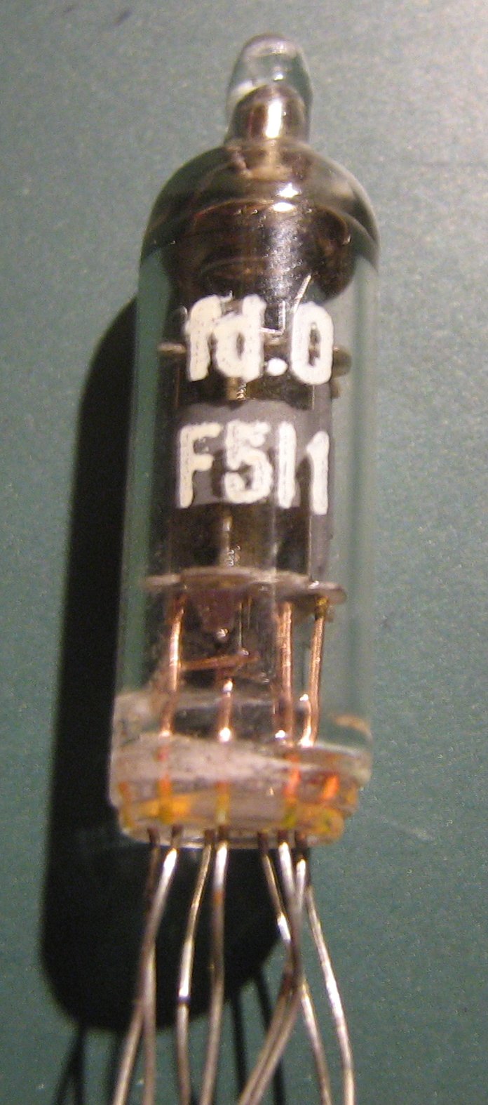

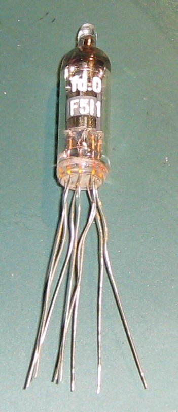

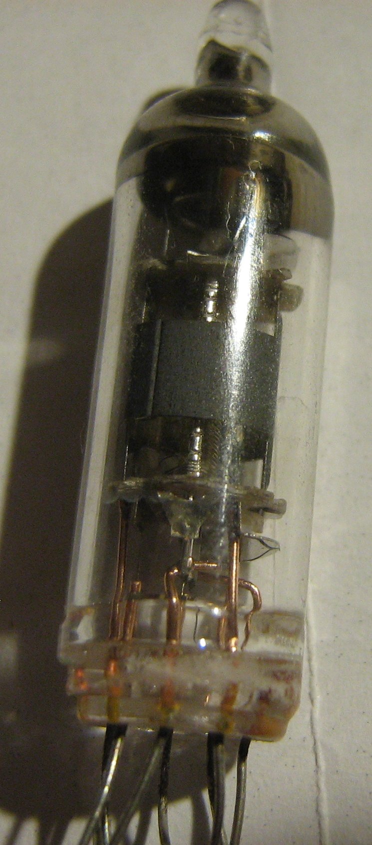

No way,
this tube has a 6.3V 150mA indirect heater.
Tubes for hearing aids had 1.25V 25mA filaments or so ... and were DHT.
I was not aware that the little tube had those heater characteristics, which would make it unsuitable for a hearing aid.
Believe it or not, but a Sovjet 6n16b has 6.3 V 400mA heater power, in the same envelope; the 6n16b is a dual triode with plate curves similar to 6SN7.
The tube in question - marked F511 - seems to be a 5840 pentode.
Pinout and characteristics match 5840 aka EF732 spot on.
Va = Vg2 = 100V / Vg1 = -1.5V --- Ia = 10 mA
Va = Vg2 = 100V / Vg1 = -2V --- Ia = 7 mA
Va = Vg2 = 100V / Vg1 = -2.5V --- Ia = 4 mA
The F511 marking is still a mystery though ...
Most probably a part marking from either, what ever it came out of, or was intended to go into. Doesn't matter. Remark and move forward. Mystery solved.The F511 marking is still a mystery though ...
