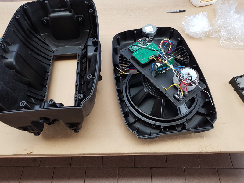

I opened up a (very) cheap active speaker to see what's inside, and to apply mods.
There are two leads between the amp panel and the speaker's front panel:
1) connects to a power LED.
2) connects to something in the port.
What is this?
If I was going to guess, I'd say it was a mic, and it controls a high pass filter, to cheap the woofer from exploding at high SPL.

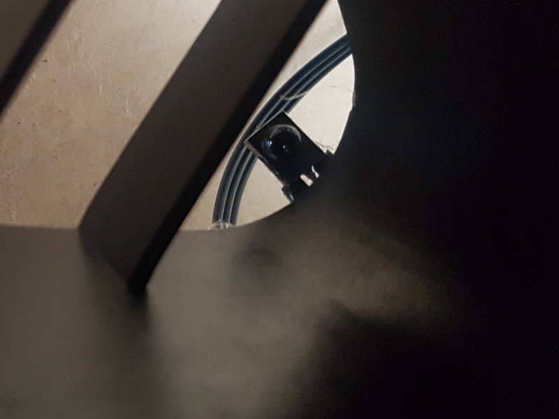

I don't think it is (another) LED.
The power LED on the front panel has 2 wires, this thing has 3. The location also seems odd for a LED, but reasonable for a sensor.
Looks like an infrared receiver. Speaker controlled by remote?
Aha - that probably is it, thanks. It does have a remote. I never use it, so this didn't occur to me.
Looks like there's nothing stopping me from sealing up the ports, then.

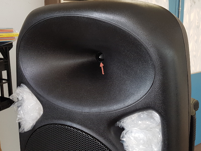

I got a pair of these (over other cheap options) because:
A) I like the horn, and might take a cast of it for other (better) projects
B) On a quick listen in store, it seemed pretty good for a cheap, flimsy speaker with piezo tweeters 🙂
C) much of what is wrong with them can be improved with cheap mods
The horn, cabinet design, features and the tweeter (actually a 'real' one, not a piezo) seem good for the price.
The negatives:
The cabinet is flimsy / boomy.
The horn throat and phase plug are a single, continuous assembly. It would require a hack & rebuild to use a different tweeter.
There is a misalignment and small gap where the two parts of the horn come together (pictured).
The amp has some quiescent noise. This is fine in a workshop (running a fan makes a lot more noise), but would not be good enough in a home / quiet environment.
My initial (low $) plan is to use lots of fibreglass + other fillers to strengthen and damp the enclosure. I'll try an ugly kludge to fill the seam in the horn.
I could potentially do a lot more, but I'll decide after I A/B the first tweaks. Other projects might be more worth my time.

Electret mic? Three wires: ground, live signal, power for capsule?
Just a though...perhaps to monitor output level for some protection?

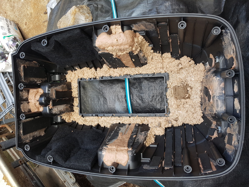

The thin cabinet seemed to be the weakest link (fixed, with about $10 of materials), now I think it is the amp and tweeter, which would cost more than is worthwhile on a speaker this ugly 🙂
Photo is of the cabinet rear, damping goo applied (fibreglass, glue, filler, rubber from recycled tyres).
By the way, this still reeked for at least a week after I put the cabinet back together, and it still works fine. The fumes didn't melt anything.
