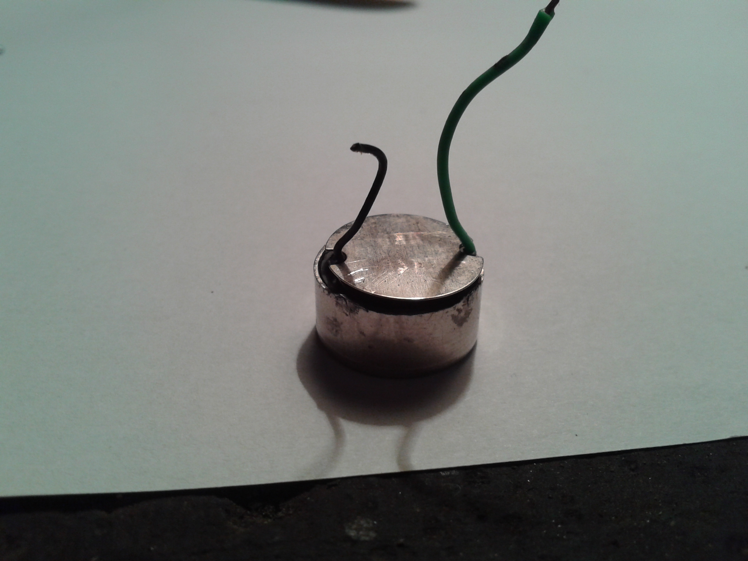

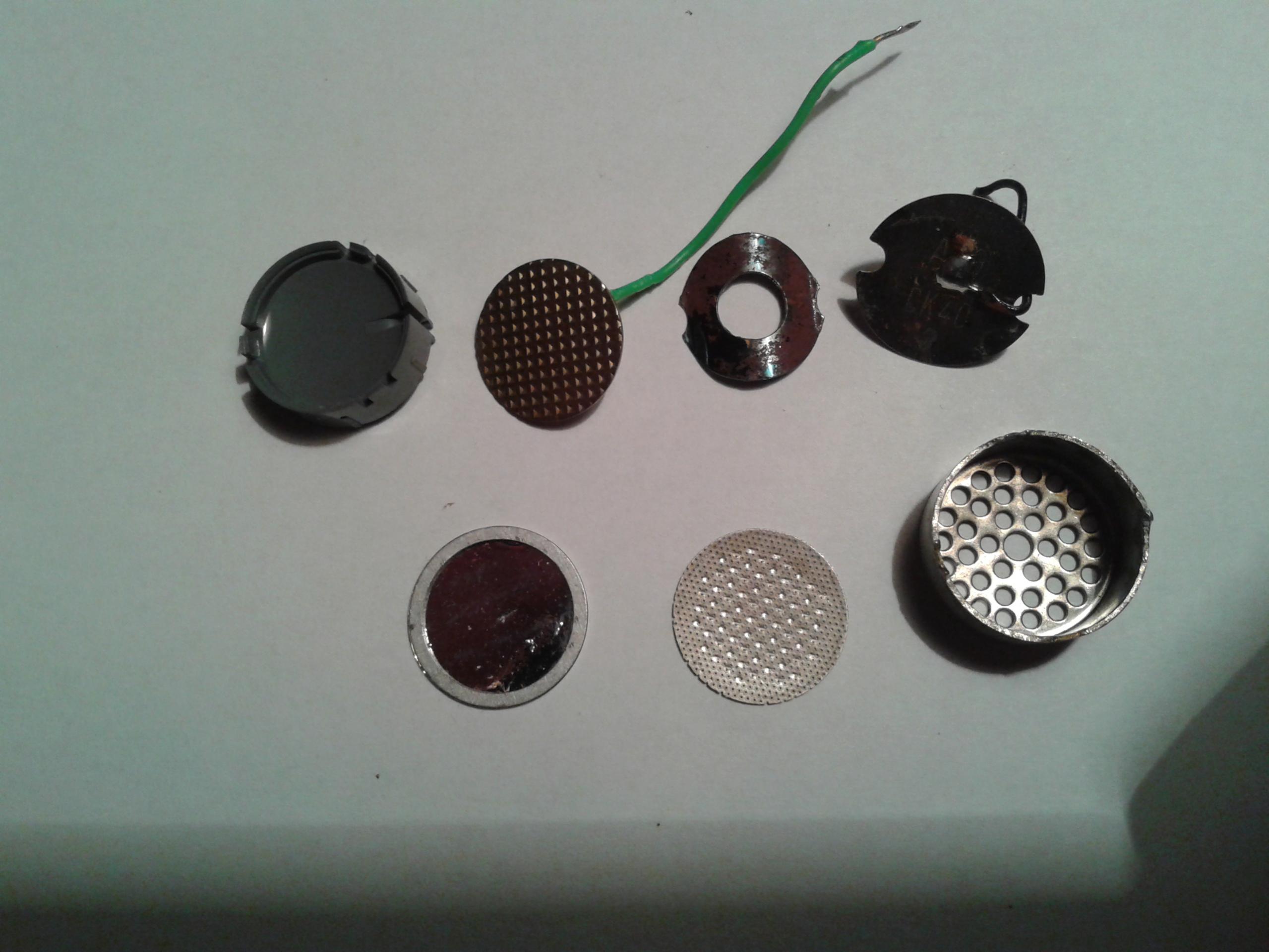

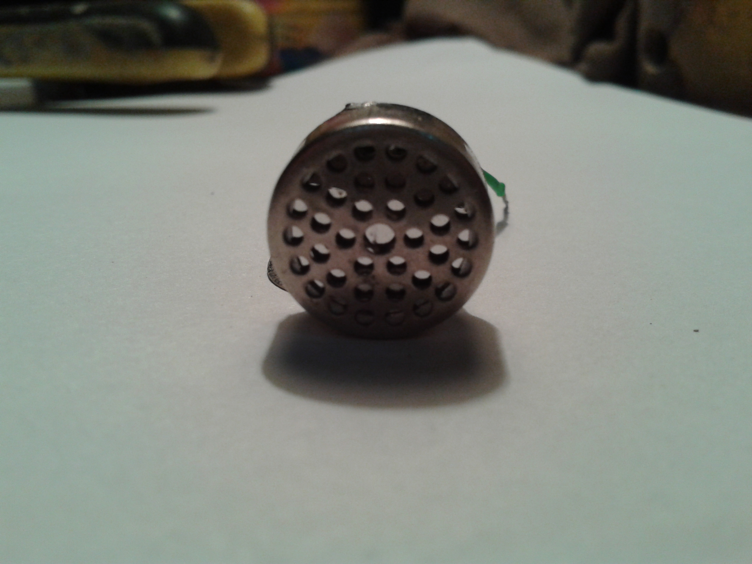

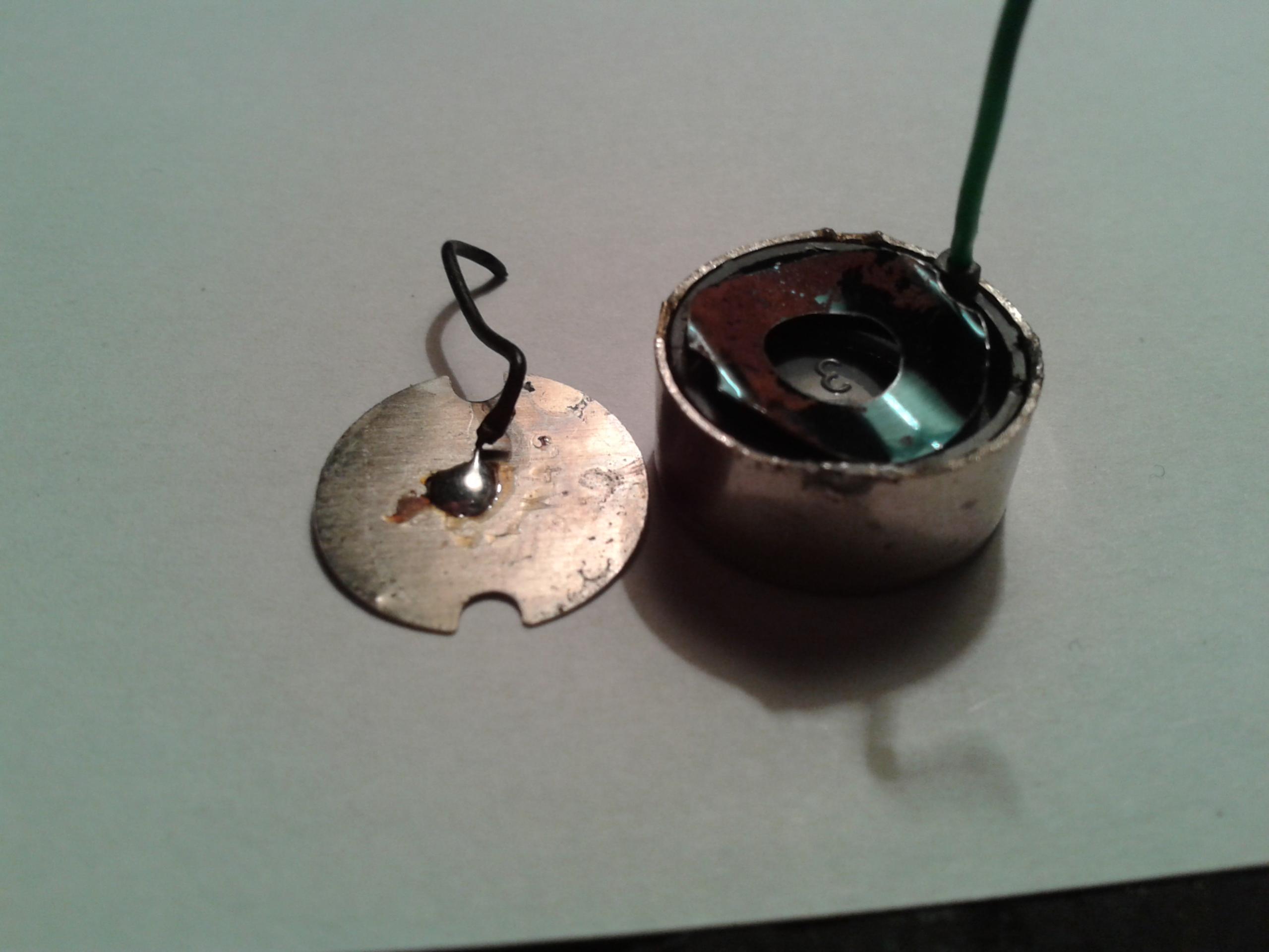

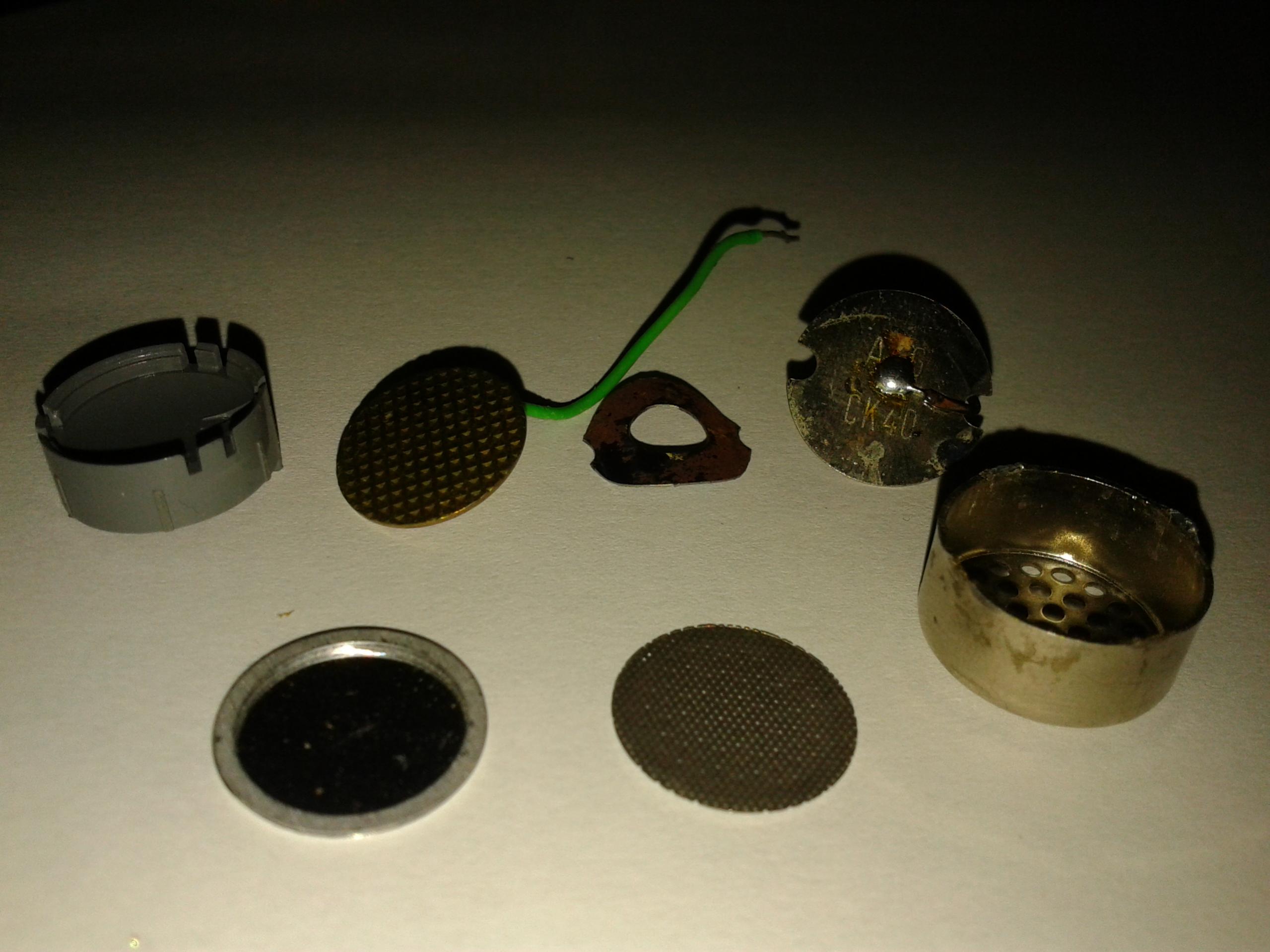

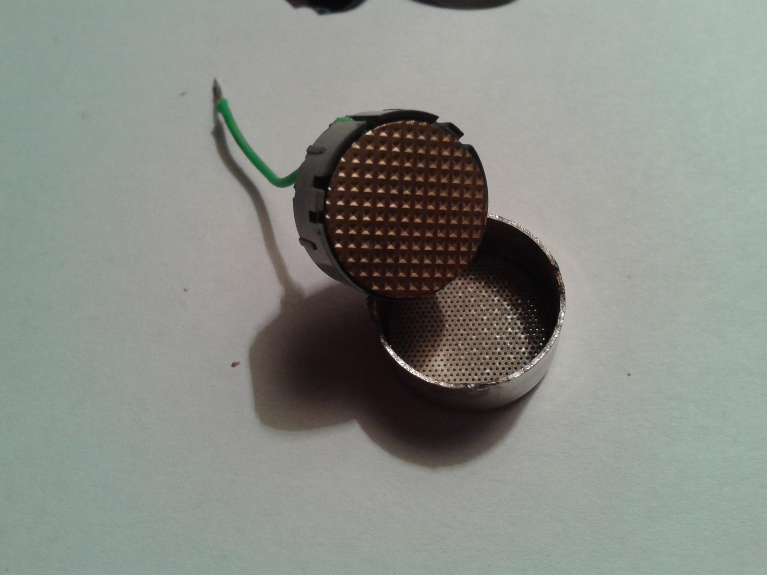

I found this capsule on line, but there's no info at all. It's akg ck40. It's 15mm x 6mm in diameter.
I already built a mic based on schoeps circuit (Zapnspark version) and i used J305 fet...it works ok, except a huge high frequencies boost. I will post images of disassembled capsule.
I tried to lower high frequencies by soldering 6.2nf or so...in parallel with drain resistor. It helped, but it needs more taming.
My question is...do i need to build a circuit with polarization voltage for the capsule...Would that help...and is this electret or condenser type?

According to AKG data sheet, "CK" prefix indicates "Microphone capsule with condenser transducer"
therefore it must be polarized.
