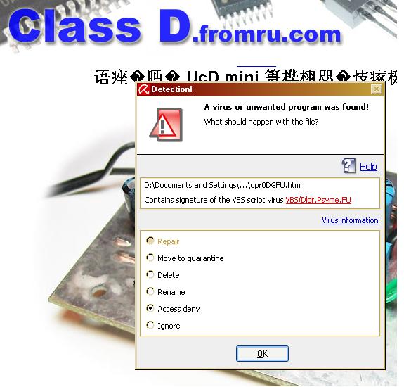

Netlist said:This website may contain an unwanted script:
Appreciate the warning, but opur systems detect nothing. What software do you use? Some can give false positives.

Antivir, but well known among many other scan engines.
http://www.google.be/search?sourceid=navclient&hl=nl&ie=UTF-8&rls=GGLG,GGLG:2006-05,GGLG:nl&q=psyme
The devil is in the popup.
