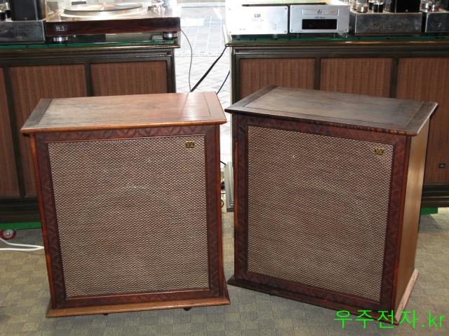

I am wondering if I can get good sound by modifying speaker cabinets purchased via Craigslist near me. Perhaps something like Wharfedale Rosedale cabinets;
Wharfedale W70 . Rosedales Photo #862411 - US Audio Mart

I bought two pairs of older speaker cabinets near me, a very nice condition pair of Wharfedale Rosedale and a pair of Barzilay cabinets also in good condition. I am going to start by putting the University drivers into the Barzilay cabinets, using the guideline cabinet design posted by GM. I may put them into the Wharfedale cabinets at some point.
I am gaining some points from my wife on this project, because the furniture grade, vintage cabinets appeal to her sense of design.
The attached pictures are not the actual speakers but they look the same... I have to replace the grill covers on the pair of Barzilay cabinets and I would appreciate any thoughts on building new ones. I am not concerned about keeping the original appearance.
Thanks,
Ezd
https://lh6.googleusercontent.com/-...OD_KTHbX-C0/s640/blogger-image-1340945055.jpg
http://www.wjaudio.co.kr/wjaudiocokr/down/item/wharfedale_rosedale_a.jpg
