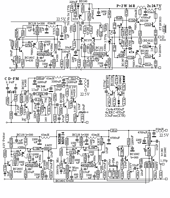

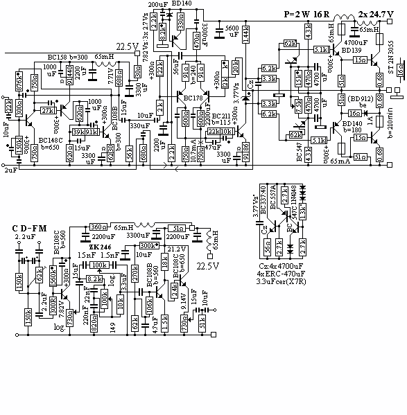

i've seen the results of this schematic program before and it does a very good job of obscuring the function of an amplifier.
Re:
1) Why is this amplifier special? Amplifier needs: good power, electronic shield, precision short connection of electronic components and secretes large heat loss.
2)Why is it better compared to other amplifiers? Only full-pure linear amplifier has a normally working control transistors and power transistors, and has a dynamic stabilization of the quiescent currents.
How does this amplifier compare to other class A or class AB amps? How much power will it create and how much heat?
There s capacitors whose value is excessevely huge
in respect of the expected purpose...
Also , 5.1K resistors in serial with the drivers base seems quite too much..
That s not the only odd things in this bizarre "design"....
