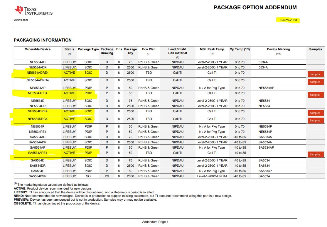

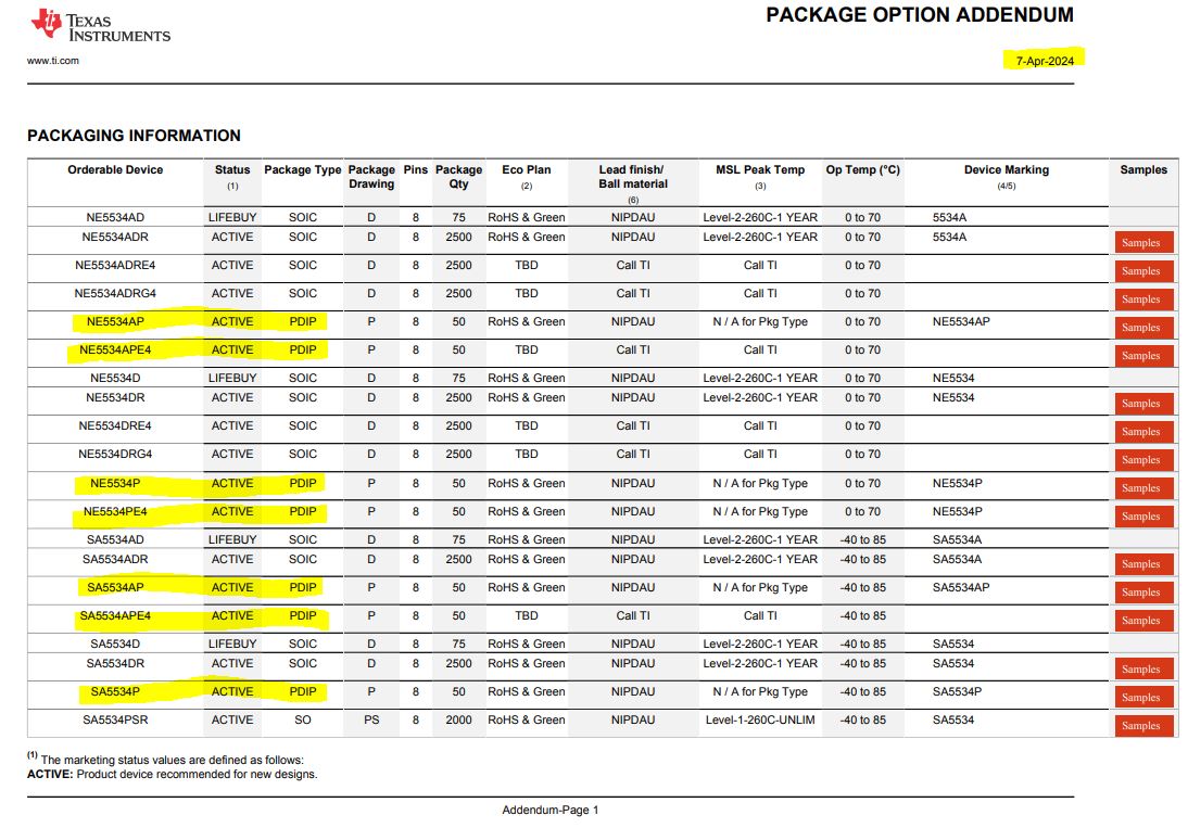

On another note I just checked both Mouser and TI both of which now show the 5534 to NOT be EOL. The datasheet was updated April 7, 2024.
I've captured earlier versions which show them to have come back in this newer datasheet. DIP are available as well as SMT.

I think that post at e2e.ti.com was either wrong or right at the time and there was a reversal. We saw the same thing IIRC in the LME49720 and '710 years ago when the DIP version went EOL. It didn't. The PDN/PCN process seems broken and confusing.
EDIT: I just saw this post within that thread:
If you compare the datasheets in post #7 the April 7, 2024 vs the November 2, 2023 the 5534 in DIP clearly looks to have come back from the dead with Mouser and DigiKey now not showing EOL.
My hunch is they did move the 5534 to 300 mm and hadn't qualified the parts when they issued the first PDN. I'm certainly happy with the outcome and I know that SSL console owners are elated.
Hello Mochizuki, The NE5534A is being redesigned to accommodate improved specs. It would maintain the same part number once renewed and no substitutes would be needed at this time.
Ore.
