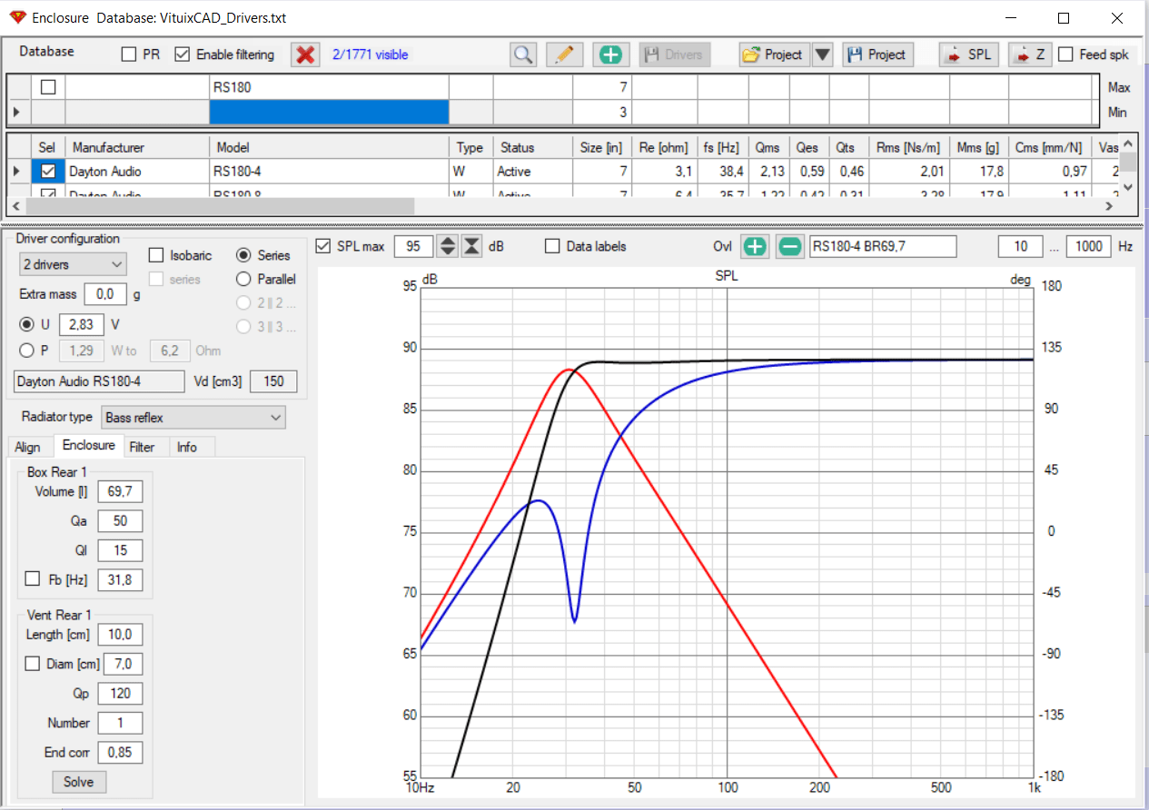

I'm genuinely interested in learning how such bass is achieved in such a small design. Modeling these drivers in software using just a normal vent means the enclosure must be 2-3 times the volume in order to achieve a -3 of 28hz.

Thanks for the replies everyone. Its greatly appreciated. From what I gathered and saw from brief images of the enclosures with no drivers in them, the midrange has a sloped rear wall, which I assume is called a tapered transmission line in this regard even though it is sealed.
In terms of the woofer loading, I'm still a bit lost on how 30hz is achieved in such small cabinet, even if one woofer is crossed over lower. The company claims that a transmission line and labyrinth are two different things. Here's a quote:

Maybe the second woofer has a second order high pass filter to raise output below resonance? Then tune the box low? It’s pretty much impossible to passively increase output below resonance, maybe they are filtering out higher frequencies above fs?Thanks for the replies everyone. Its greatly appreciated. From what I gathered and saw from brief images of the enclosures with no drivers in them, the midrange has a sloped rear wall, which I assume is called a tapered transmission line in this regard even though it is sealed.
