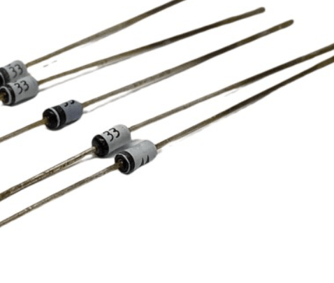

A very specific question: can anyone help me identify component from a 1980s-era Meridian Component Amplifier (MCA) Pre-amp power supply module, placed in the circuit between the generic 18v AC input and en route to an LM7805 regulator.
All indications are it’s a diode performing its role in the half-wave rectifier circuit. Made by Motorola, its designator is:
C
24
408
My Peak meter doesn’t recognise it, or it’s gone bad. I cannot find reference to it anywhere on t’internet (including old Motorola ‘equivalency’ documents that crop up) so have no idea what to replace it with!

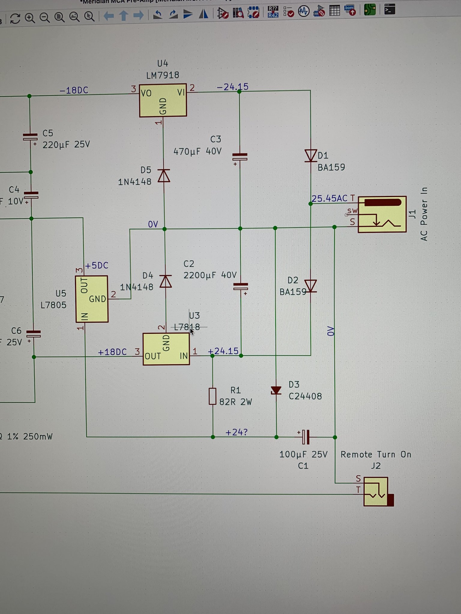

I get the feeling from looking at some of the other components that the Meridian engineers simply used stuff they had to hand - the other 2 diodes for the main positive and negative rails are BA159s rated at 1000v when scarcely 25 volts comes off the transformer secondary! Would there be a special need for a zener to be used for the additional 5v feed?
Forget "smart" meters, what does a Multimeter show in the diode scale, both ways?
To test its Zenerness, get a >40V supply, connect it to mystery component through a 10k resistor, measure voltage across it.
Inverse it and repeat.
What do you get?

Can you draw out what the circuit looks like? There may or may not be a reason for it to be a zener. Is it just a half wave rectifier? Some sort of OVP clamp? Perhaps dropping excess voltage before hitting the 7805?
I’m ’reverse engineering’ a schematic from inspecting the circuit board itself - it’s not quite ready but I think I can put up the detail pertaining to the AC input. I’ll try and post it now…
