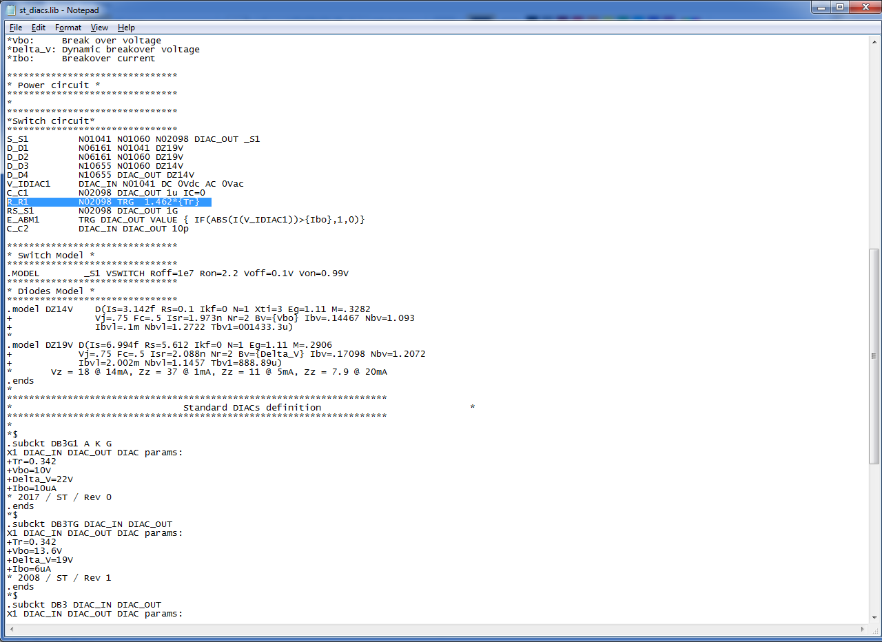

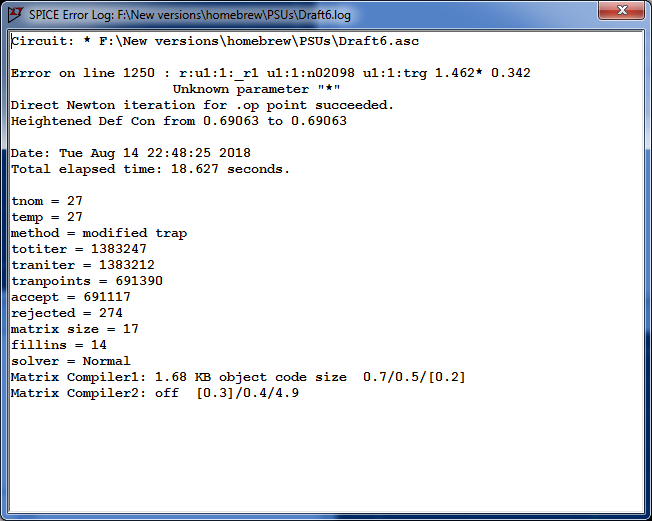

I tried to use the ST's diac library in LTspice, but I got this somewhat bizarre error message:
attachment.php
The sim ran OK, but the message popped up afterwards, and I imagine the sim didn't take into account the correcting coefficient of 0.342 pertaining to the DB3 diac (or is it the 1.462 factor, anyway there must be something slightly wrong somewhere)
attachment.php
I am no expert in spice syntax, but the operation in the line in question looks like a legit and ordinary multiplication using the asterisk symbol: 1.462*{Tr}, which should pose no problem, except that in the error message, the asterisk shows as a star.
Could it be an unicode or ASCII interpretation problem?

I intended to append the ST lib, in case, but I forgot or mismanaged something.
Here it is, in its full splendor, in case someone is interested:
Edit: somehow, it doesn't work, meaning the forum doesn't work properly, and I made no error in the first place.
Here is the text version, which should go through and be perfectly equivalent:
