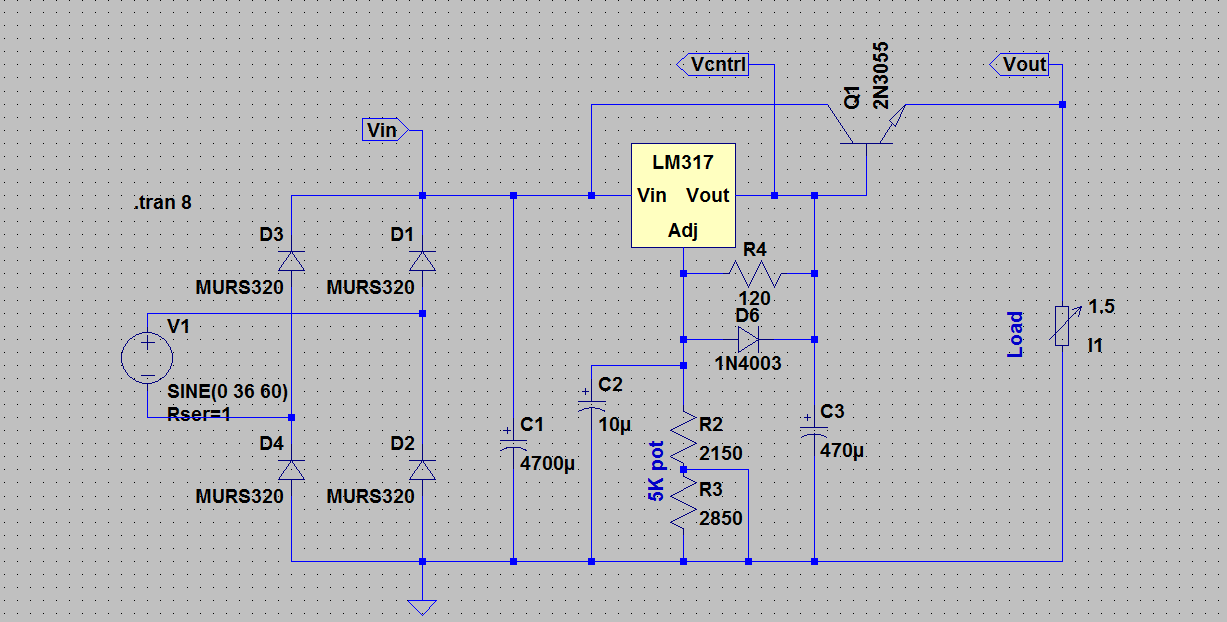

So one other question. I'd like to try a regulated PS and was thinking of trying this: Build an Adjustable 0-34 volt power supply with the LM317. I know the LM317 is supposed to be a good regulator and with the TIP3055 the current shouldn't be a problem. Would this schematic on it's own provide a pretty ripple-free output, and how would it compare to a brute-force CRC PS like I'm working on right now (sonically)? Would there be any advantage to adding CRC filtration to the regulated supply?

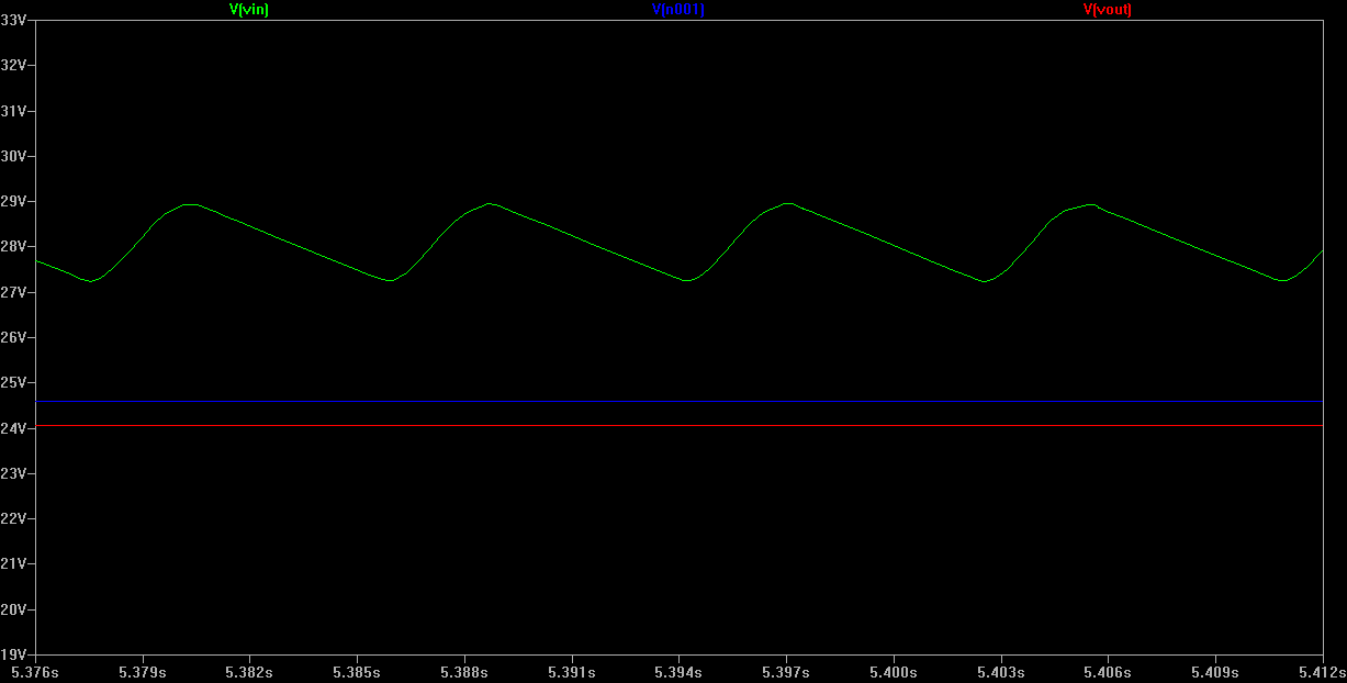

Would this schematic on it's own provide a pretty ripple-free output...
Not too bad... red is output. Adding C2 and D6 recommended. 🙂
...also consider using the LM317HV instead, 60V input vs. 40V, so you don't pop it with line voltage fluctuations like twest820 mentioned.
Thanks, and thanks for the LM317HV. I didn't know about that item. I'm also going to look at the LM338. Ever seen a LM338HV? Mouser doesn't show one. Anyway, our power is pretty stable - I've never seen it go over 122v, and after rectifier losses and resistor drops, I don't see the LM317 ever seeing over about 32-35v. But that is fairly close to the 40v max.
