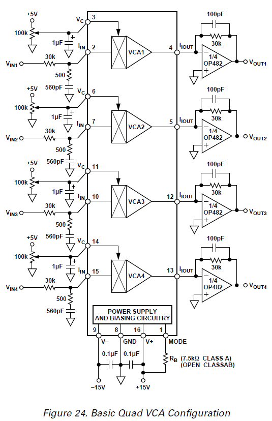

The general circuit I am implementing is shown in the attachment. It's taken from the datasheet of an SSM2164 quad VCA. I'm connecting it to single ended inputs, with the addition of ground loop breaking resistors on the signal return (shield/ground) lines.
As Andrew mentioned, in order to pair source and return you have to know where the current is flowing, including into, through, and out of the IC. The IC is so small that the "through" part is not important. You know exactly what pin that the input signal connects to. The question remains: WHERE DOES THE INPUT CURRENT GO? I have also attached the internal (simplified) VCA schematic that should show this. There are really only a couple of possibilities: input current is either flowing "out" to ground, or out one or both of the rails. Which is it???

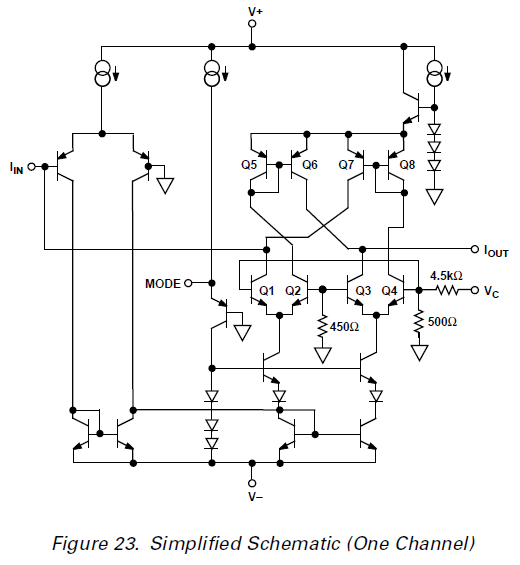

Looking at the simplified internal circuit for the VCA (it's for one channel), you can see that there is a single input pin, shown at the left. The remaining pins are ground(s) and the V+ and V- rail pins. Unfortunately I don't really have a clue how to figure out how current is flowing through this topology and where it goes.
Can someone please take a look at the internal circuit and let me know if you can identify where input current exits the circuit? I think that once I know this, how adn where to route the return track will be clear.
The current has to go back to the Source.The question remains: WHERE DOES THE INPUT CURRENT GO?
This is fundamental to ALL CIRCUITS.
When considering the Output to Load, the current has to come back to the chip, since this was the Source.
When considering the PSU, the current going to the chip must return to the PSU, the PSU is the Source.
Consider each circuit individually . Find the source then imagine the route for Flow and where you can place the Return.

Sure, sure, that much is well understood. Repeat this mantra 1000 times. Any enlightenment? No. It's the relative PATHS of the send+return that is important where noise and hum pickup is concerned. My question pertains to ROUTING on the PCB to keep the paths close and loop area low.
For my circuit implementation, the question is more about what pin of the IC the input current flows out of, and how it returns back to the source. For instance, if it flows out the ground pin, then I should take care to route that trace along side the signal line wherever possible, to keep the loop area low. This would be better than running the ground back to the star point and then back again to join the signal wire at the edge of the board. That ground path, combined with the signal path, would form a loop. Likewise, if the current is flowing to one or the other (or both) rails, through the caps of the PS, to ground and then out to the board edge I need to think about how to best route all these paths/tracks.

I understand the output current flow well, so that isn't the concern here.
Saying that the input current flows to the PS is still a bit too general. The PS is comprised of two rails and ground. Where, SPECIFICALLY, does the input current go?
What is the exact path from the IC to the board edge to the shield/return connector? Does it go through the PS or just via ground?
Can anyone say where the input current goes exactly - at what pin or pins does it emerge on the IC? There are only three possibilities: the ground pin, Vcc, or Vee. Bonus points if you can explain the input current flow in the simplified VCA (internal) circuit.

Many mixed signal devices (DACs, volume controls) and analog devices (TPA6120A, chip amps) do have GND pins, and many have explicit instructions about how their power pins are to be decoupled. It's important to follow these recommendations, but not slavishly. They can be wrong.

Many devices don't have a ground pin. That's what I said.
