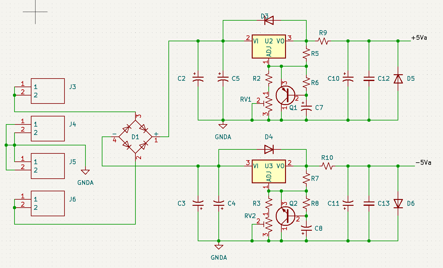

@teletype1 Something like this below, I have used the schematics from and Elektor project ( if you want value ) It is using LM317 and LM337,
This is for Analog +/- 5Volts
and for Digital +5 its a simple 7805 regulator.
J3 to J6 are Spade connectors for the Secondry to connect on the PCB
Personally, I would not connect + and - supply grounds at the power supply. I would connect them together at the load instead. Also would not use a center-tapped transformer winding. Otherwise you get common-impedance coupling between the power supplies due to both return ground currents being shared on one line. Okay for low performance designs, but I wouldn't allow that type of coupling for high performance.
HI Mark,Also would not use a center-tapped transformer winding. Otherwise you get common-impedance coupling between the power supplies due to both return ground currents being shared on one line.
please expand on this, I would like some more may be a drawing.
Also in my amp the transformer secondry for PGA VA is with 0-12 and 0-12 for the dual supply .
Hi aditya,
Please let me say a little more about how I sometimes like to design power supplies at the macro level. I often like to use positive regulators only, even for negative voltage rails.
For example, here is a power supply board with two isolated positive regulators:
https://www.ebay.com/itm/134903077968?itmmeta=01HW6D1Q6N5T6QXVX06B60A50K&hash=item1f68d99c50:g:zYgAAOSwvW5iC2Dr&itmprp=enc:AQAJAAAA4Gvoxwz/+2wiUV+l62y/OytZSsma3Ckf19u1/X/wlyXnljXE0ERY4LKRbrQ1ScnbRH4wdoNvbjxTpY9SGibTspEB472YUliGeMdIJLUXeA235Xf2Yi88xzwMJ+Pu4oFNvjT5/hTxvzK/qJqQ0TEPiy9AQIjxXXtR5rsD3fRZQXBmgpiP4Bt50NWtTLHMRG0NjFwfHuEKhfVxmw+TfXLjAtsTBGv1y2dR4g1+iHG6N1Lmnw2nnQqjIWeW2a6i/Jy4Hhw0rtuTvP/Y7ljoLJ3ITxwWxtxJ/VNHvTQmwSOBKQzw|tkp:BFBMwPOGzeFj
If I use an isolated, dedicated transformer winding to power each regulator then there is no shared ground between them anywhere. Also, each regulator has a + and a - output terminal. I only want to define which terminal will be connected to ground (or circuit common) at the load. Say, maybe, at a dac board for the output stage. For the positive opamp rail, I connect one power supply - terminal to PCB ground and the + terminal to the + opamp rail. For the negative opamp rail I tie the + terminal of the other regulator to PCB ground and the - terminal to the negative opamp rail.
This can have some advantages. First since I am using identical regulators for both rails, then I expect things like output impedance verse frequency to be the same for both rails. Some people think that having power rails with the same measured properties tends to give better sound from the audio circuit being powered. The second reason is that ground return currents for each supply are separate. Common impedance coupling happens in situations where multiple currents flow through the same resistance/impedance. Each of the currents creates its own voltage drop across the conductor, and those voltage drops all ad up. Well. having the ground voltage move up and down due to shared ground currents is just as bad has having the rail voltage moving up and down. Its the difference in voltage between ground and the rail that matters for some things.
Hopefully that clears things up a little. If any questions, please feel free to ask.
