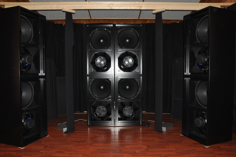

What's in a name. A dipole may use an open baffle, but an open baffle might refer to anything random or simple or aimed at those who don't want a box.open-baffle systems
@AndrewT, I've experienced moderately good levels from open 15"s EQed to 20Hz, driven to xmax by 50W (96dB/W/m).
Celestion did a dual 15" bass driver that achieved sufficient LF drive to augment one of their 6/600 speakers.
That was four 15" drivers with massive power to extend the frequency response of the little 5", or 6", drivers in their near full range 2ways.
I did that a few months back. Beyma 15P1200Nd drivers, so they could move some air. I saw 30mm p/p cone travel when the bass went low - kinda scary. That was at a couple of hundred watts per side.
The people that use Eminence Alpha/Beta-15 drivers are, I suspect, missing LF headroom.
Chris
Adding a few more might help...
Source: http://www.diyaudio.com/forums/multi-way/142015-my-open-baffle-dipole-beyma-tpl-150-a.html
Ain't enough...Adding a few more might help...
