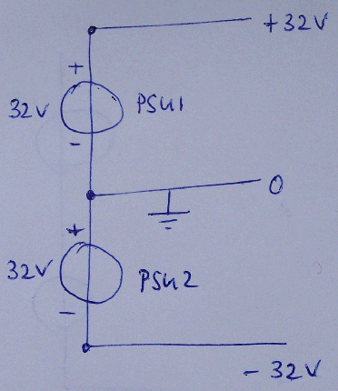

It says the power requirement is DC 32v-0-32v. What does this mean vs. just plain 32v DC. I want to run it on 12v battery power.
Could I use a simple 12v to 32v DC converter? Or is there some special significance to the voltage requirement being listed this way (32v-0-32v)

When you see "32v-0-32v", this means the circuit requires a symmetrical supply. This is basically two 32v supplies in series with the midpoint of the two supplies being the ground reference.
If you want to use 12v batteries you will need 4 in series (6 in series might be too much for this IC).

See below for a graphical representation of what theAnonymous1 wrote.

You'd need two DC/DC converters, or one with symmetrical outputs.
But a thing to beware of is the power consumption of the amp you are using. Simple DC/DC converter(s) are pretty limited in power output and won't be able to supply the amp with enough current.

build a transformer, rectifier and smoothing capacitor dual polarity power supply.
Ignore that >150W guide for PSU capability. That's equivalent to >2.3A
You need a supply that can deliver a continuous rating of 120 to 240VA. It must also be able to supply transient peak currents approaching 20Apk if you use two 8ohm speakers fed from +-32Vdc.
Note the 35-0-35 limit noted on the PCB. This is a worst case maximum voltage rating. Do not exceed it even when mains is running at maximum tolerance.

Thanks for the info. Seems like a 32v-0-32v amp isn't practical for battery power as the whole point is portability and ease of charging with 12v.
