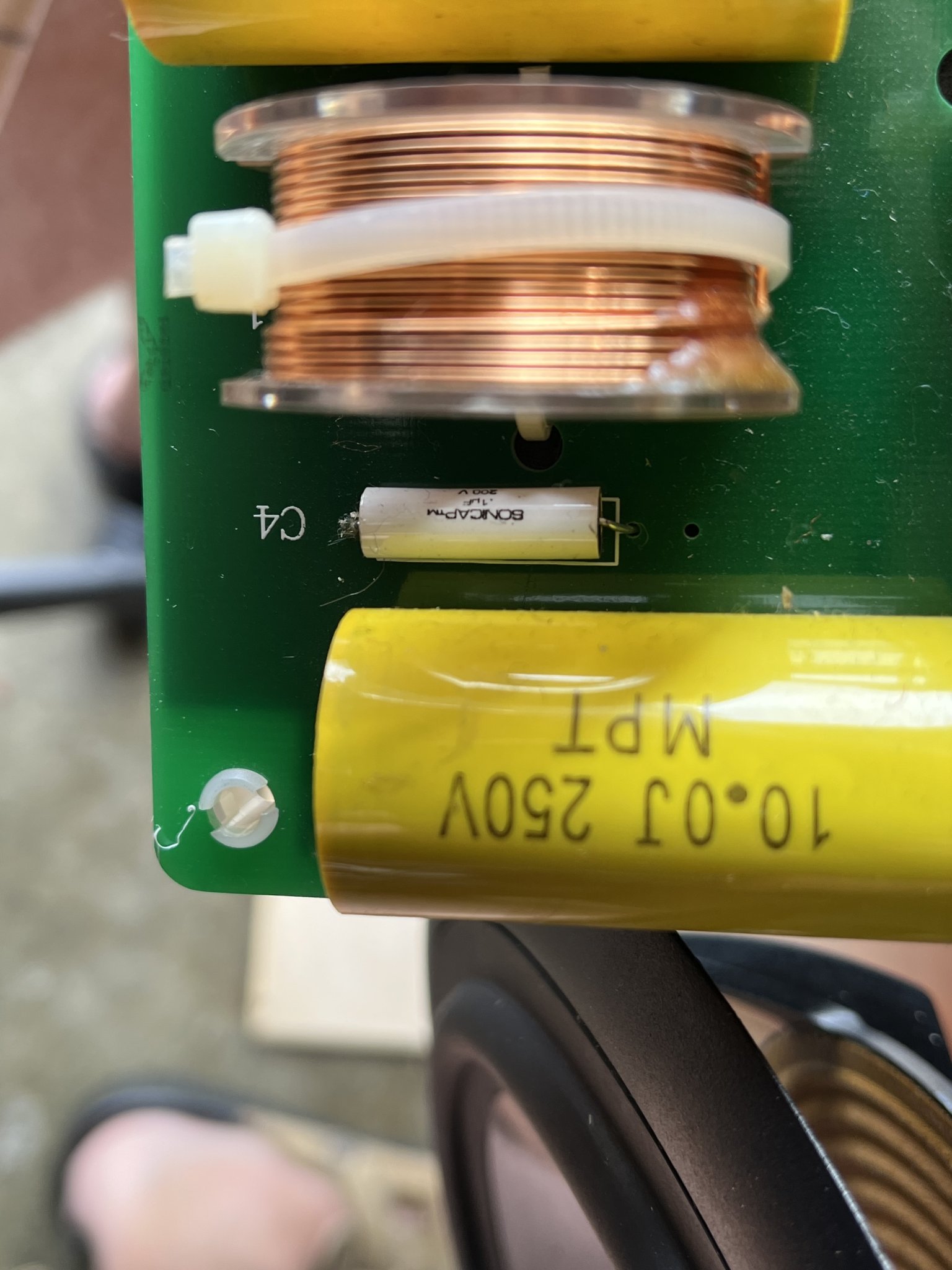

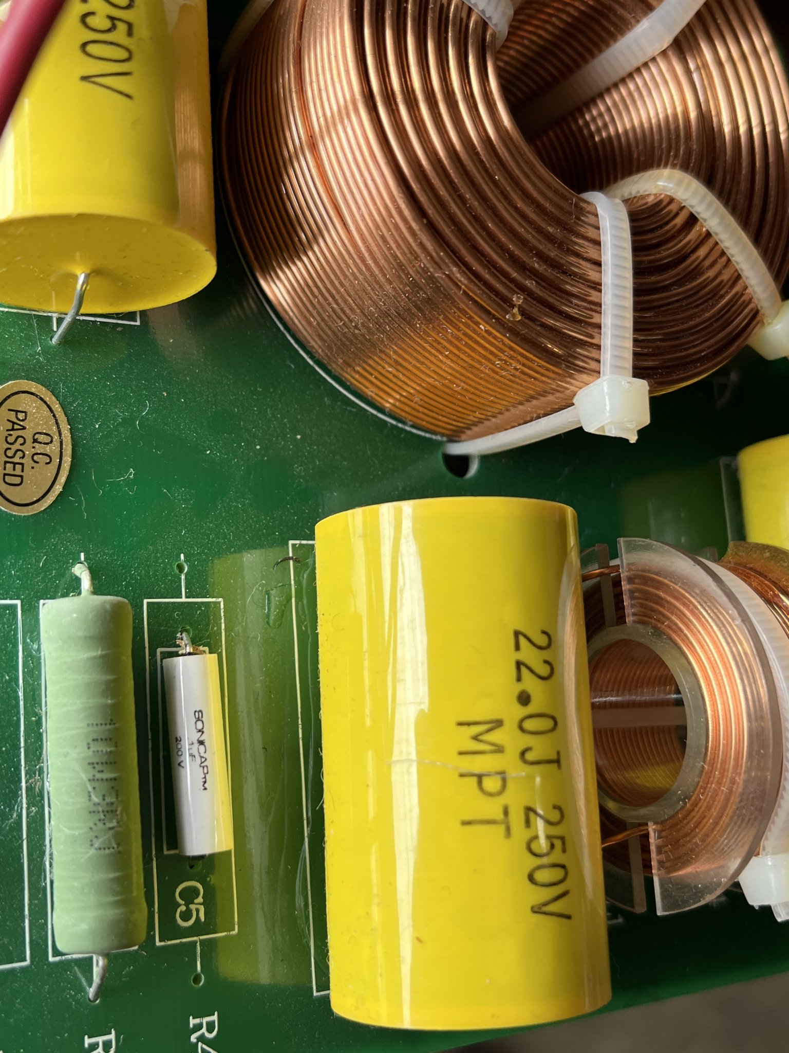

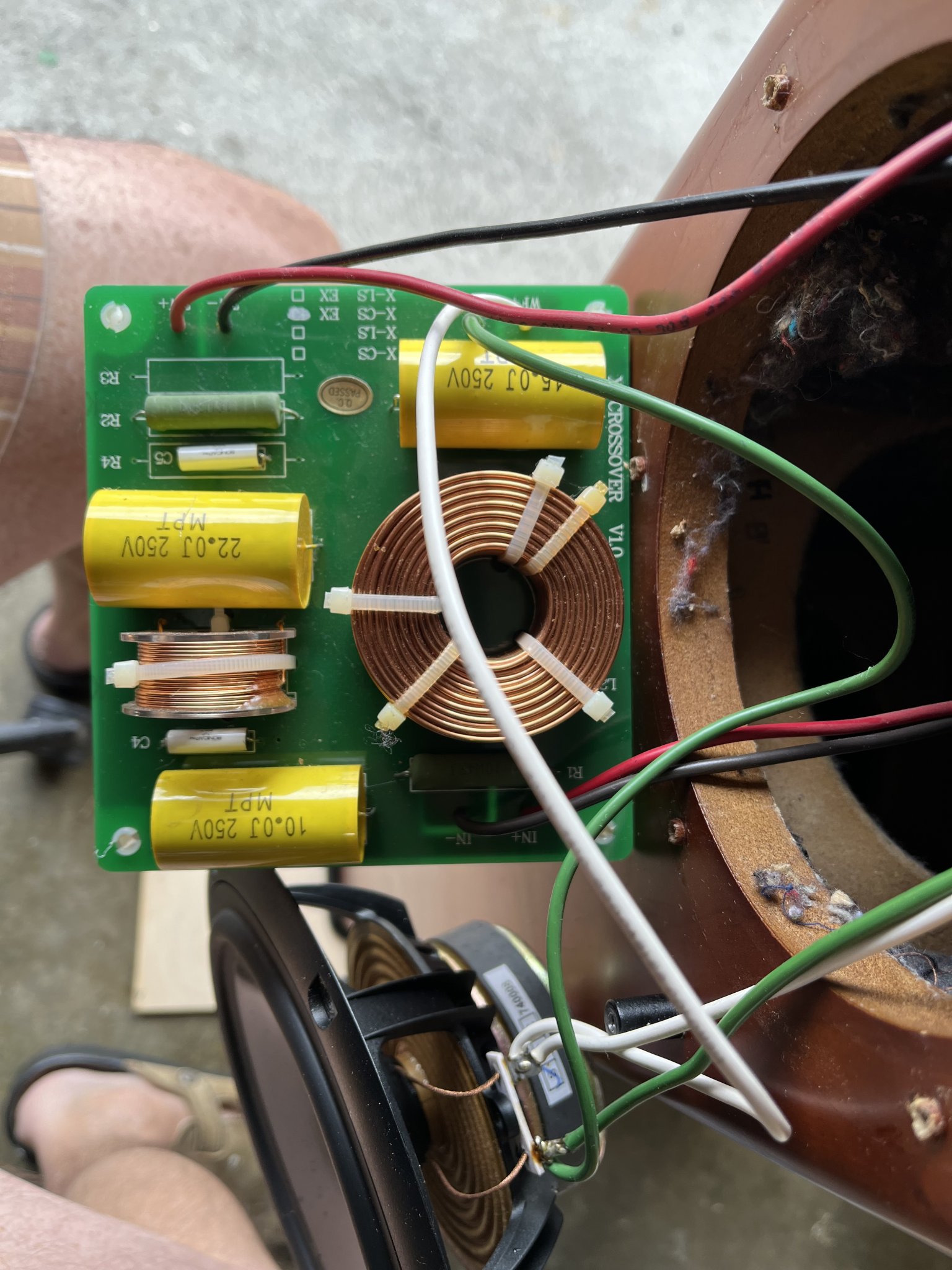

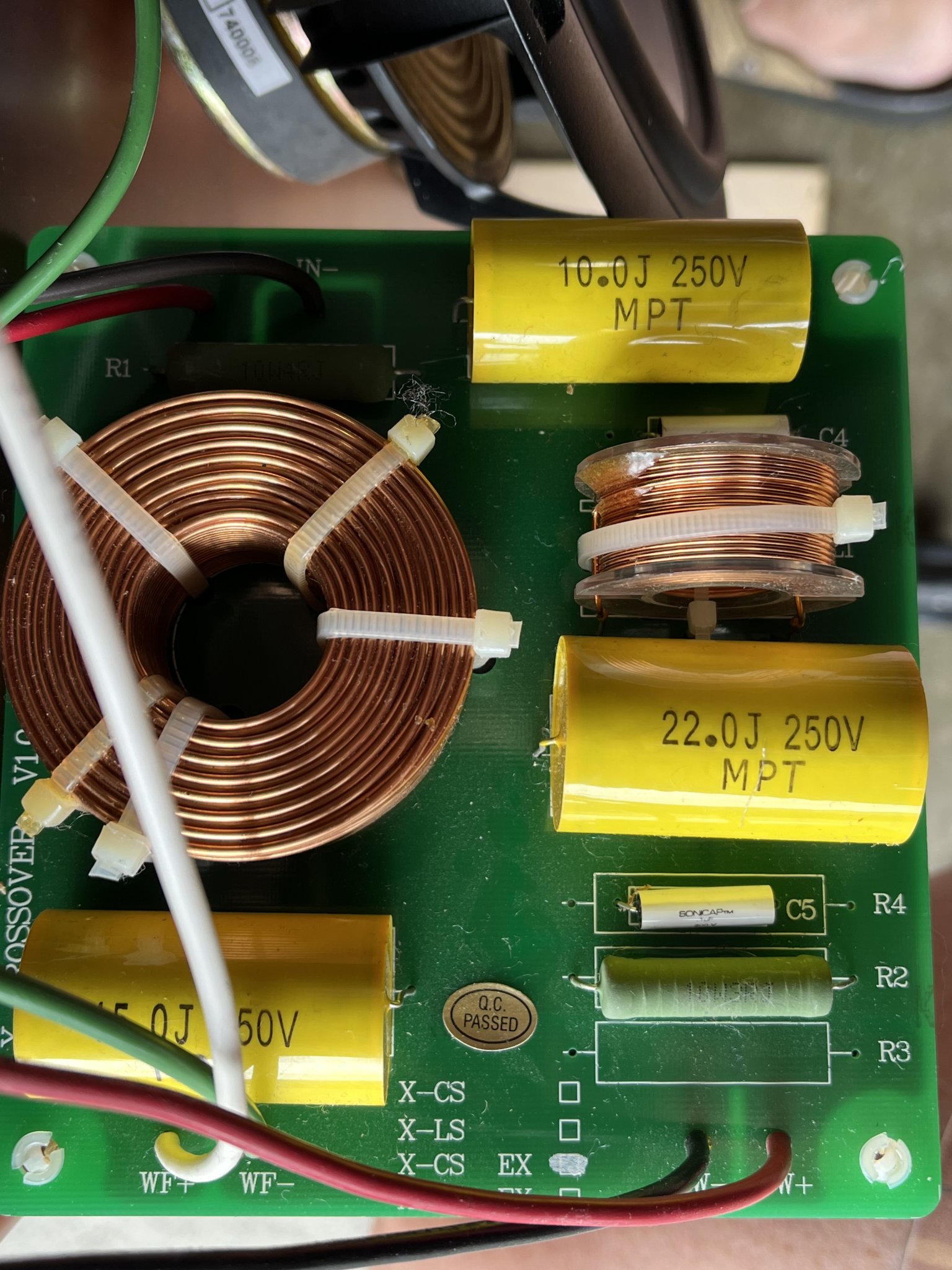

Hear are photos of the crossover, I can't find a schematic online, for practice I was going to make my own once I get a full idea of the project. There is an app for it!
As I get more into the speakers, I may have to replace 2 of the woofers, I noticed marks in them, not cuts or tears. Not sure of the impact on sound yet.
Holy Cow Tom! Increasing my vocabulary, making me look words up, awesome!! Polypropylene dielectric capacitors! This is turning out to be pretty cool, thank you for the info.
Along with the caps: mpt 22.0j 250v, mpt 15.0j 250v, mpt 10.0j 250v ; there are 2 10W3RJ resistors and 2 1µF 200v sonicaps.

Check the resistor values for drift/open circuit.
The capacitors are polypropylene.
This is a well built crossover for cheap speakers.
Not sure you should mess with it at all.
