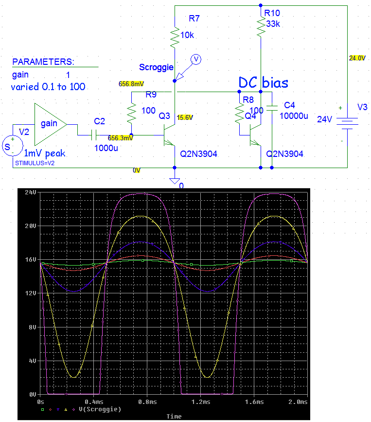

Just thinking aloud, since BJTs are current driven, current linearity should be the main parameter concerning transistor linearity and distortion.
If a BJT is used in a current-driven circuit then current linearity matters. Many BJTs are used in voltage-driven circuits where current linearity does not very much matter at all because the BJT is hugely (but predictably) nonlinear. There is a rule of thumb for BJTs: the peak signal level on Vbe in mV is equal to the second-order distortion in %.
... rule of thumb for BJTs: the peak signal level on Vbe in mV is equal to the second-order distortion in %.
Thanks. I see where it is coming from but I had never seen it stated so clearly.
Prof Cherry argues that all our devices are Charge Controlled. The BJT is "special" because it has a large and non-constant leakage on its charge. Much BJT design works to make it not-matter how much leakage a given BJT has.
I think I originally saw this in Foundations of Wireless, by Scroggie+Amos. Once you know this, it makes you smile when people try to make low distortion 'feedback free' amplifiers with BJTs. Every BJT is horribly nonlinear, but because it is reliably nonlinear we can use feedback to make very linear amplifiers. The only other way is to use distortion cancellation (e.g. balance) but that only deals with half the distortion.

The thumb-rule is more than good enough for crystal-balling. The 8-digit idiot gets these numbers for a jellybean with zero NFB. Input in peak volts. Output is 5-harmonic THD.
0.03mV = 0.11% --suspect numeric noise
0.1mV = 0.1%
0.3mv = 0.23%
1 mV = 0.8%
3 mV = 2.3%
10 mV = 7.7% --not symmetric
30 mV = 21.6% --very bent
55 mV = 23% --gross
100mV = 29% --flat
While these numbers say THD%<mVpk, any external load will raise the THD.
Q4 et al is a bias supply to avoid diddling the bias manually. I biased DUT Q3 at 2/3rd rather than 1/2 because I knew it hardly matters for small output and at big output the wave would be big bottomed. I gimmicked the base-cap out and the numbers do not change.
