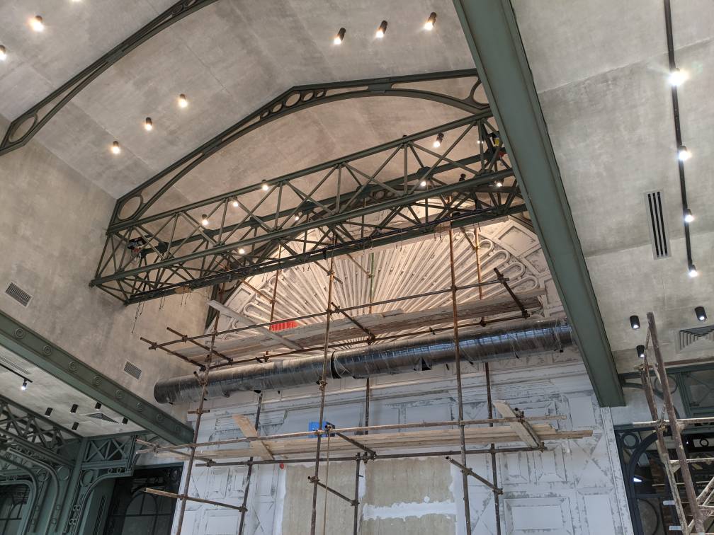

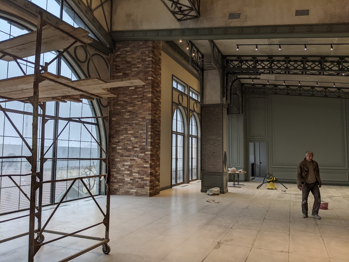

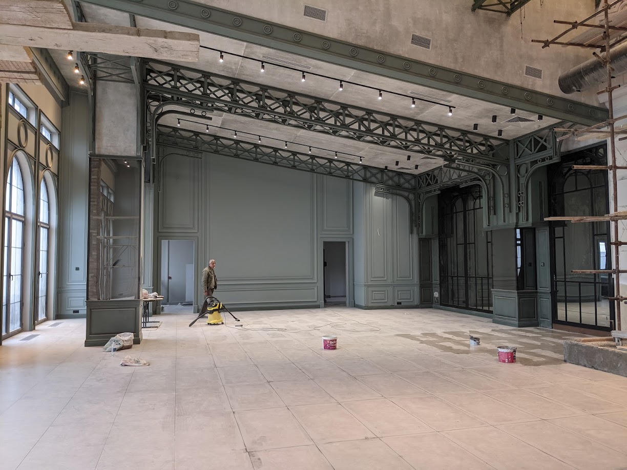

The room is 17 metres from front to back and 23 metres left to right with the lowest part of the ceiling height 5m closer to the stage with it inclining to 9.6m to the back of the hall. It is intended for live music as well as DJ, it a wedding hall.
I am considering toeing in the speakers to criss cross the room, to get later reflections from the opposite side walls which might or might not have diffusion on the wall. The back is glass in the middle and on the sides concrete but I will fill up on that part of the back wall with heaps of absorbtion.

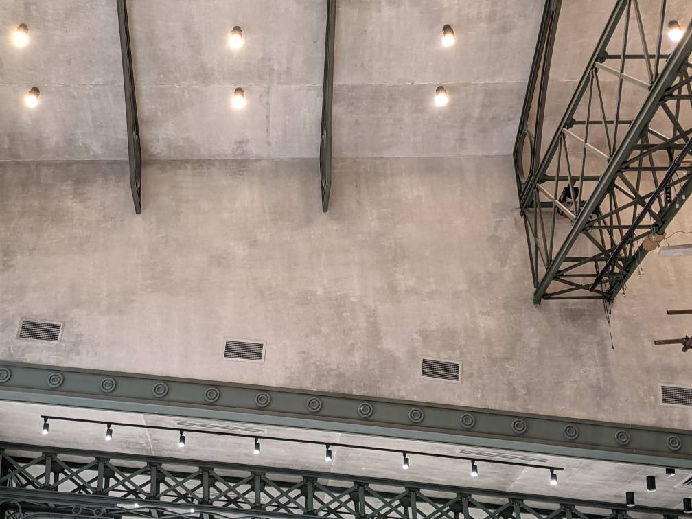

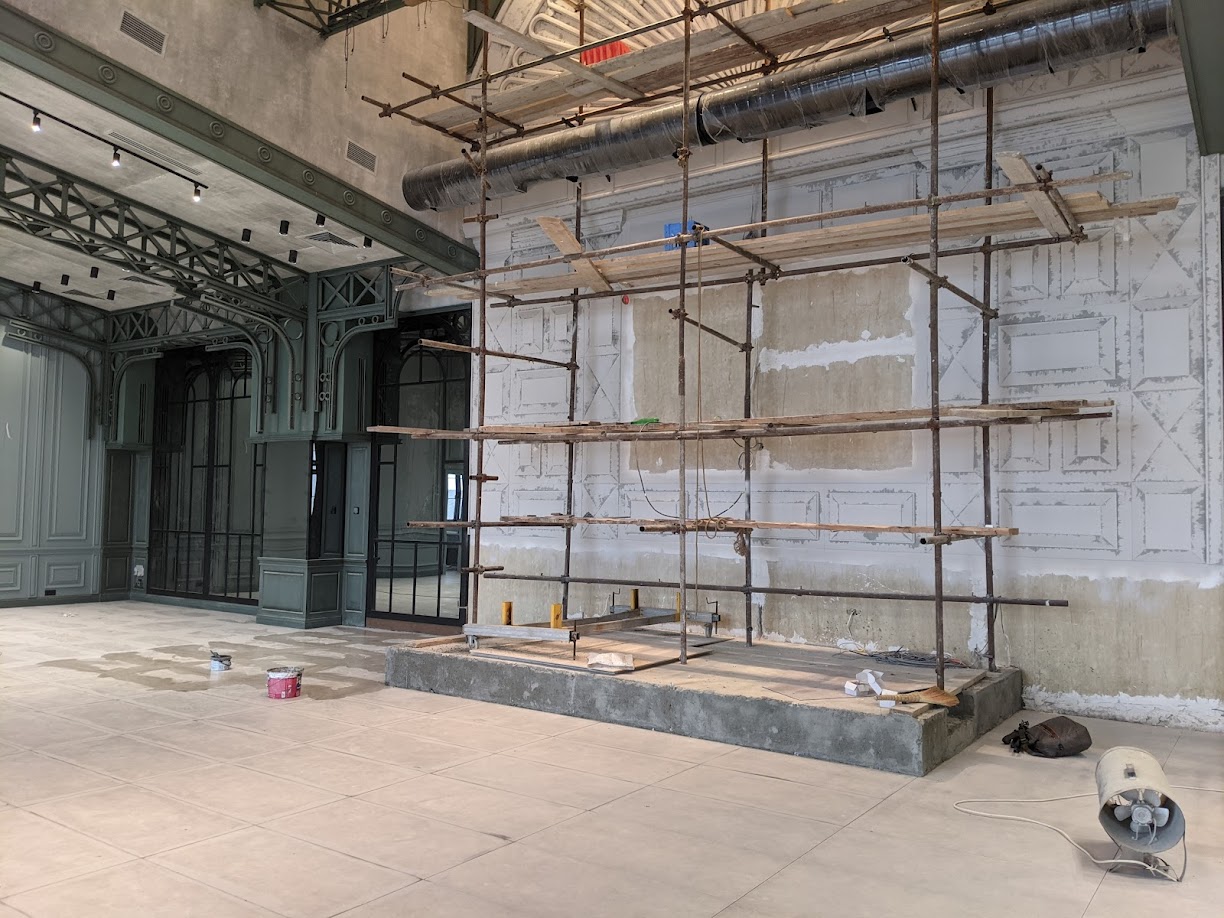

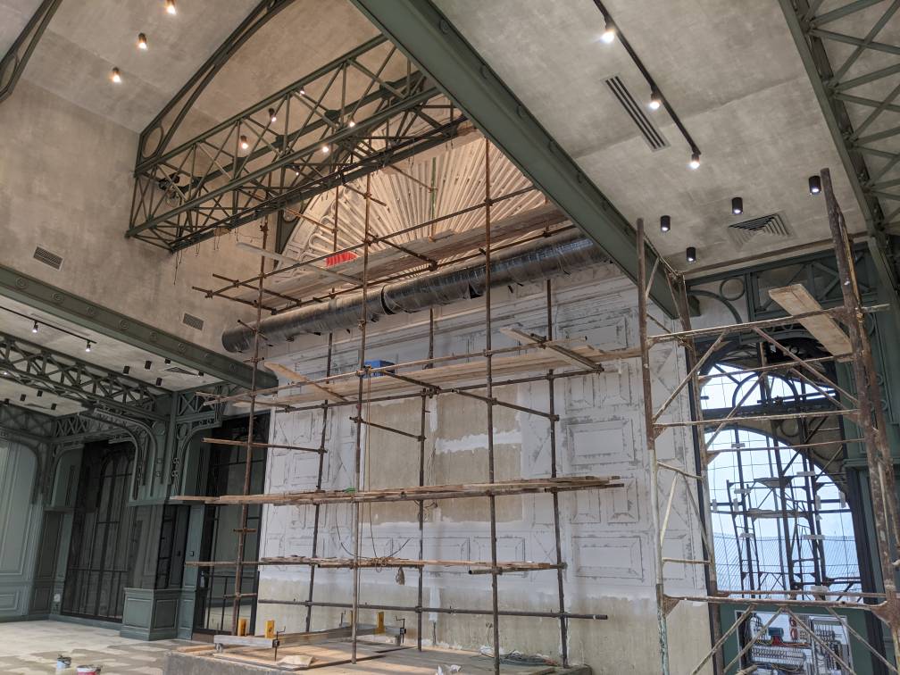

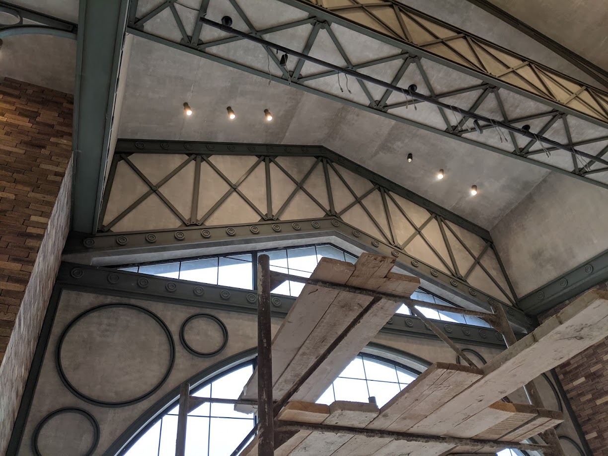

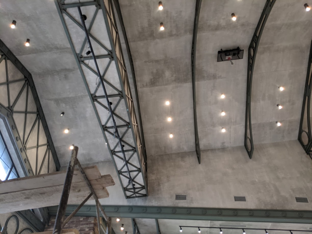

Ive attached pictures perhaps seeing them would make it more cut and dry.

Trdat the pictures don't show the stage location clearly is it under the vaulted portion of the ceiling ?

The vaulted ceiling starts from the stage and tappers up to the back wall. It is a 3m portion in the middle between two lower sides. The front part that is on top of the stage about 5 or so meters high and it tappers up to about 9m at the back."it's a constant curvature array, they cannot be arranged as a line and therefore don't behave like a line." i think Conanski needs to explain this statement a little further...or get out more...
The first photo attached gives you an idea of how the high ceiling is above the stage in the middle. The second is the middle part of the vaulted ceiling from front to back the third photo is the back(higher) part. While the last photo is a wider picture of the front part.
