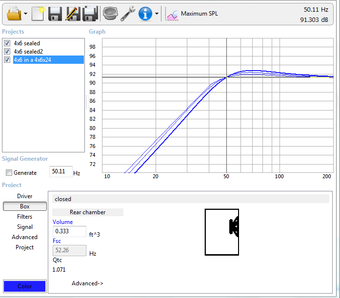

I happen to have been window shopping those drivers and modelling them in winISD. I just got a dayton dspK+KE for dsp so I'm dreaming of future budget projects. It's 30 bucks plus 25 one time for a programmer board. I'm a complete noob so take it all with a grain of salt!

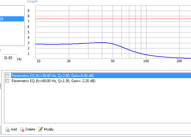

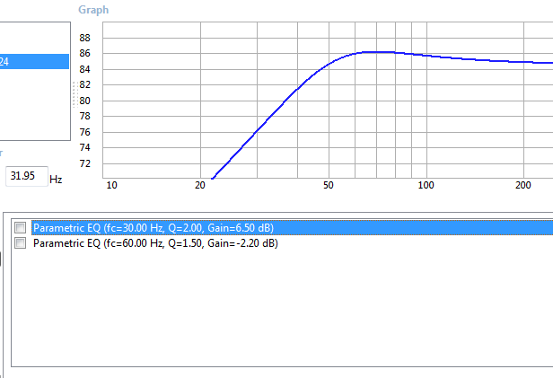

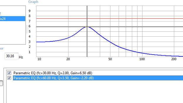

A sealed box extending 24" back from the driver faceplace (6x4x24 internally; it was a convenient dimension to imagine) has only a mild peak at 70 hz to eq out, and can be flattened to ~32hz with 6.5 db of boost at 30 hz, q of 2. If I got the power calculations right, that takes 4.5x the power, so I entered 25w/4.5=5.5w signal in winISD. (Insert picture of dog at desk, because I don't know what I'm doing here. But I figured I had to compensate for the boost EQ somewhere, and this is it?)

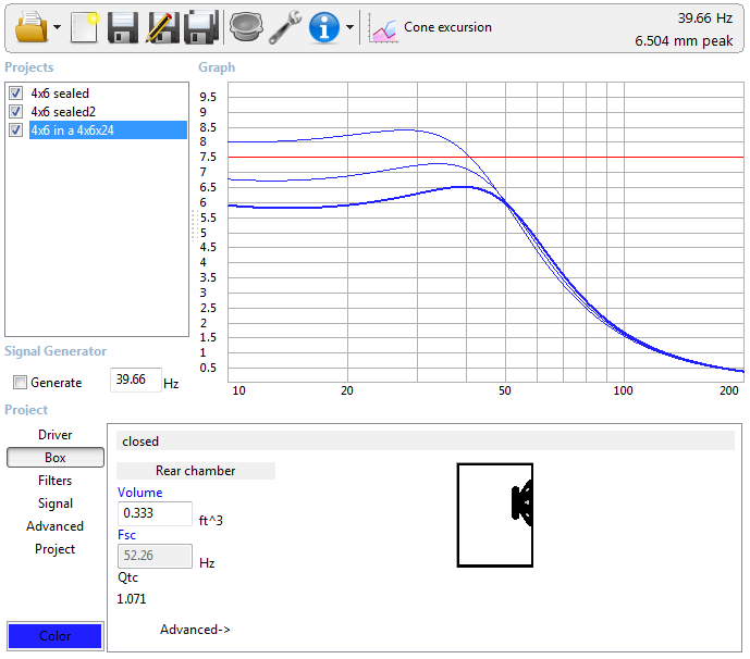

It gets an f3 of about 32hz, 83db at power limits, and is nowhere close to excursion limited at any frequency, so no high pass needed. 2 in parallel with (2x volume) gives a reasonable 3ohm-ish load if your amp is 2ohm stable; and should gain 6db?

The power handling seemed to indicate these wouldn't do real subbass at a nice level with any reasonable number of drivers even with all dat excursion.

Unequalised max spl in 0.33ft3/9.4l (described above), 0.5ft3/14l, and 1ft3/28.3l. Bigger than 1/2 a cubic foot needs a highpass filter.
