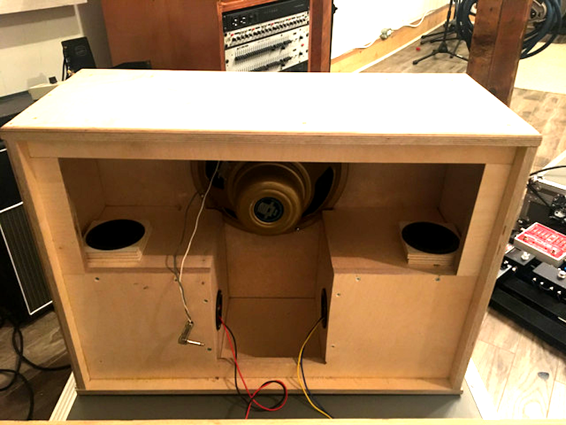

In my build the coaxial speakers are housed inside ported sub-enclosures built into the overall structure of the cabinet. The dimensions of these are based on measurements from the DIY audio speaker volume calculator.
Here’s what the rear of the cabinet looks like:
I’ll admit the build quality is pretty sloppy, but this was just intended to be a prototype. In any case...it’s not performing very well.
The guitar speaker sounds fine, but the hi-fi speakers are off. They’re thin and brittle yet somehow also boomy and congested in the lower mids at the same time.
I used a measurement mic to try correcting the response of the coaxial speakers with the DSP and that helped, but I still suspect something is very wrong.
I’m looking to totally redesign the cabinet for the next prototype and I really want to get it right this time!
I’m not really sure how to reach out for help on this, but I hope this project is interesting enough for some experienced members to offer their input on how I could improve the performance of the hi-fi speakers.
Thanks for any and all feedback on this build!

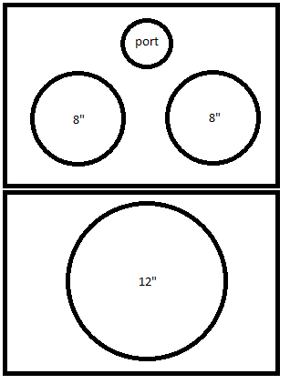

I don’t know much about guitar amps and to what degree it can be used for hifi but with a flat response I think you have a small 2.1 boombox concept going on here.
I think the first error here is the bass reflex pointing upwards into the box.
Secondly I think I would’ve made two similar sized boxes instead: one for the 12”, another for the two 8”. Gives you more flexibility for future and more volume for bass on the 8 making it closed back.

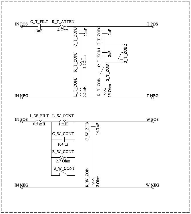

I used the Eminence PXB2:2K5CX crossover which seemed to be recommended for the Beta-CX and ASD:1001 combo, but in the future I would consider an active crossover and bi-amp setup. I've heard some FRFR designers claim that custom crossover points are essential for a convincingly flat response.

With larger guitar speakers, things like rear mounting, the proximity to the edge of the cabinet baffle and floor are no big deal, the diffraction and resonance caused by those sharp edges and a 3/4" deep duct around the speaker surround add "character".
Flush mounting the co-ax drivers would reduce some of the peaks and dips caused by the above.
Mounting the co-ax drivers at the top of the cabinet (flipping the cabinet over) and directing it at your ears would help the upper response clarity. The on axis response of the drivers are fairly rough to start with, the off-axis response is probably worse. The fixed center to center distance of the co-ax also presents comb-filter problems between the pair and the 12", compounded by the time delay (around 1.75 ms latency IIRC) inherent in the DSP, even before the additional latency added by any digital effects processors.
That said, I suspect those issues may still be small compared to the polar response of the open back speaker combined with the pair of the ported speakers. Try sealing the back of the cabinet and see if that clears up the boomy and congested sound.
Edit: the ports in their present position are not a problem, but if the back of the 12" is sealed, their exits would have to be moved to the front or sides of the cabinet to be useful.
That said, having built a dual Alpha 8 ported guitar cabinet with port tuning options, I preferred the sound of it sealed.
What is the Fb (box tuning frequency) for the 8" ported cabinets?

that's a cool and well made cabinet. 2K5CX's 2mH/10uF lowpass might muddy things up somewhat. (?)
Could the rear cavity be acting with port output to bump things up in the 100-200Hz range?
Eminence's old "generic" 3K5 network used around 1mH and maybe 10uF (?) that gave ~2K8 crossover with Beta8cx
and APT50
Rkondra used the following - like 0.5mH. and a 15uF/8R Zobel. (am not sure what his notch filter is supposed to oo - ?)
and APT50

I hadn't considered this but it makes a ton of sense, especially if that crossover is used more commonly with the 10" and 12" Beta-CX.2K5CX's 2mH/10uF lowpass might muddy things up somewhat. (?)

This is definitely my first port of call for the next prototype. I've been using the cabinet mounted slightly off the ground and this seems to help for the clarity issues.Mounting the co-ax drivers at the top of the cabinet (flipping the cabinet over) and directing it at your ears would help the upper response clarity.
I was worried about this and I suspect that there is some comb filtering between the dry speaker and the coax boxes, but there isn't too much cancellation when the effects signal is 100% wet. At most, the latency amounts to a couple of extra ms of pre-delay on the reverb for example.The fixed center to center distance of the co-ax also presents comb-filter problems between the pair and the 12", compounded by the time delay (around 1.75 ms latency IIRC) inherent in the DSP, even before the additional latency added by any digital effects processors.
I hadn't considered this either and it seems like the most probable culprit to my gut instinct. When I go back to the drawing board I might try building a pair of freestanding cabinets at the dimensions I intend for the box interior and see if I can get those to sound a bit flatter.That said, I suspect those issues may still be small compared to the polar response of the open back speaker combined with the pair of the ported speakers. Try sealing the back of the cabinet and see if that clears up the boomy and congested sound.
I suppose I'll have to calculate that with some software? I'm planning to pick up the Eminence Designer app soon so maybe I can use that.What is the Fb (box tuning frequency) for the 8" ported cabinets?
