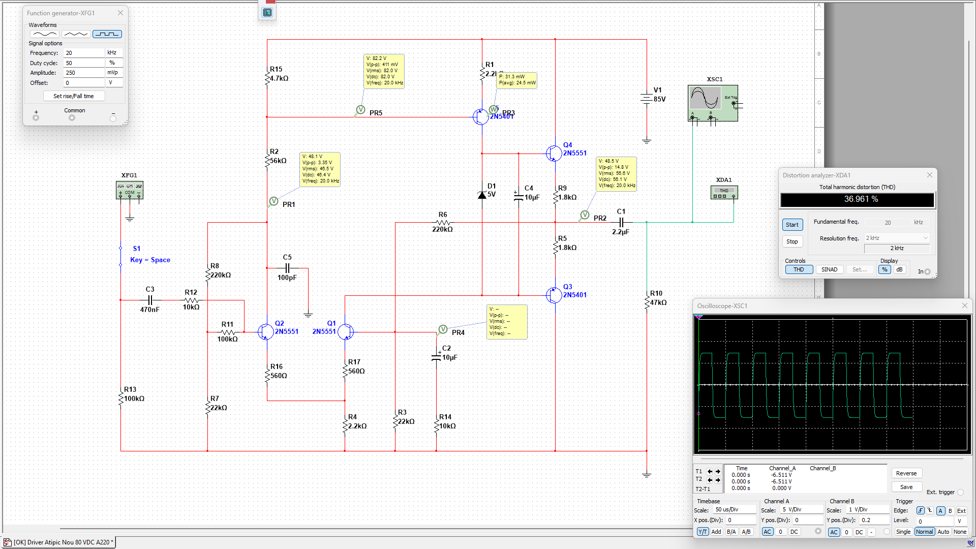

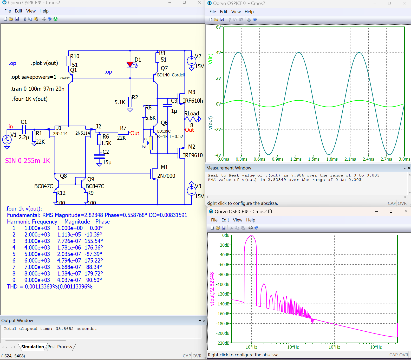

Unconventional Audio Frequency Amplifier
Becuase my knowledge permits me I decided to create something more unsual and experiment a circuit that has main goal to amplify audio and not to work as a computer square wave bufer. This pushed me to keep the amplifying stage as close as possibile to class A operation where I could and optimal class AB where I could not.

That is not true at all and there is no reaseon for it, I build it this morning and now I am listening at it. I would appreciate if you could name a instability isue, provide an argument to your claim. The design sounds verry good, I listened for 2 hours now, I finished it at 8 PM this morning.

No problems, and it beats all the Harman Kardon amplifiers I had, or Crown Pulse series that try to implement a symetrical signal amplification. I started exploring audio diy with Crown schematics and they are verry complicated, now to be more serious simple is the best way and by this I mean achive the best quality with the most simplest path.

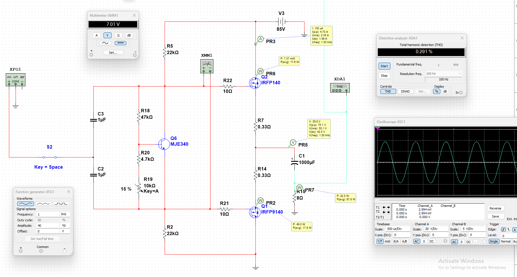

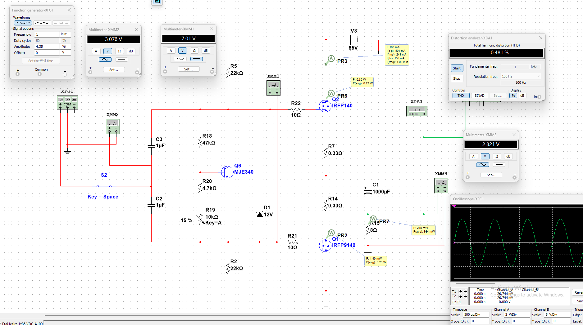

Here is the simulation at 2,83 Volts Rms on output. I had the bias at 15 mV on both 0,33 Ohms resistors with no noticeable problem, and now it is 20 mV for comparing but from what I see not the same thing as BJT that benifit alot.

I like your output mosfet stage. It reminds me my experiments with bjt output buffers. Even i used symetrical power supply, i put cap on output simply to eliminate small dc always changing due to temperature drifts.
Can you post 1 watt sine wave sim?
What bias is best?

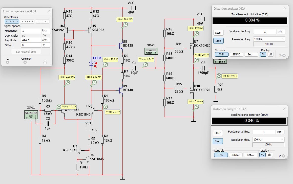

Here is my unconventional preamp. Inspired by @radu2326
What is good is there is no need for compensation caps.
It is stable.
With my very simple power stage using EXICON Lateral MOSFET.
Output from preamp is only THD 0.004%
Output from power stage is THD 0.046%
The level at output is 8.0Vp-p = 1 Watt into 8 Ohm.

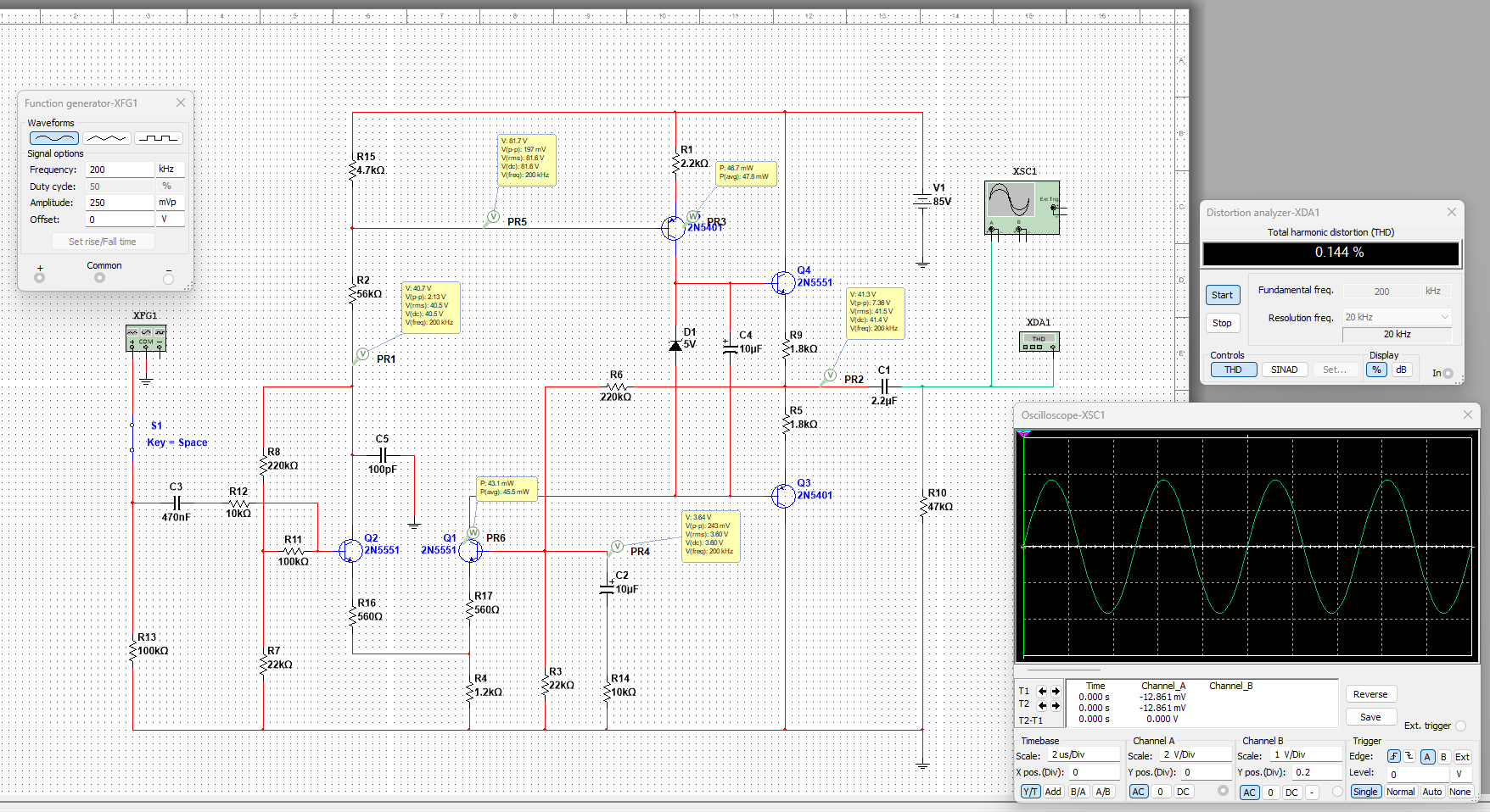

I just tested now harmonic distortions at 200 KHz and the result is impresive 0.145 % THD, the schematic is like I made it practicaly and has R4 1,2 KOhm and this doubles THD, I used 1,2 KOhm to have the right bias.

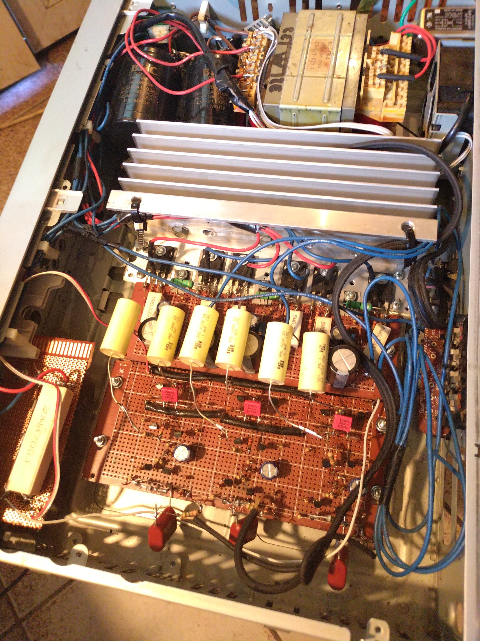

radu2326, thanks, i may build your mosfet output stage. Not immediately, since i started few speaker projects, but maybe in a week or two.
How big is the heatsink?
I suppose q6 mje340 is on the heatsink too, to provide temp sensing.
Can you post the pics?
Just curious.
First do not forget about ading a 12 Volt Zenner diode across Q6 MJE-340 and yes Q6 on heatsink and also use a blue multi-turn trimer for fine ajustment. Below is a picture with another driver board but the same output stage as in the schematic, I change the driver board but output stage remains the same all the time. The heatsink is for 3 chanel or 6 Mosfets and I have it ventilated not directcly on fins but a fan blows out silently the hot air if there is.
