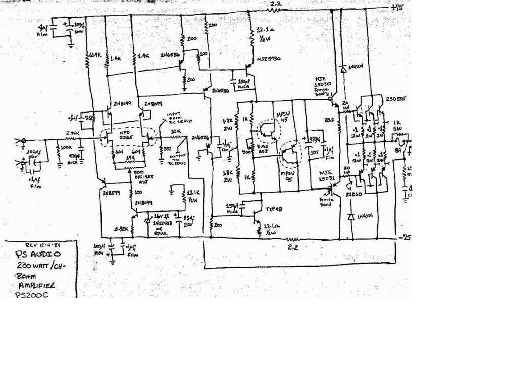

Hi folks,
I'd like to convert this amplifier to balanced inputs (XLR), in the hopes of increasing its CMRR and making it more resistant to ground loop noise.
Would it be possible to bring a phase negative input around to the right side of the JFETs and mix it in without have to add another buffer stage?
I would appeciate any thoughts, and especially specific ideas as to the needed circuit changes.
By the way, the "input from DC servo" is another 10K resistor from a TL-081 based DC servo, so the after-the-op-amp gain of the DC servo is the same as that of the NFB loop.
Thanks,
Paul

he he he you make it sound like ground loops are a balanced input issue .....
well its not ....actually is more ground loop techincues and more about grounding properly .... a balanced door will not change much if your installation is poor ....
PA expirience says so ....but this is just my opinion .....
What do you suggest for grounding, then? Should I be breaking off ground pins on most of my equipment's power cords?

Try a simple check to find how much of your units have earthed their power supply 0V node, with a ohmmeter. Place one of test leads on the earth contact of the mains cable plug. Place the other test lead on the shield of signal input sockets. Make a scratch on a paper: place a dot for each input shield point and for each mains earth point. According your measurement results, draw lines between dots which are shorted. Then you can see any existing gnd loop on the finished scratch. Remember that, avoidance of gnd loops between multiple connected units has the same value like the star point in power supplies gnd node.

No, no, i am not suggesting a single outlet. I suggest only, the earth of outlets being like a star point. In your case it is not possible because x-over and PS amp. have earthed their 0V supply node. Make a simple external experiment. Place insulating tape (of course temporarily!) over the earth contact of the mains plug of x-over unit in a such way that its chassis is not earthed more. Check it with the buzzer. Be carefull that the x-over chassis is not in contact with any other unit chassis. Try your system again, and check if the noise dissapears. Let me know the result.
Fotios
probably a lot easier to add an external isolation transformer, you can buy an XLR adapter with transformer inside. Be sure that your connections do not join pin 1 and chassis.

It's that third point I am looking for. Any recommendations on tranformers... especially ones built into panel mount XLR jacks?

It seems to me that it's equally easy, electrically-speaking, to convert to unbalanced at the Behringer end or at the PS Audio end of the connection, but converting at the PS Audio end still gives me the better noise immunity along the way and there is much more room physically to mount a tranformer or diff amp circuit inside the PS Audio.
For now, the noise level is acceptable, though I am not happy with the ground defeated on the amp. I am going to try some other possibilities in terms of how I connect the shield at the crossover end of the connection and see whether that allows me to reground the amp... I may also play around with the grounding inside the amp to see whether there are some other options there to better separate signal ground from chassis ground.
In the longer run I expect that I'll add some XLR's to the amp with, most likely, LME49710's acting as diff amps to convert to unbalanced and feed into the amp's regular unbalanced input. This is similar to what I plan to do inside the Behringer; there I'm planning to use LME49720's to strip the 2.5V DC offset from the DACs and pass the DAC's differential output straight out.

I have to agree with everyone else, forget the balanced input and sort out the grounds.
My system has one ground at the input to the amp, all other grounds are removed to remove any possible ground loops.
Just as bad as a ground loop is no ground at all !
One ground = no problems.
nigelwright7557 said:I have to agree with everyone else, forget the balanced input and sort out the grounds.
Which one did you keep, then? I would assume it would be the chassis ground, because of the safety factor.
So, did you just leave the patch shields/grounds unconnected at the amp end and just run the center/signal wires through?
To be clear, with the bass amp I have:
ground between the amp and the crossover twice = left channel patch cable and right channel patch cable
ground between the amp and the household wiring through the grounded power cord
internally the left channel jack shield connects to the left channel PCB at the point where there is a jumper wire that connects to the ground point of the right channel PCB. From there, a jumper goes to the center grounding point on a 1/2" by 1/8" copper ground bar. That center point is also where the ground wire from the power cord, and the center taps from the transformer, connect. The copper ground bar wraps around to the right and left inside the case to provide the ground connection point for the speaker out binding posts. The case is connected to the grounding bar in a couple of places where they're screwed together for support.
Just connect the the signal grounds to the zero volt line and not the chassis.
I have one earth from the mains which goes to teh chassis and then is connected to the amp input zero volt line in one place.
