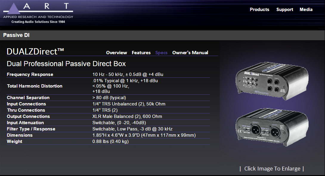

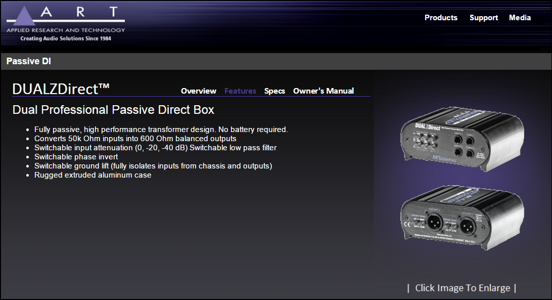

Instant economical solution - ART DualZDirect 2 Channel Passive DI Box
The polarity switching is handy.
This one is passive and there are powered versions available.
Standard equipment in the PA industry.

Television headphone out or line out into DI will work and sound perfectly fine.
Just need DI box, two XLR extension cables, 3.5 stereo plug to dual 6.5 mono plugs, or dual rca to dual 6.5 cable.
RCA female to male mono 6.5 adaptors are available easily and would allow use of standard 3.5 stereo to Dual RCA, or 2RCA to 2RCA cables.
This approach is dependent on using DI box galvanic isolation which is a good thing in this case to keep TV generated/radiated hash out of the audio.
The DI box I mention has 30kHz LPF on the outputs which may be useful in addition to the usual ground lift switching and attenuation, polarity switching is a good bonus.
According to specs there should be essentially no deterioration in sound quality, and indeed may sound nicer than an active solution.
Drew, this is a quick and easy and economical passive solution that would work perfectly fine, and for less than $100 total and 5 minutes to install/configure, this would be my first choice.
