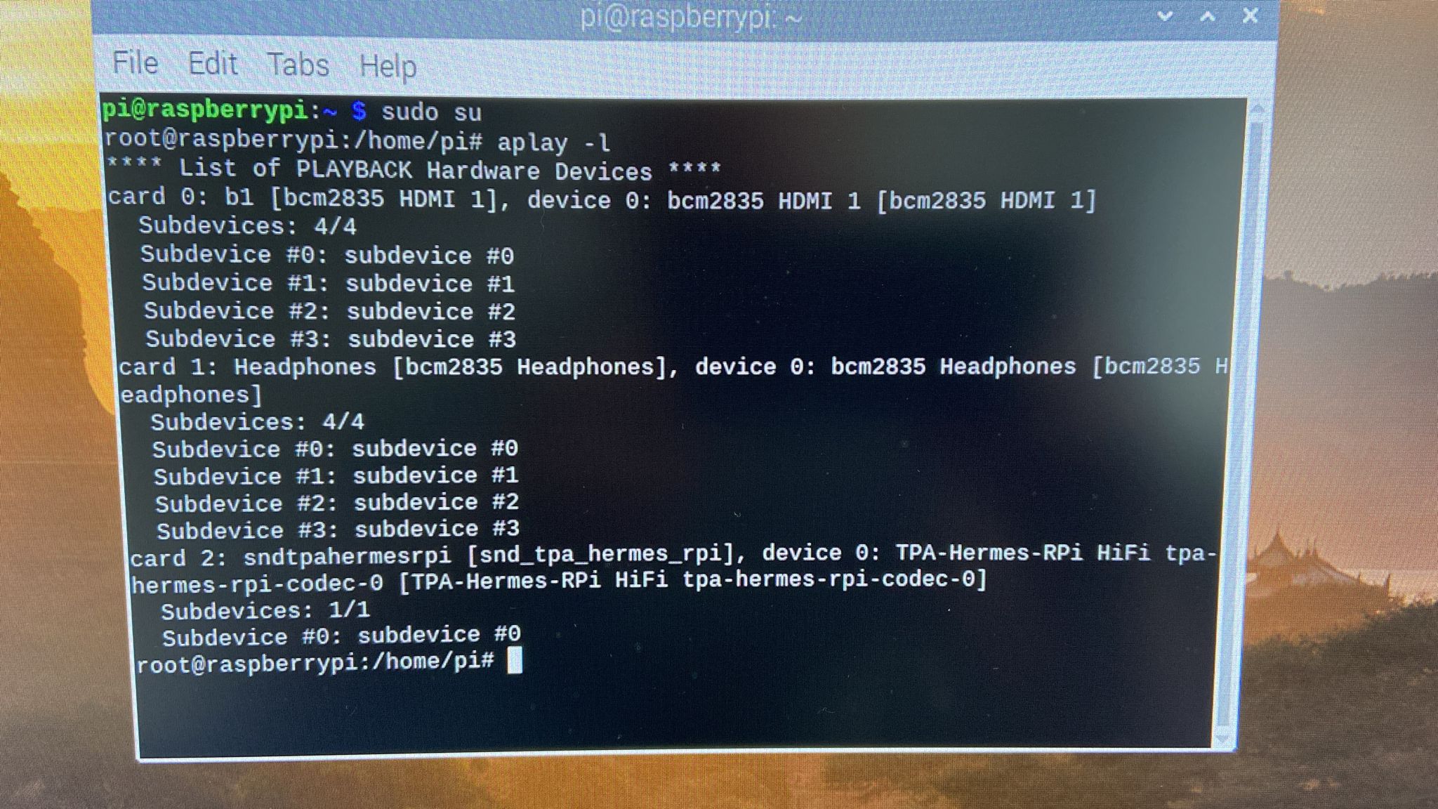

We have tried to install the software on the Volumio platform again with an extra eye on the kernell headers but it didn't succeed.
Than we've tried with Raspberry PI Debian OS and the installation was successful indeed.
So the TPA (Miero) software is not suitable for Volumio or vice versa.
