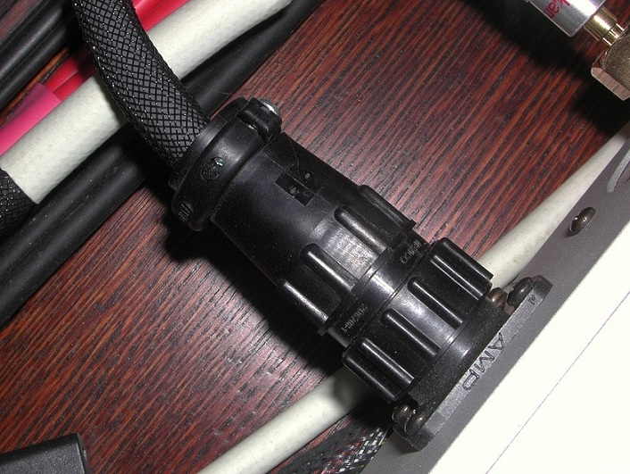

I used Tubelab's PCB and only had the power transformer remote since the board makes it convenient to hang on to the caps.
I used a 9 pin Amp circular plastic connector to mount the power tranny on a separate enclosure, and I ended up needing all 9 pins to do it. I had some hum and needed to run a separate ground for the CT, and fortunately I had one extra conductor to do it. I originally had the transformer CT grounded in the PS chassis, all the grounds in the amp chassis tied together and one conductor tying the two chassis together. I ended up with the CT on one umbilical conductor and the chassis grounds on another.
The gory details are here:
http://www.diyaudio.com/forums/tubelab/184051-reducing-filament-hum-tubelab-se.html
I had a piece of Belden 9 conductor cable, but you can easily use separate wires in braided sleeving, just make sure the wire insulation voltage rating is adequate (600V rated wire for B+ conductors)
The Amp circular plastic connectors (CPC series) are affordable and are available in several shell sizes, sexes, pin counts and tin plate or gold plated pins. Also make sure your live power supply side connector is sockets to avoid the potential of having live voltage on pins when the connector is disconnected (assuming you want a connector). The pins for these require a crimper.

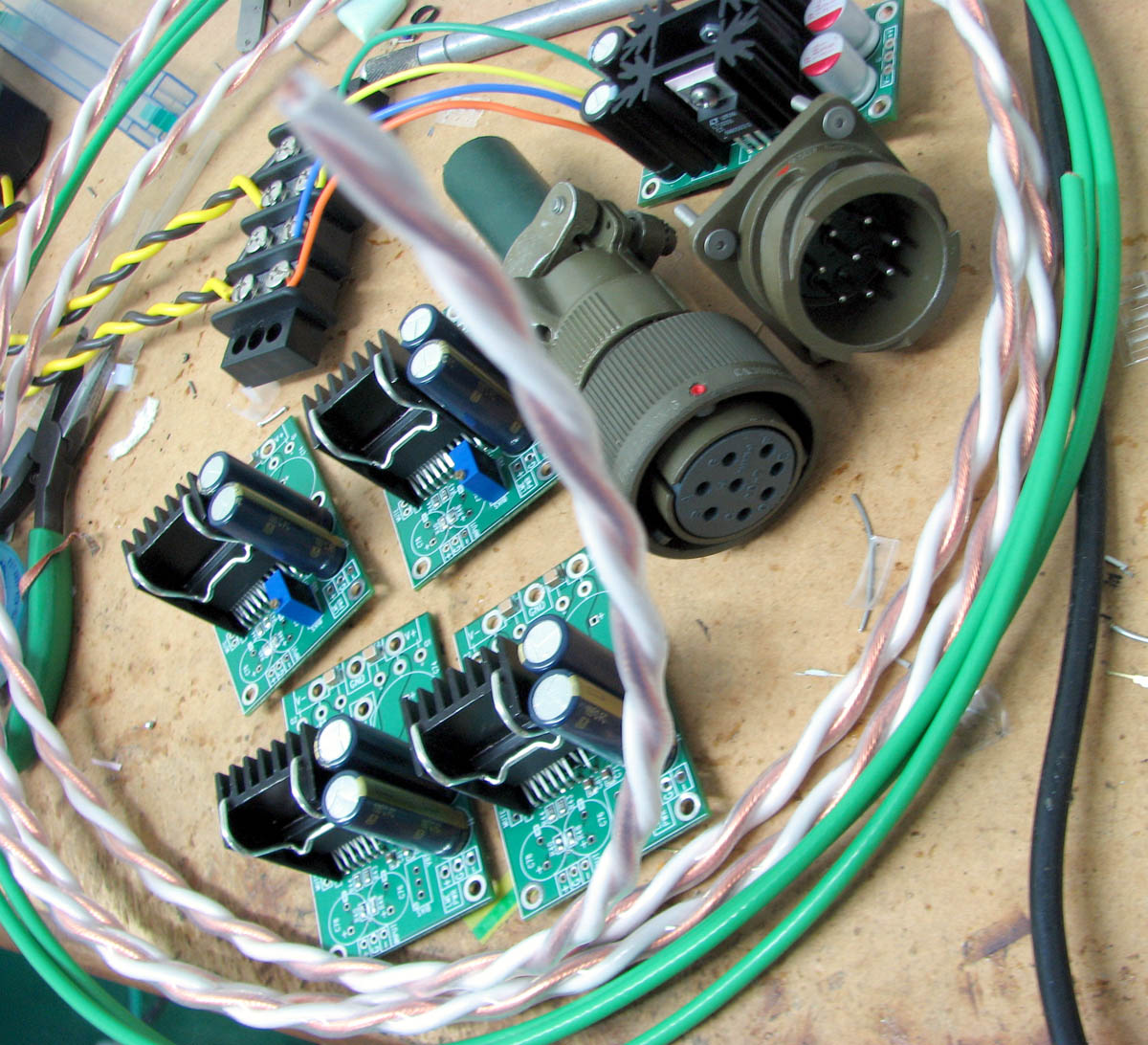

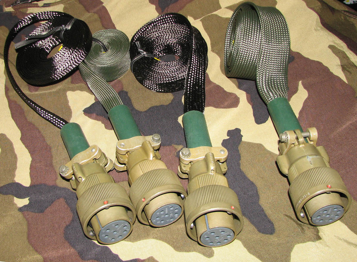

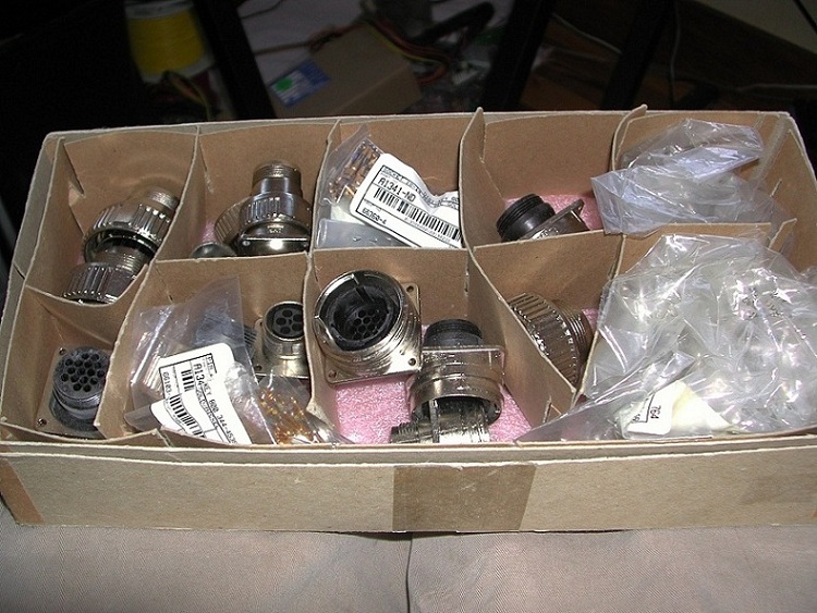

if youve got the budget and a fetish for milspec connectors you really cant go past the ITT cannons

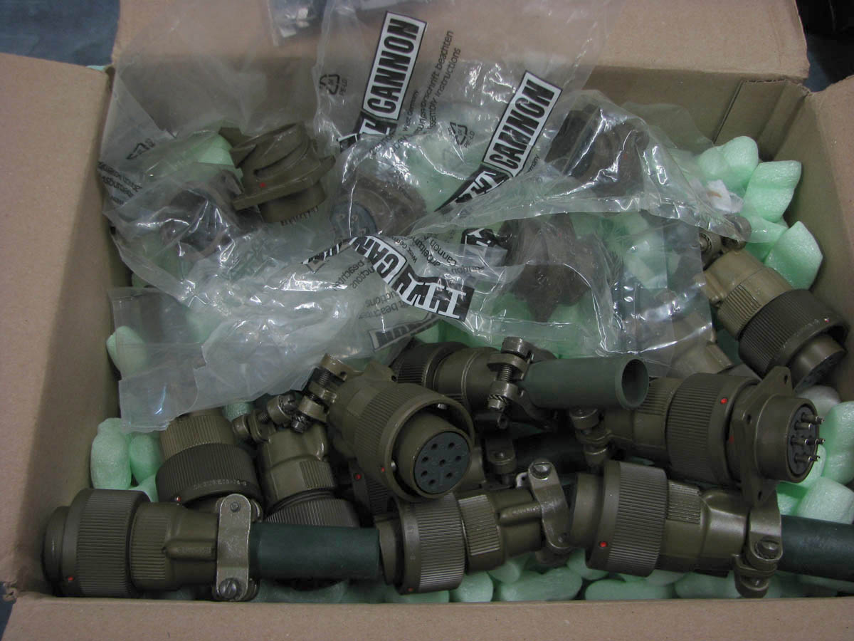

yep, i picked up a box of the above for a song from the FS section here @ 100EU for 10 x cable mount and 7 x panel mount, gotta be happy with that. they still make that model, nearly 140ea and ~50ea respectively at Farnell =) I like the amphenol too, but not as much as the Cannons. the Amphenol are more readily available than the ITT as the ITT have export restrictions.
I use the Amphenol hybrid Dsub mixed signal umbilical connectors too, very nice.
