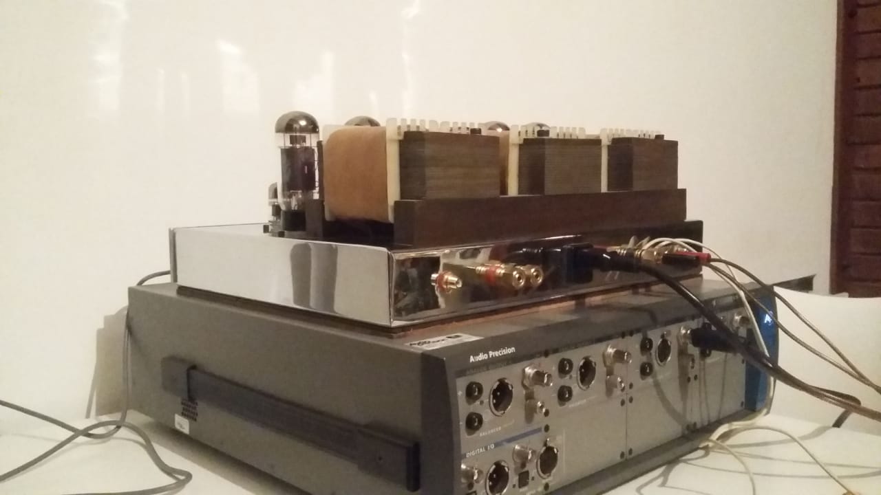

We made the measurement with AudioPrecision APx52x, which has a maximum sweep speed of five seconds between Fmin and Fmax (CC up to 80Khz). we noticed that the faster we did the sweep, the higher the response peak close to 10Hz. A while ago I did a sweep with a function generator direct on the transformer and noticed that if the frequency change is very abrupt from a subsonic value (practically DC), when the frequency reached a value such that the transformer would come out of saturation, a small peak voltage in a half cycle appears ... I'm seriously thinking if the problem lies there ... and seeing to narrow the band through low frequency even more.

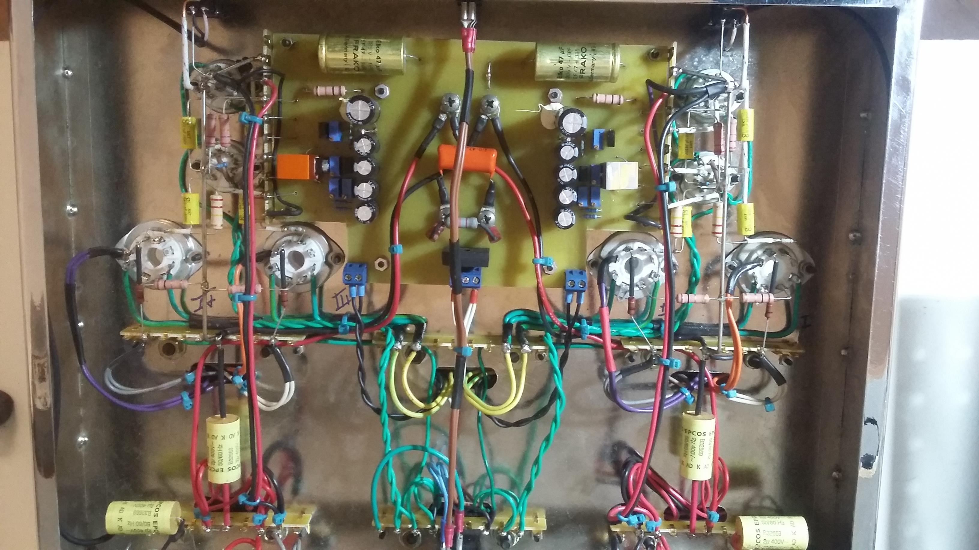

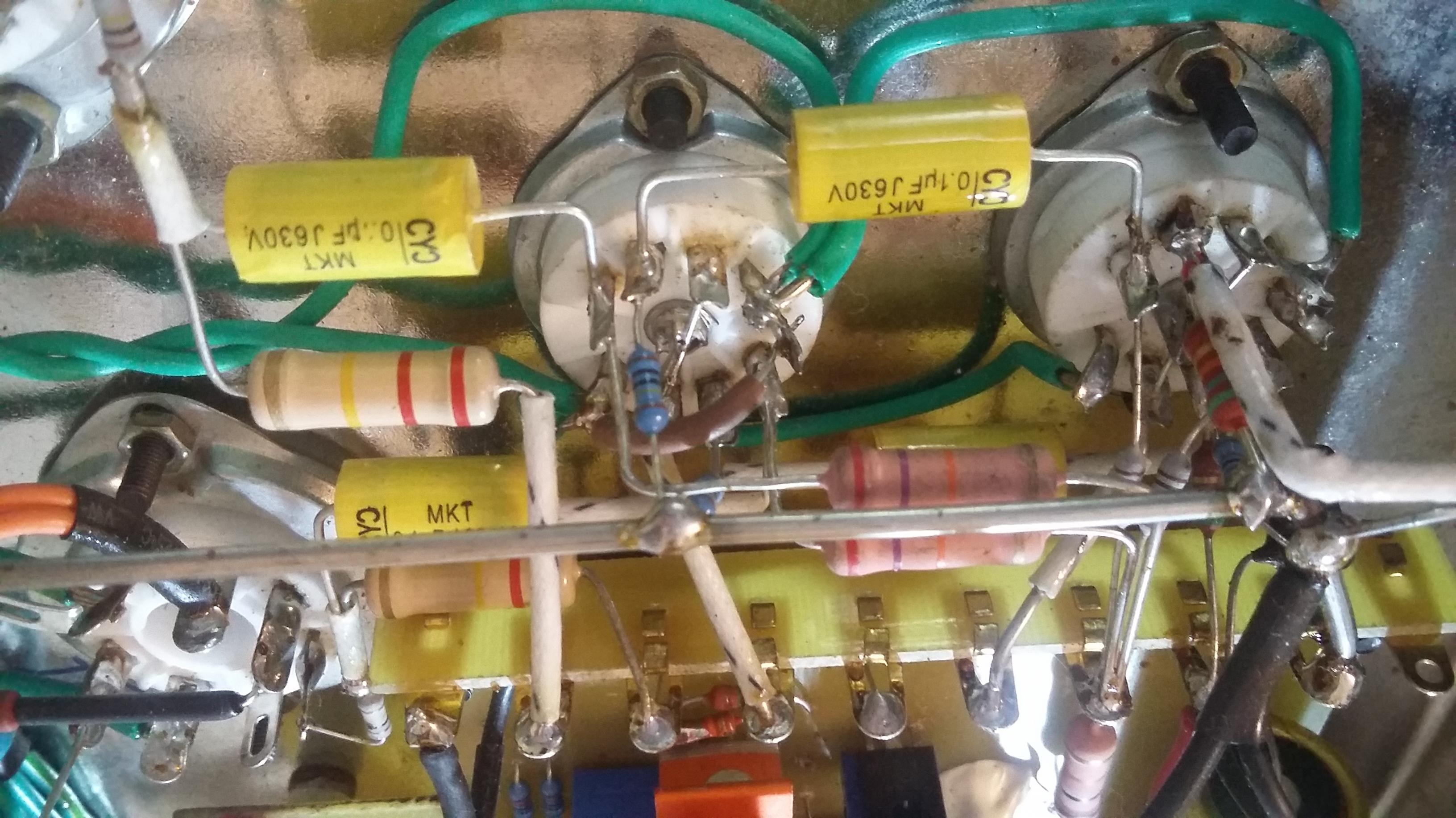

Hi there, I owed the photos of the chassis, here are some of the interior, and one during the measurement
