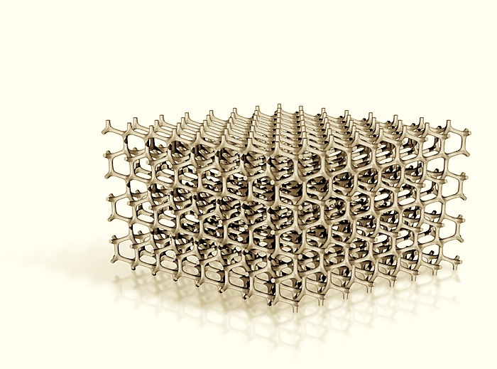

sorry, bad quip, the back-wave energy is contained within and damped by panel treatments so that the box does not turn into a distortion generator. You can conceivably make a very light but highly damped box out of carbon fiber with fractal lattice dampers.
I've spent quite some time thinking about this since i saw this thread. Now I want to make just such a box using a lattice made of Tinker-toys or something similar and the thinest material possible. I spent about three hours yesterday trying to figure out how to make a carbon fiber sphere... I figured it out but would need 3500$ in carbon fiber...😱
