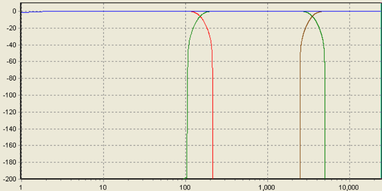

I asked myself the same question a little while ago and since I can easily do the test with my digital Xover (DEQX HDP-4) I did give it a try.
My system is 3 way active/tri-amplified and the drivers are SB Acoustics Satori MW16TX-4/TW29BN and SEAS L26ROY with a passive radiator: I would qualify it as a high-resolution system. The Xover selected frequencies are 150 Hz and 1,6 kHz, with a respectively 84 and 120 dB/octave linear phase filter. The DEQX provides 4 profiles for which you can store and configure parameters differently, so I set two profiles with exactly with the same parameters, except for the filter's attenuation. The "low" profile was set to a highish 48 dB/octave because it is the lowest value allowed by the DEQX for the mid/tweeter linear phase filter. I wished I could have done the test with a 12 or 24 dB filter and possibly the results would have been more determinant, but... hey, we can't have it all !! I can listen to each profile just by hitting a button on the remote control from my listening chair, which is perfect for an A/B comparaison. My observations:
  1. going that low for a tweeter (1,6 kHz) is normally kind of a risky busines: however, with a 48 dB/octave filter, it is already more than adequate and for sure, going with 120 dB/octave, that ensures you that your tweeter is totally protected and will not be modulated at all by lower frequencies that may introduce distorsion or unwanted excursion;
  2. since each individual driver is muted very rapidly outside the desired pass band, in theory, there is less room for interference to take place between the drivers (comb filtering) in the shared frequency band. Does this impact negatively on the directivity? I can't measure it, but according to my old ears, there was no obvious change, and anyway, my serious listening is always done in the sweet spot in the main axis of the speakers;
  3. measuring the frequency response at my listening position with a calibrated microphone did not reveal any "observable" difference on the curve; the measurement is rather dominated by the room response;
  4. listening test: purely SUBJECTIVE, so, please do not take this as the "truth"! Not night and day, you have to listen carefully and preferably use a high quality recording. Bass/medium: a bit better defined or cleaner: this correlate with theory that says there should be less additions/cancellations of the emitted waves in the shared frequency band; the vinyl and tube aficionados might find that they lose some warmth: personally, I prefer precision to warmth. Mid/highs: same thing, a bit better defined or cleaner, can be played very loud without challenging the mids and as a bonus, a little more precise location of the instruments in the soundstage.
I would be tempted to summarize all this with the word "precision", pushed one small step further. With my DEQX, the speakers are time/phase coherent, maybe this is a prerequisite to get something better from ultra-steep filters, I don't know. Anyway, in my case, I decided to keep those very non-standard parameters. "Smart or crazy", I'm tempted to say "smart"!

IME it's more about the width and the shape of the knee in the transition region (down to -20...-30dB) than the final filter slope that counts.
For example, a digital Neville-Thiele XO (as implemented in the Acourate software package) has infinite slopes but the transition region can be made as wide or narrow as you want.
Here an example of a NT with about 0.8 octaves -20dB transition width, compared with a 8th-order Linkwitz-Riley with about the same transition width and shape:
