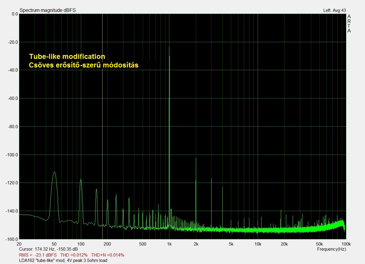

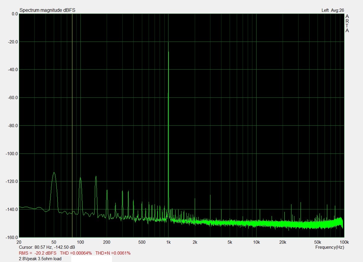

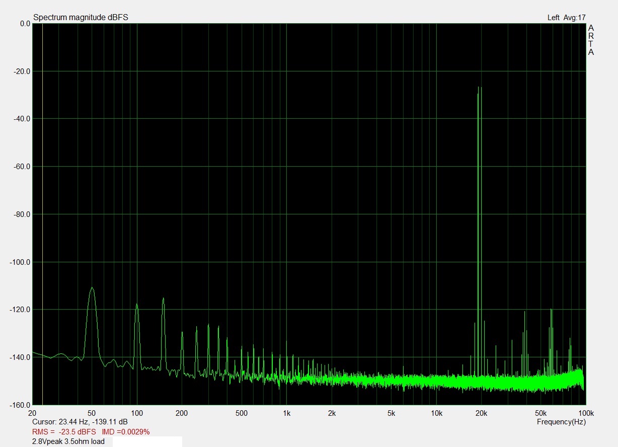

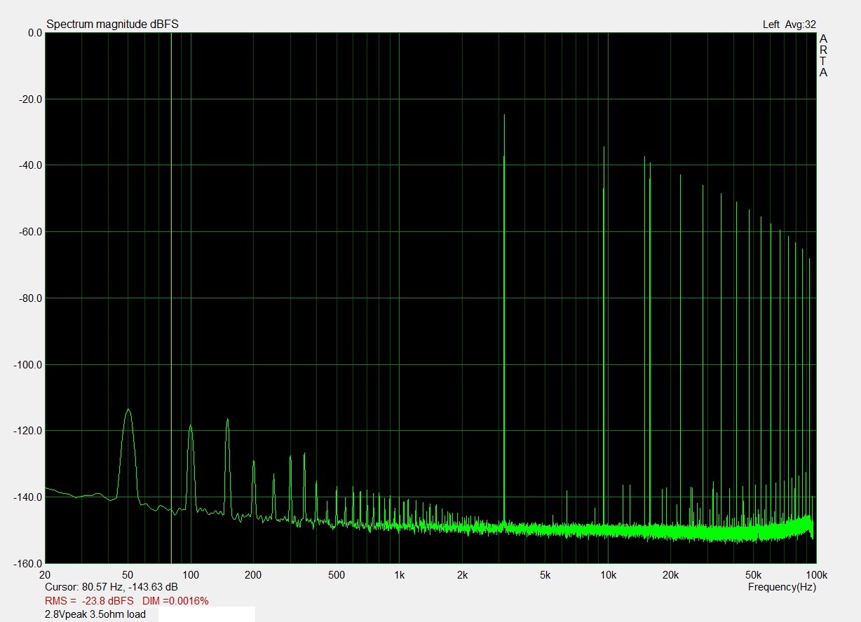

Some measurements done with ARTA. 2.8V peak output signal was chosen because the crossover distortion is significant in this voltage range (and normal listening volume with an average sensitivity speaker is also a few volts).
The ultra low distortion can be spoiled by changing two resistors, and so a distortion profile similar to that of tube amplifiers will result (see 4th attached image).
A nulltest has proved that this amplifier has no audible distortion. Nulltest difference file can be downloaded near the end of the following page: The LDA low distortion audio power amplifier project
