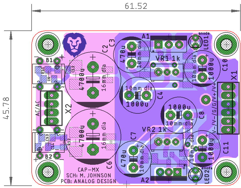

Have a look at post #626 from that thread;
https://www.diyaudio.com/community/threads/jumas-easy-peasy-capacitance-multiplier.297921/page-32
Schematic, Gerber zipped files are all there.

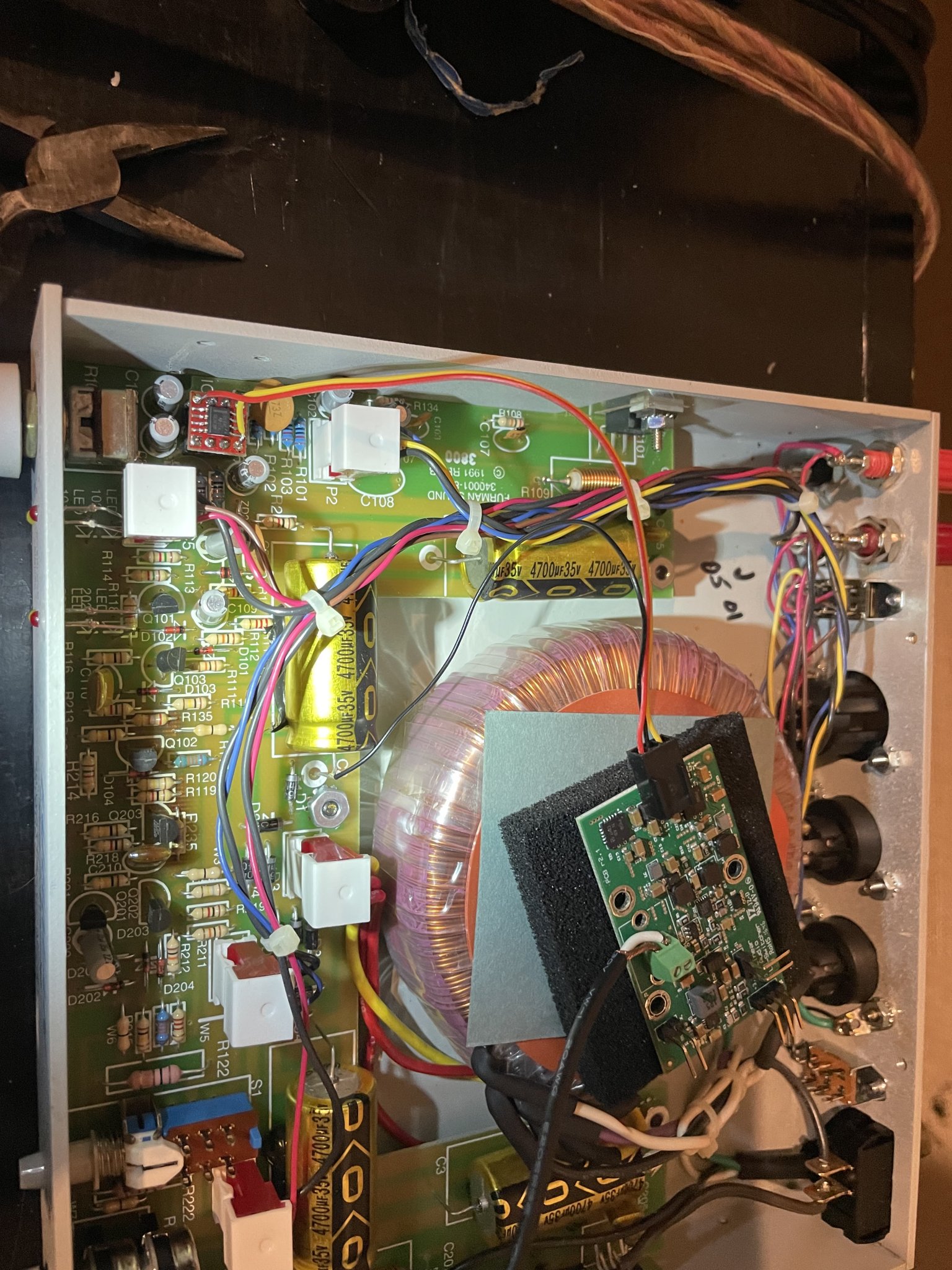

Happy to share my project!
It is an Lm1875 Gain clone amplifier with an opa1642 op amp in first stage acting as a differential amplifier for balanced inputs. As is, the OPA1642 gets +/-15 V from Zener diodes.
I hooked up a temporary test set up with a dedicated “silent switcher” feeding the opamp. It sounds better this way.
Since the “silence switcher” is no longer available, I would like to get a dedicated power supply for the opa1642. Or clean up the existing +/-15 V supply. I have a bunch of these Gain clone amps, so I need a repeatable solution.

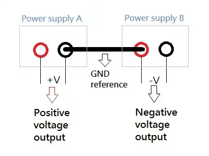

This power supply is needed only for powering the single opamp. Can I use two tiny SMPS bricks and float the Ground or will that create a ground reference problem? If I use two positive V bricks to get and positive/negative supply?
Why? You have symmetric voltages already there haven’t you? The point where the Zener diodes are connected to via series resistors. It is likely possible to change the Zener diodes to 18V ones and adapt the series resistors to that. Then you could use the LDO modules inputs to the +/-18V….

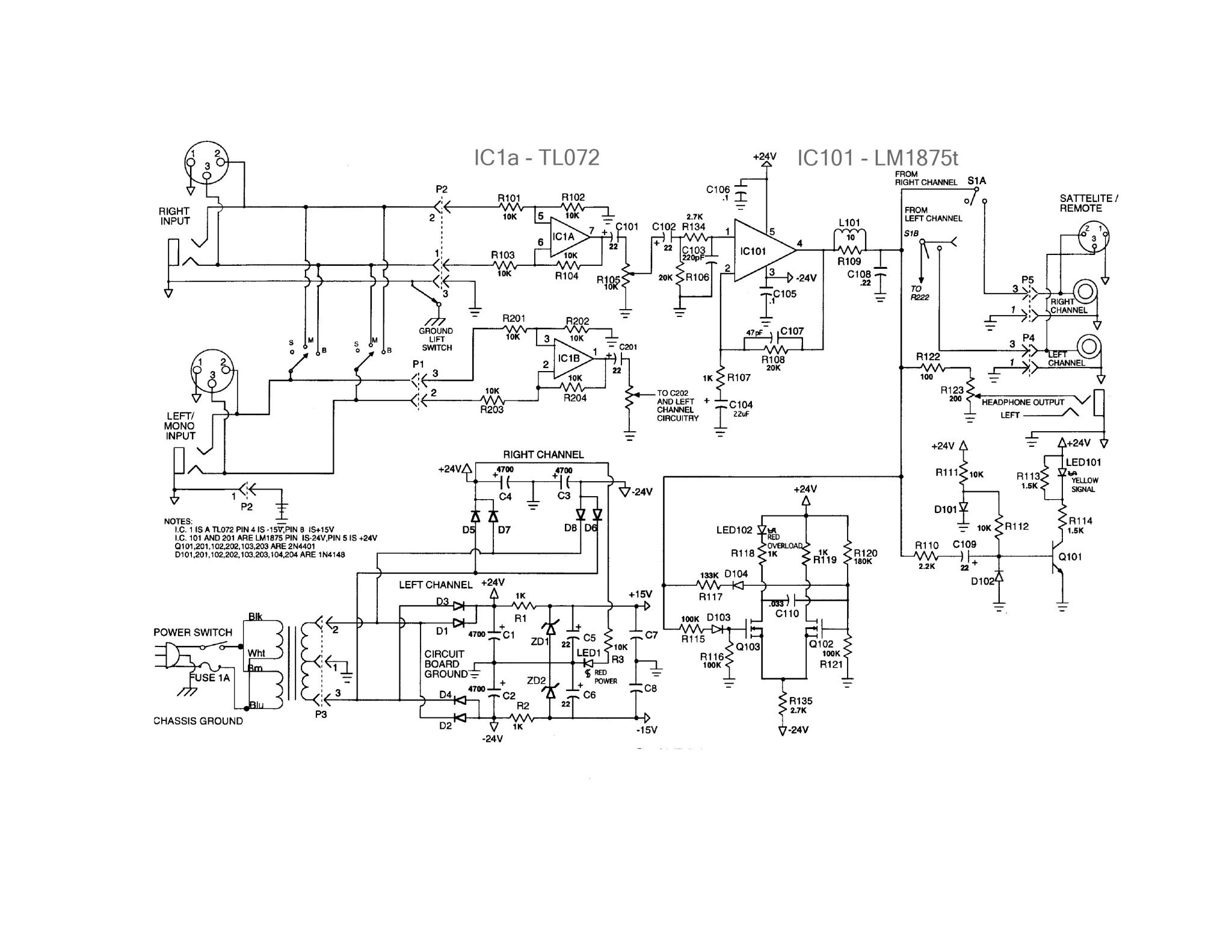

Jean-Paul,
the amp is Furman Model SP-20A.
I am looking for some explanations about the effects of power supply on the sound.
So far, I have experimented with only changing the PS to the opamp. Opamp only!
Factory standard: +-15v derived from +-24v with zeners and 1K resistor.
1st change: change TL072 to OPA1642: noticeable improvement in SQ. 3d space opened, sound more detailed but also smoother. like mp3 vs WAV sound.
2nd change: OPA1642 running off the +-15v rails, followed by LT3045/LT3094 type regulated down to 14.5v: Sound a little cleaner but less dynamic and less fun. Better but keep going.
3rd change: OPA1642 powered by SilentSwitcher. This is getting very good; much better than the 2 previous. Unfortunately, SilentSwitcher is unobtanium now. So no go.
The way forward is to understand why powering OPA1642 from amp rails (as in schematic) is inferior in sound to a dedicated power via SilentSwitcher. I feel this is very important for me to understand, to understand audio.
Please explain why this is happening, and what parameters of the PS are responsible for the sonic change. Voltage is same +-15v!

Hi I know the phenomenon and used regulated power supplies with equal results. Almost always better than simple Zener diodes and since I found that out at young age I never bothered to find out why exactly. You have +/-24V so you can use regulate power supplies by means of regulators that can have 24V at the inputs. Or you use 18V Zener diodes and feed modern LDOs but I think that is a tad too complex. The Silentswitcher has good linear regulators so it seems good clean rails are important to the end results. No news there 🙂 Probably how the opamps power pins are decoupled is also relevant (also usual) and results may vary and depend on which type and what value caps you use. Very good results here with OPA1642 when correctly decoupled.
Tip: I would replace C102, C202, C201 for 5 mm pitch Wima MKS 10 µF without blinking an eye. D1...D8 could be nice rightly chosen Schottky types.
