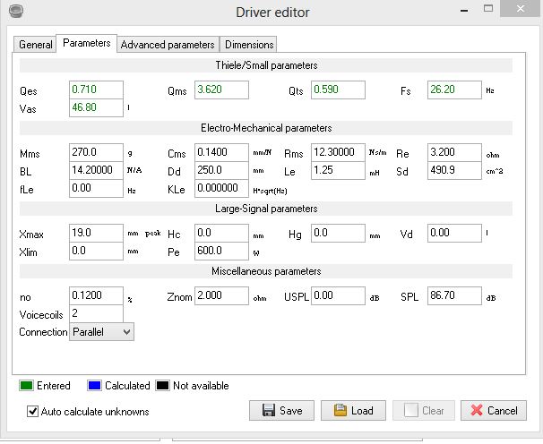

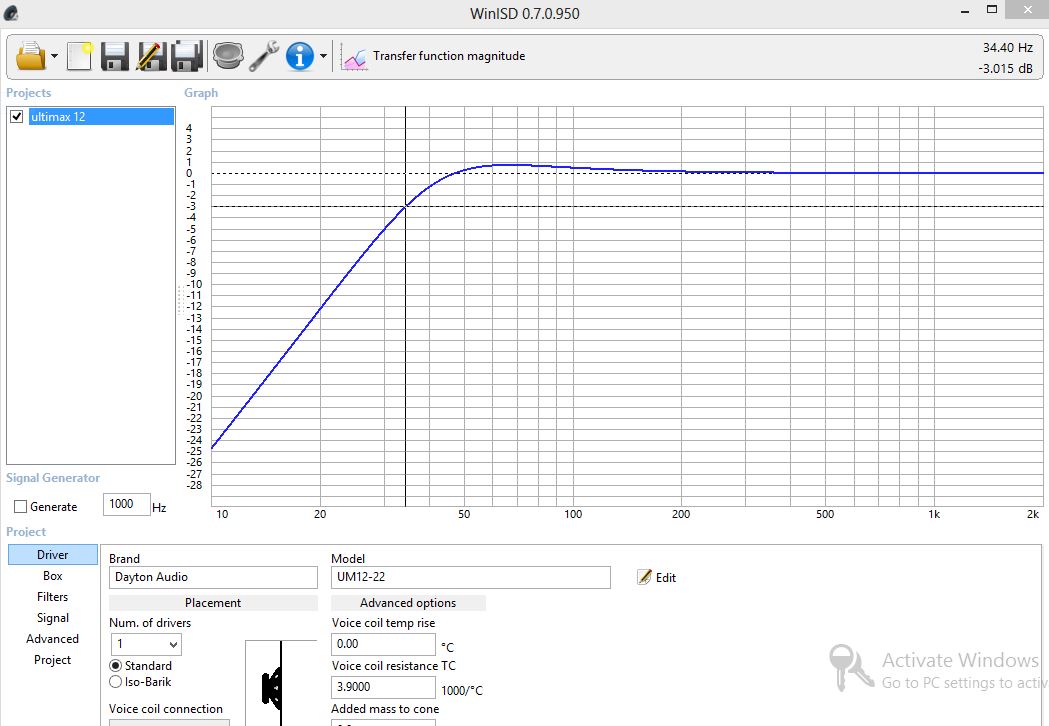

Am new student to WinIsd so fwiw, and correct me if needed!
look like f3=34.4Hz with no EQ.

From some calculations it looks to be your -3db is about 35-36hz. If you use a boost you can get that number lower/louder.
-3dB means the same as F3, right?
F10 would then be -10dB, correct?
As for your calculated 35-36hz, I did a minor calculation of 33hz, in either case - this must be pretty good for a sealed enclosure?
I find WinISD quite buggy, maybe it's my laptop, but sometimes the values and units won't stay, they change and cannot be changed, and vice versa, tried reinstalling several times, I'll have to give it another go someday.
I think however you should of put the 2 voice coils in series and not parallel?
How that affects the outcome you should ask someone else, though.

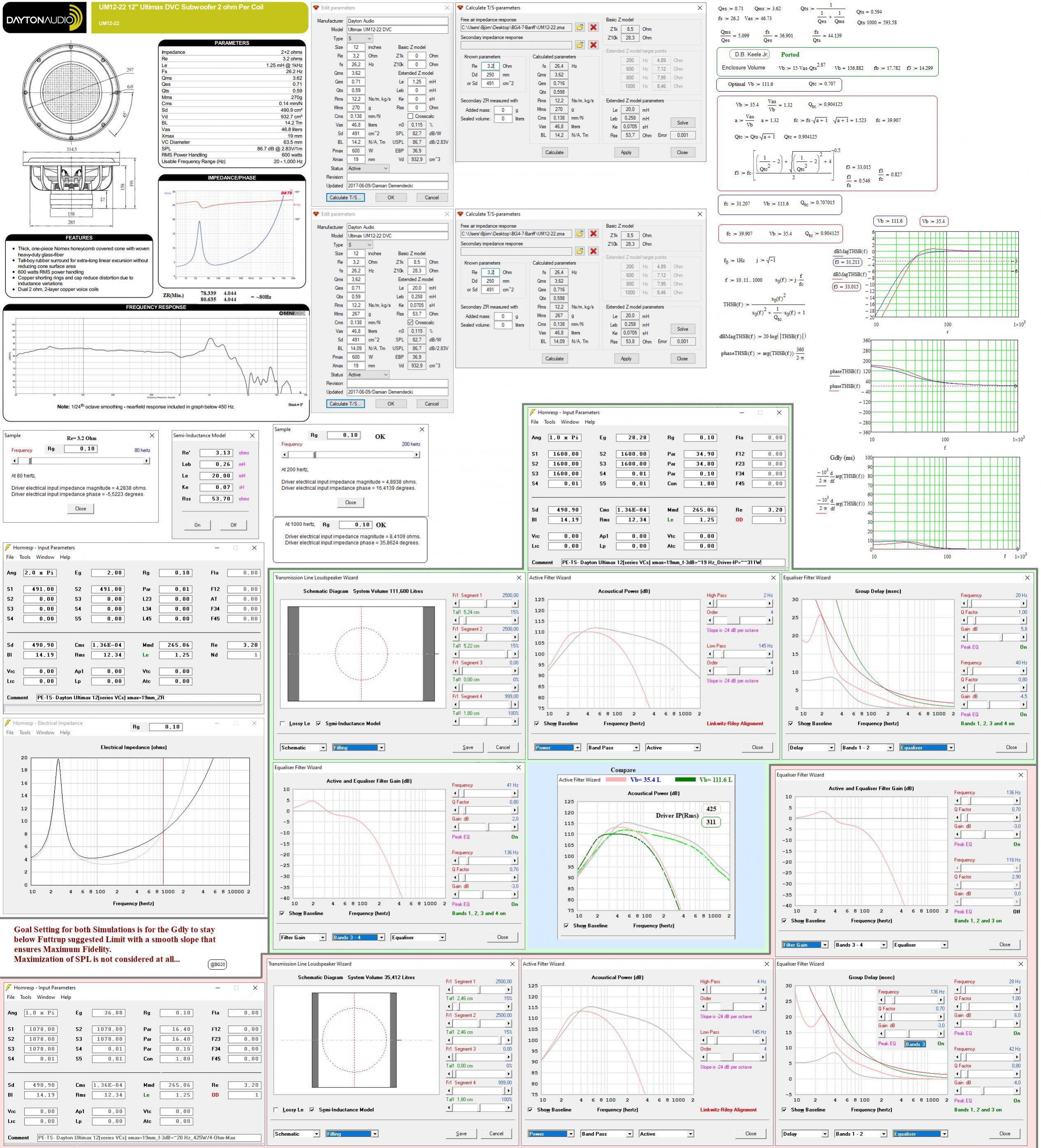

Looks like the optimal Vb get's you to 14hz, I don't even dare, my house won't take it, lol.

Vitus didn't say series or parallel.
bjorno is the master here, I need to get back school to to understand all those graphs, thanks.
Vitus what amp you use to drive and how loud?
Yeah, bjorno seems like the real guru here, I'm lucky he's in this thread, I understand like 10% of what he showed me back there, I'll be sure to save that screenshot for future reference.
