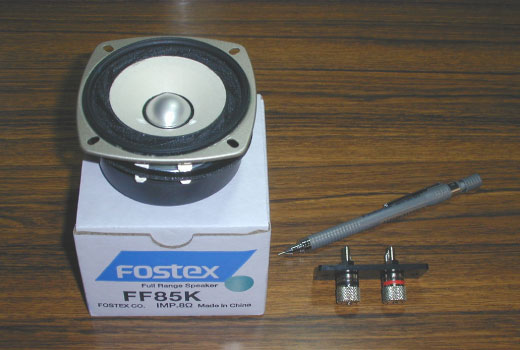

I'd put the Mark Audio Alpair 5 and Fostex FF85K into the category of quite decent cone tweeters.

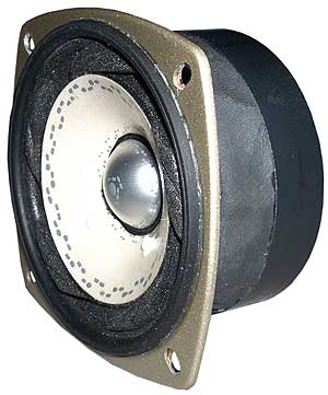

Thank you for this advice. The "Alpair 5" looks similar like the loudspeakers from Ted Jordan used e. g. by the "Essence" from Konus Audio (Sakura systems/47lab)I'd put the Mark Audio Alpair 5 and Fostex FF85K into the category of quite decent cone tweeters.

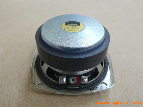

Fostex FF85K in Japan often to find
FE83E DoubleBassRef
CLAP aka HIS ???????D88?D85 ????????????? ?FF85K?8cm
Yes, the Alpair 5 is a slightly enhanced version of the Jordan J6T (your 2nd picture) that Mark Fenlon developed for Jordan when he was working with Ted.

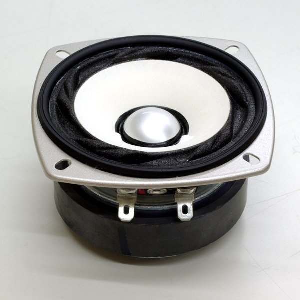

The last of your posted pictures are my modified FF85KeN. They are real stunners.

While very good it is still not up to the FF85. With the need to redesign the A5 to meet new EuroSpec (no ferrofluid), i have challenged him to make the next gen better, and even sent him a set of uFonken to use as a reference. I'm pretty sure he can do it. What he has learned from the A7 & A12 alone should do it.
