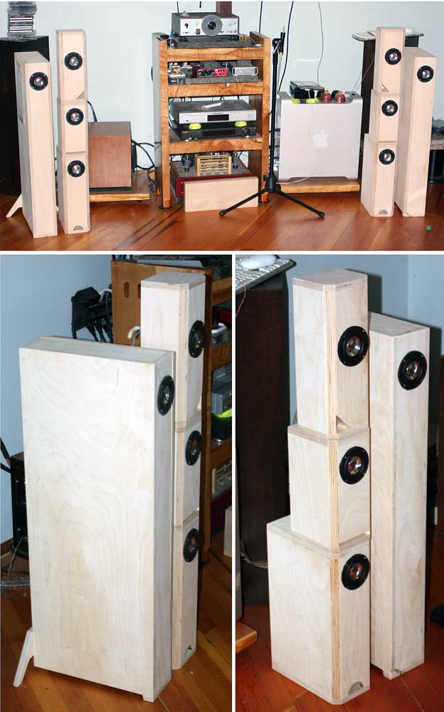

An almost complete HT setup, the only thing missing is the sub.
jeff
Neat little set of cabinets there Dave / Chris. 🙂
hey, had a couple of hours to spare last week while waiting for the spray booth
Anything that small won't be a horn specifically, it will be a quarter-wave/TL.
One of the designs is a mass-loaded "tapped" conical horn, but it is closer to a metre tall.
dave
880mm before floor clearance
baby-BIB?
The 2 triangular prisms backed up against the wall ... one with CDs, one with a keyboard on top...
2 more the same (except being cubes with the amp built-in) available, currently serving as a tall end table.
dave
baby-BIB?
Different alignment & design approach (although obviously they're not dissimilar). Actually, it was this that reminded me I hadn't done a QW box of this type for ages: 6moons audio reviews: Blumenhofer Fun 13

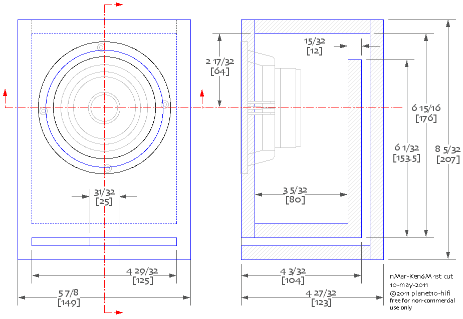

Yeah, that's one of the reasons I just posted that link as a possible suggestion. One of the coolest designs that I've seen is this one though: http://homepage.mac.com/tlinespeakers/FAL/downloads/VarKalEL-191111.pdf
and this one:
http://www.diyaudio.com/forums/atta...arkaaudio-ej-jordan-tang-bands-nmar-ken6m.gif
The second one makes me wonder what it would sound like.
Yeah, that's one of the reasons I just posted that link as a possible suggestion. One of the coolest designs that I've seen is this one though: Kal-EL70
and this one: nMar-Ken6m
Kal-El are the EL70 Mar-Kels for the euro-only CHP-70 (1st gen). A CGR Mar-Kel could easily be adated to look the same.
The nMar-Ken stretches the limits, and the vent is a bit impractical -- i've not heard if anyone has built them yet. At just a bit bigger the uMar-Ken6.2 has better bass and will house either metal or paper A6.2 with no other changes.
