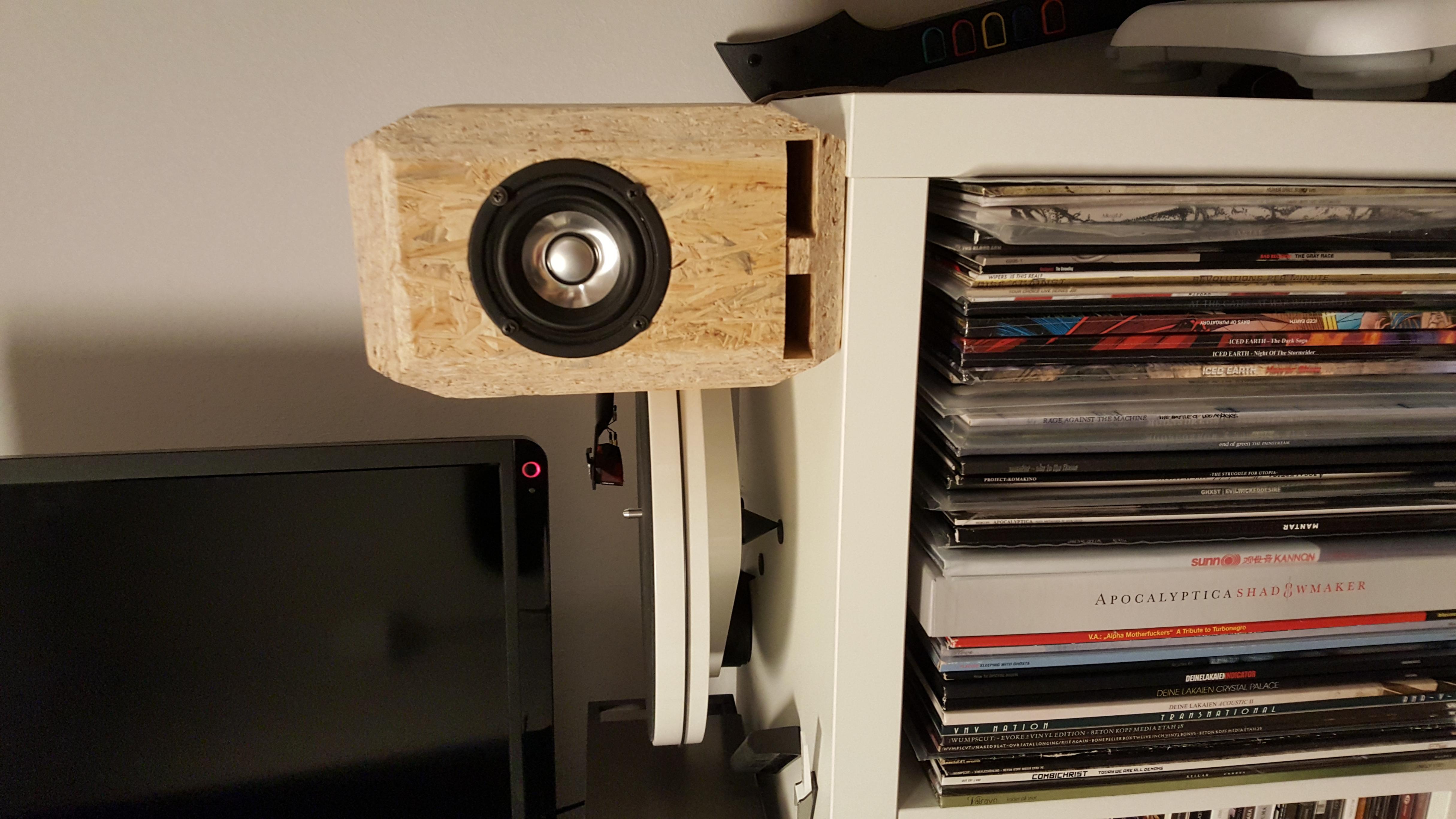

Update 🙂
I have a good feeling with the Founteks in the uFonken.
If these perform nearly as good as i hope they will,
i will built a second pair with additional Fountek 3.5h ribbons.
A bit higher enclosure but inside the same dimensions.
Some nice woofers are also waiting in a corner, probably a slim sidewoofer
enclosure as a stand for the small uFonkens... Will see how this ends :-D

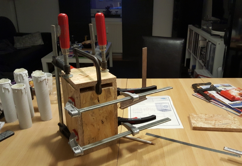

I hope your assembly photos mean the parts are only dry-fit together to confirm correct sizes: you absolutely need to chamfer or radius the rear side of speaker mounting hole with drivers of this size, and that's a lot easier to do before gluing the front panel in place - maximum of maybe 10 seconds each with a small laminate trim router and 45dg bit.
Hi Chris,
You are right with your statement and thanks for your tips 🙂
One sidepanel and the front is at the moment not glued with the other parts.
It's only easier with the clamping, that everything is in a correct angle and fit.
I hadn't the time to start the router for embedding the speakers in the front and the back chamfering.
If the experiment is working well i will do a rebuild with bb plywood.
This build with the OSB is only to see if it's worth to use the Fountek instead of the Fostex.

And here it is 🙂
Some instrumental rockmusic is now used for "breaking in" and tomorrow they get some heavy tunes at higher volume 😉
For today i'm really satisfied with the results.
These little fellows build up a great soundstage.
Of course they are limited in the lowend but i'm more or less amazed how good they are.
The upper frequency part is also limited so maybe i will make a tweeter extension.
For desktop use they are absolute great. Enough lowend and treble to keep them how they are. And what i have seen they can get reallly loud...!

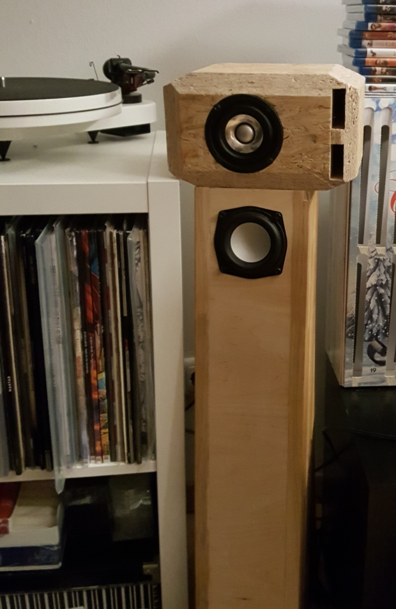

My fiancée complained about the Fonken+Subwoofer solution because the xmas-tree needs the space of the sub.
So i needed a practical solution for listening music in a good way while missing everything below ~100Hz.
In a box i found some nice xo components from other projects and started to calculate and simulate [BoxSim] and ended with an interesting solution.
The mentioned Aura FHLite are the midwoofers and the FE85-Fonkens are playing on top of them.
A simple 12db XO for the Auras and a resistor and cap in series with the FEs.
The output is not bad for having just my ears and no measurement tools lying around.
The FE85 really liked the higher XO-point and reward you with a very nice treble and larger soundstage. The Auras are now playing what they can best for 3"-woofers.
The xmas-days are safe from an annoyed female Grinch and the solution is more than well, that it can last longer till the next project is finished 🙂
