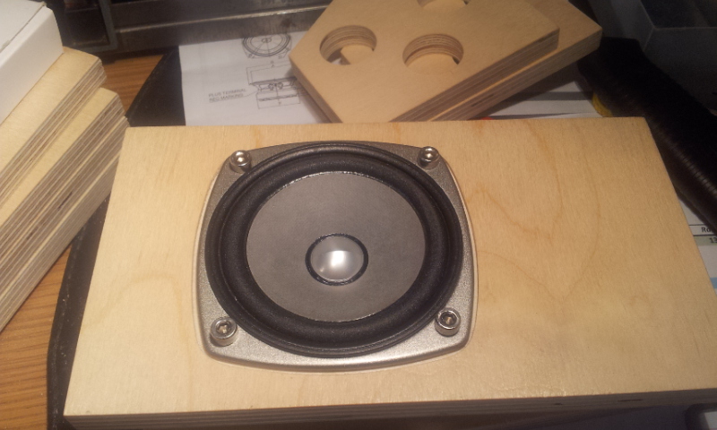

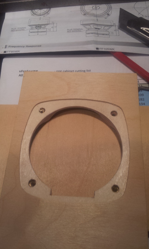

Last question (!) if I may: To recess the driver I'm making a routing template for a 1/4" router to make the 2mm recess and using captive nuts on the inside,
There are three distinct operations on the driver mount - the 71/73mm cutout, the 45 degree bevel and the 2mm recess to make the driver flush.
Is there a recommended or suggested order for these?
Thanks again
If using a circle jig, cut driver rebate first, then driver cut-out, then flip piece and cut bevel.
If you're not lucky enough to have access to a CNC, sippy's approach makes most sense.
Make sure to allow a slight tolerance for "loose fit" on the rebate - I use about .5mm diameter - too deadly tight a fit can make rotating driver for alignment with mounting screw holes, or removing the driver for whatever reason very difficult.
I really like the supplied screws - AFAIC they're as secure as any of the types of captive nuts I've encountered so far, particularly for smaller drivers with narrow flange margins. Follow Mark's recommendation of pre-drilling and"tapping" the screws before installing, and don't over-torque the mounting screws.

Thanks for the input - I'm rebating as much for aesthetic reasons as acoustic ones - am using allen cap-bolts for retention. The rebates and ports will be matt-black and the cases veneered using Decoflex in maple or walnut.
I don't have CNC so will make up some templates that sit tightly over the front panel to ease repeatability as I suspect that once the offspring see the results they too will want a set.

Little question - how deep a rebate to cut in the front panel for the driver?
I've tried 2mm but that just isn't enough to make it touch the brace...
What do you recommend - using a deeper rebate or some thin packing foam stuck to the brace (or driver)?
